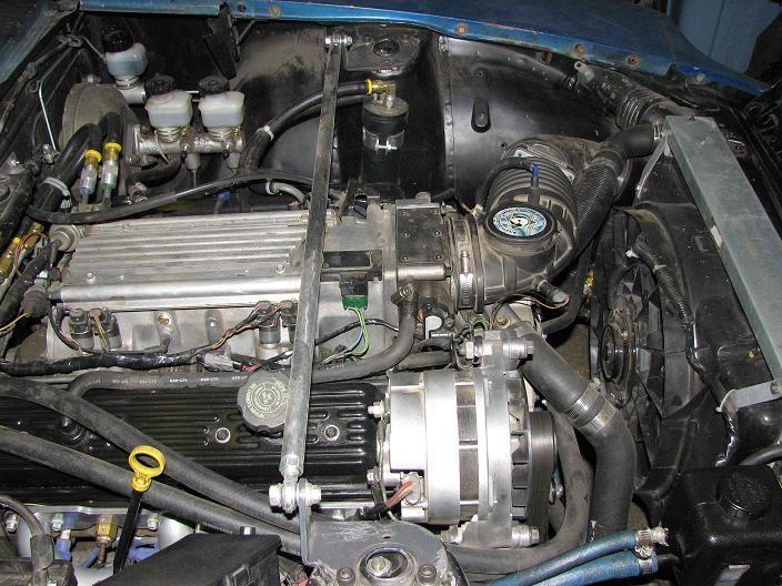

Here are a couple pictures from a few years ago, the car still looks essentially the same.
Here's a shot of the engine bay taken before I painted the the car black and grey.

Transmission is a GM World Class T5 from an 89 Trans Am.
Interior is mostly stock wit the exception of seats from an Acura Integra and 5 points harnesses and associated attachment bar. I even retained the stock tach and speedo with required adjustments so they read correctly.
Price is a tough one, the car has become part of the family so it'll be tough to let it go. I'd like to get $10k for it.
Here is a list of all the parts:
Iron headed 95 LT1, rebuilt with 11:1 pistons, 1.6:1 roller rockers, 2" intake, 1.6" exhaust valves, stock rods and crank, bored 30 over, LT4 hot cam, 3.5" Camaro MAF. Computer tune hand massaged by me.
16lbs flywheel from a 305, external balanced like the LT1.
Emissions stuff deleted.
PCM controlled fan from a ford Taurus.
R200 Diff, 3.56:1 gears, power brute clutch type LSD.
Custom CV joint axles (absolutely no binding through entire range of movement)
Large sway bars front and rear.
Ground Control coilovers with 250lbs spring front, 225lbs rear.
Koni Yellow single adjustable racing dampers
Sectioned strut tubes to allow lower stance without bottoming the suspension.
Power steering added, 1999 Subaru Forrester rack, stock GM pump.
Adjustable brake bias, stock balance valve removed.
Front and rear disk brakes, vented rotors front, solid rear, 4 piston front calipers from Toyota 4x4, rear calipers from a Nissan Maxima.
Front hubs from a 280Z.
All rust removed, new front frame rails added when power steering was installed. Front and rear "frame" sections tied together to stiffen the chassis.
Plastic fuel tank from a 2001 Camaro with in tank pump.
No radio, heater core works but the fan doesn't.
Steering column ignition switch failed so I bypassed it and installed power and starter switches in the center console.
I'm sure there's more but I can't remember all of it right now.
I'll see if I can find some videos and post them.
I last raced it in 2014 with a co-driver. Between the 2 of us we took FTD at all the events where the car wasn't broken.
The year prior I was able to set FTD a couple times myself.
The car is a blast to drive on the autocross track, although a bit brutal on the street due to the stiff chassis. The engine is a typical LT1 though, very civilized until you mash the loud pedal, then things get real interesting real quick.
Edit: Forgot to mention the suspension control arms, they're from Techno Toy Tuning, are fully adjustable and have rod ends rather than bushings. Made it possible to add some toe in on the rear which REALLY helps it plant and go, also got rid of that vague "alright whats it gonna do now feeling" I'm sure the C3 rear suffers from. With the current alignment its a mostly neutral car with a little bias toward loose which is how I like it. I hate a car that under steers.
