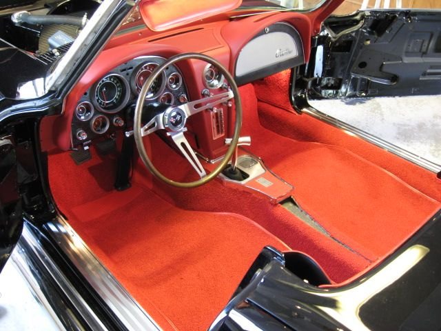

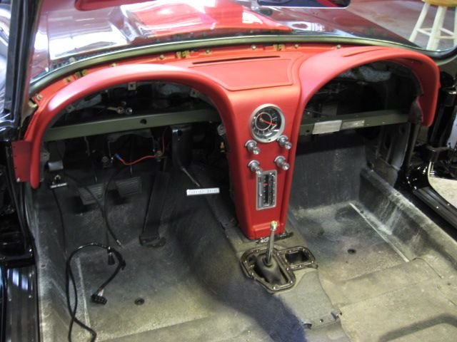

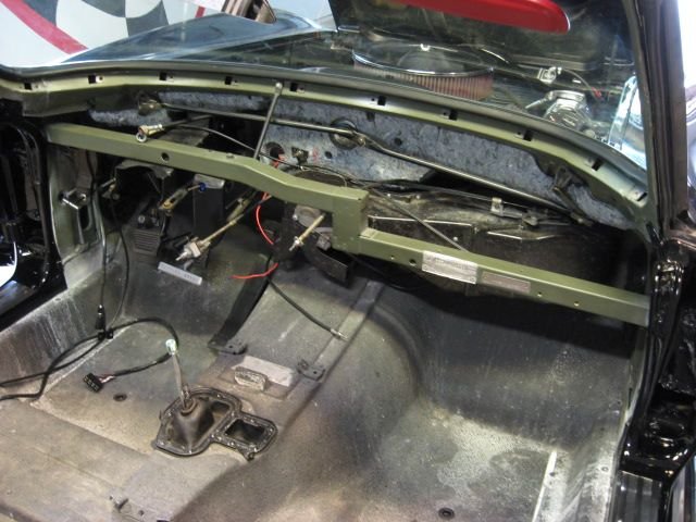

Inside of the car coated with black "LizardSkin" - new stock firewall insulation can be seen prior to dash installation:
One of the nice things about the LizardSkin is that its much thinner than the thick insulating pads, which allows the carpeting to be installed very easily without any fitment problems due to thick insulation:
