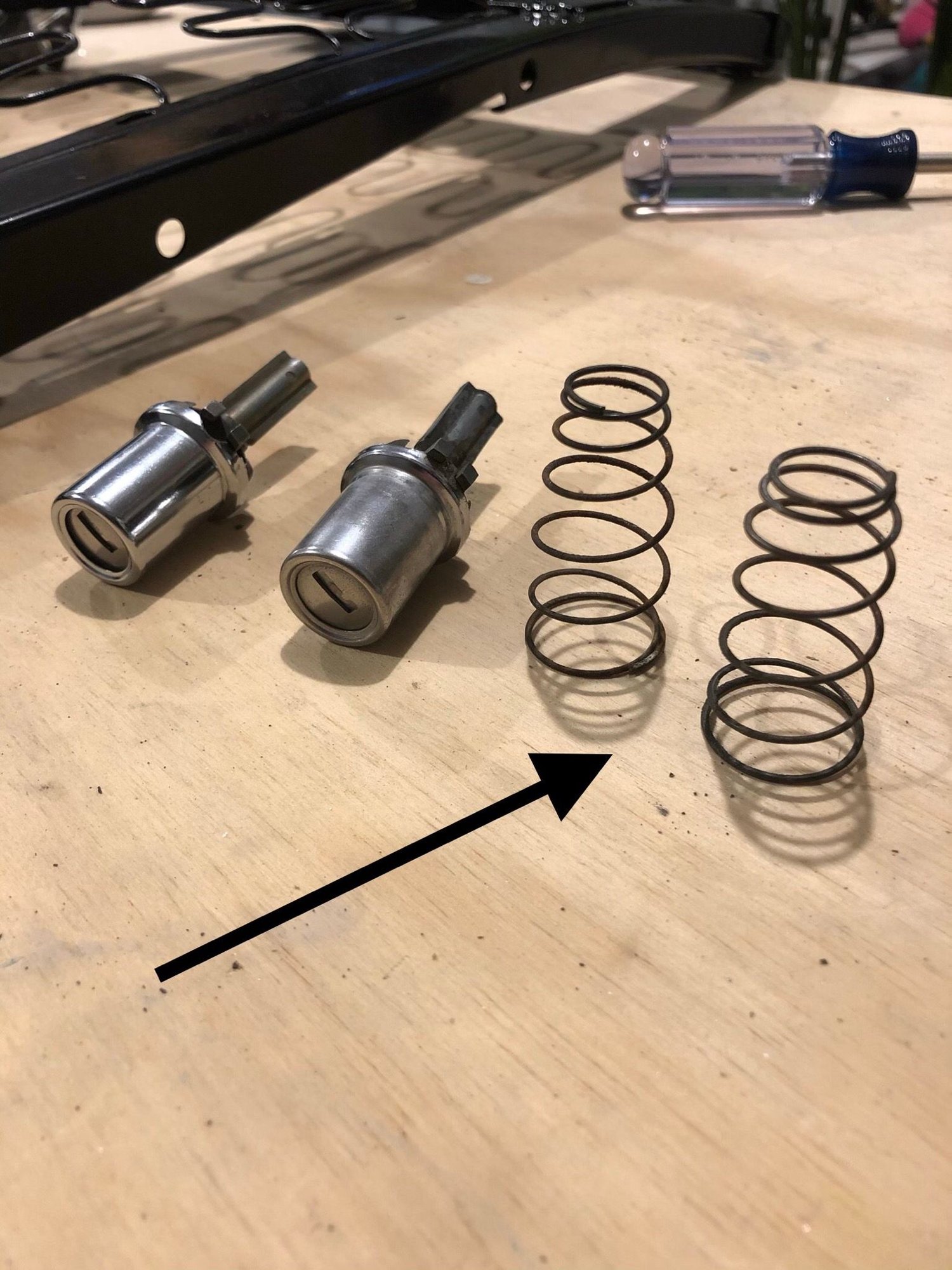

Posts: 30
Likes: 7
Default Housing springs
Anyone know where I can source replacement housing springs?

Rescue Rogers's Avatar
Rescue Rogers
Is my vette stock?? HAHA
Joined: Oct 2015
Posts: 20,209
Likes: 9,347
2016 C3 of Year Finalist
They arent reproduced so it will need to be used. Try calling Willcox, Keen Parts and George from th forum. I believe hes 1960FI here
