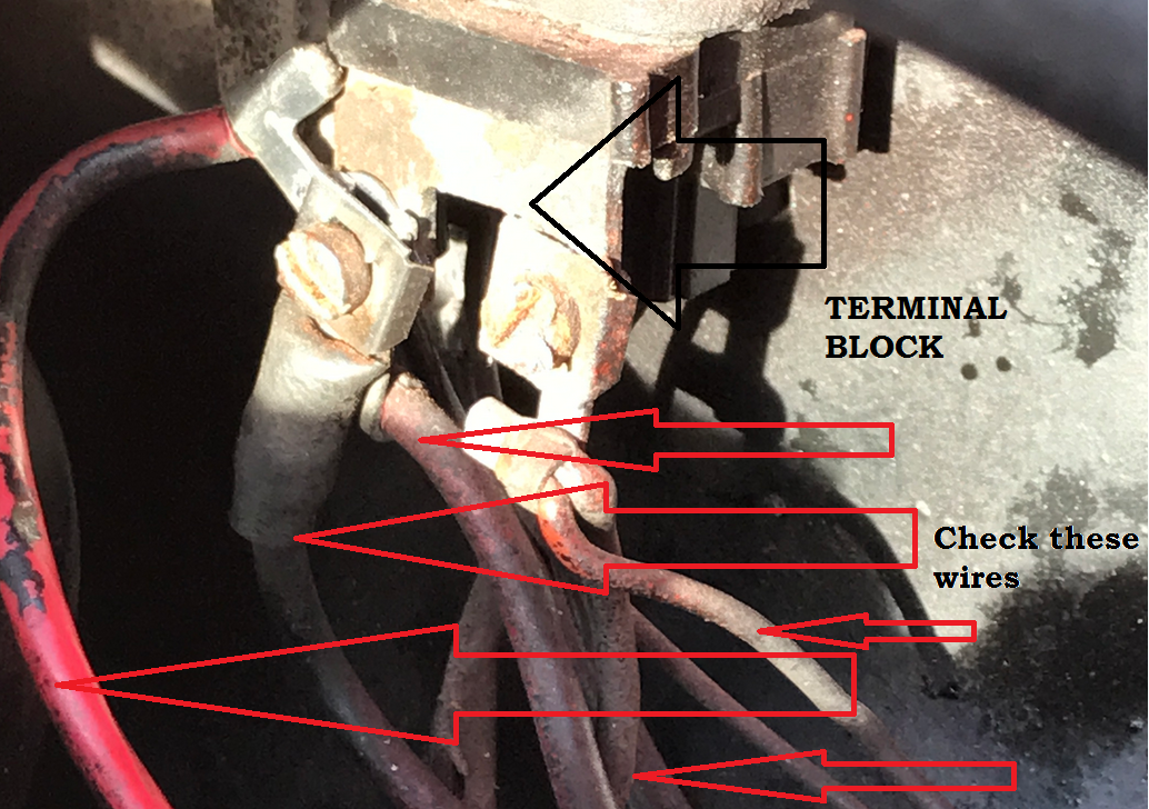

Originally Posted by MikesRed68
Richard ok...I see that. I did forget to mention that we took off the 3 pin connector wires pink/black-black-green, and it still clicks when we touch the negative battery cable to the post and we put those wires back and took off the wires from the other end and touched the neg battery cable to the post and also clicks. Is this supposed to do that? And if not what has to be done or looked at to correct this bad *** big current draw battery drain problem. Do u think i need a whole new wiring harness ? Do u want to see any pictures of anything??
NO- if it clicks - the relay is engaged- that means you have a internally shorted/bad horn relay. That will pull a couple amp and wipe out your battery.
I'd replace the horn relay AND make sure there is NO continuity to a ground with the 4/5 hot wires connected to the Horn relay terminal block.
Otherwise you will torch your new horn relay.
Gerry u said Alan posted a pic of the horns ? Ive looked 5 x and cant find that post #.
I posted a pic of them-
https://www.corvetteforum.com/forums...post1594608407
If you take the green wire at the horn relay( as it runs from the horn relay right to the horn) and connect it to a +12 source- the horn will honk- if the horn and wiring are good.
What the horn relay does (besides being a key buzzer and a +12volt terminal block) is take the black wire that runs through the steering column from the horn button -it grounds when you press the horn- to a switch AKA relay that gives the horn(s) +12 volts to make them sound.
Richard
Richard i DID replace the horn relay about a month ago. In one of my first posts i was saying that the horn relay was BUZZING ..That is why i replaced it. I AM SO FKN CONFUZED !!!!!!!!!!
Just because you replaced it- doesn't mean it will fix it... Plus- the buzzing noise might have just been normal operation of the key in the ignition and the door open...
The click is an obvious clue the relay is being energized. Power is going through the coil of wire inside the Horn Relay- creating a magnetic effect and the contacts close ( in some cases open). WHENEVER a coil is energized it is USING power- or in your case draining power as it is always staying on.
The burnt wire tells me there might still be something wrong with your wiring- causing the relay to stay on, got torched when your replaced it w/o checking any further OR the new relay could have been bad to start with ( ENTIRELY possible these days)- I don't know.
You have to methodically check each wire out at the horn relay- look for places it could have melted to another wire - or as others ( and I) have stated, replace the harness.
