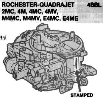

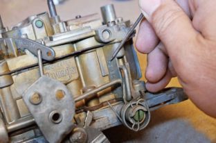

NOW....I think this is not the correct carb due to I ahve never seen a Corvette of your year model with that other pull off on the right side rear of the carb.
Can you post the carburetor number???
Below are images on where to look for the carb number and they might be lightly stamped in the main body so take your time when you are looking at it.
I can say that I now need to see the heat riser or at least the exhaust on the right side...especially where the exhaust pipe attaches to the exhaust manifold. It may be possible that IF you still have a heat riser..it may be able to be controlled with a cable....OR....
Possibly take off the choke on that carb and install an electric one.
I know why it takes so long for the choke to finally pull off and you have an idle... and that is because I can see that you do not have either two of the temperature vacuum switches in your intake/thermostat housing. One of them if for your EFE system..which is what allows this type of choke design to function. Which is why I really need to see what you have going on a the exhaust on the right side.
