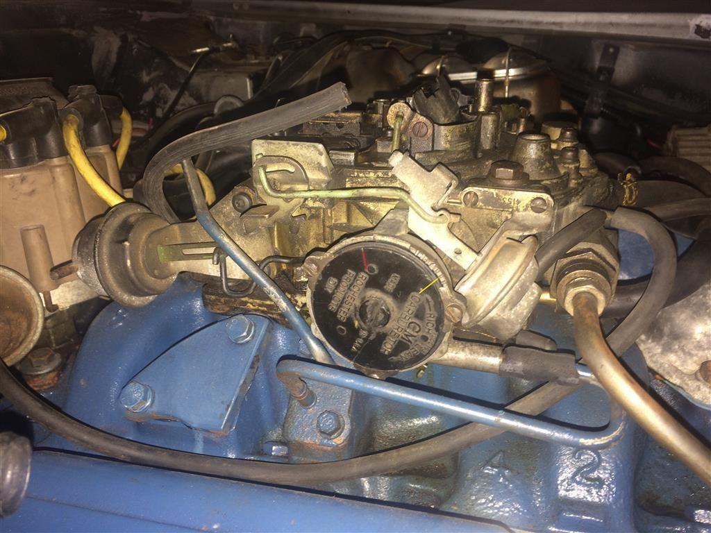

For what it is worth, I have headers on my 75 and no heat riser. My choke is the same setup as you have and it works perfectly fine. On a 60 degree morning after a cold start I am on the road in 5 to 7 minutes. Once you get your choke working right you may have other problems with the mix and match unit you are running. I would suggest asking Lars for a Qjet summary of jet and metering sizes and make sure you have the right parts for the carb you have and not the year car. A good setup and the right APT setting does a world of good in these old Qjets.

Originally Posted by Norcoastal
If it's running rich, is it as simple as turning that dial towards "lean"?
It is NOT as simple as that.
What is the carb number??
Knowing what you have can help. And the reason I am asking is that just because the number is not what the car came with does NOT mean that that carb can be built correctly to work on this engine.
In the photo you posted that is below...the two tubes you see that are made into a plate that is bolted to the intake is where the heat from your exhaust is being directed to your choke housing. That area...if you had a heat riser...would heat up quickly and allow the choke to pull off. You can crank your engine and see either by an infrared temperate gun or carefully touching it to see how long it takes to get hot.
And are you 100% positive that the heat riser spacer has no shaft in it that would thus let you know that you have a flapper in it??? The heat riser for your engine is not like that of earlier Corvettes where you can see that big square weight coming out from the side.
you heat riser would look like this:
And the rich smell of fuel can be attributed to ignition/timing issues and not always the carb. You might be having a weak spark on a few cylinders which can also be a cause for it running a bit rough at idle.

Hi DUB,
It's hard to see the number with all of the grime, but what I see is 17084502.
There is absolutely no riser. I just replaced the entire exhaust system last weekend and it's just a spacer.
On the drivers side, there is a small metal hose coming off of the air cleaner that went to the heat stove which isn't there. Not sure if that contributes to the choke performance or not.
Does this help?
Would a weak spark be due to the distributor? It seems as if the PO did all the right things with the major items (short block, heads, brake lines etc) but may have skimped on the bolt on's like the carb and the distributor.

Originally Posted by DUB
'Norcoasatal'
Thanks for all for the GOOD photos. They were a really good help. And also THANKS to 'bmotojoe' for posting a photo of where to push down to get your choke to go off and idle.
NOW....I think this is not the correct carb due to I ahve never seen a Corvette of your year model with that other pull off on the right side rear of the carb.
Can you post the carburetor number???
Below are images on where to look for the carb number and they might be lightly stamped in the main body so take your time when you are looking at it.
I can say that I now need to see the heat riser or at least the exhaust on the right side...especially where the exhaust pipe attaches to the exhaust manifold. It may be possible that IF you still have a heat riser..it may be able to be controlled with a cable....OR....
Possibly take off the choke on that carb and install an electric one.
I know why it takes so long for the choke to finally pull off and you have an idle... and that is because I can see that you do not have either two of the temperature vacuum switches in your intake/thermostat housing. One of them if for your EFE system..which is what allows this type of choke design to function. Which is why I really need to see what you have going on a the exhaust on the right side.

I've got a 79 L48 auto carb sitting on the bench without the rear pulloff, but my 75 carb has it. Not sure which had it or why.

The carb is a 1984 heavy duty truck carb. The trucks used the rear pulloff, but it can be removed if the front pulloff is used. Just like the '75 Vette carb. I can see that the choke is out of adjustment. It should be aligned 2 notches clockwise from the center mark on the housing, and yours is rotated almost 45 degrees from the correct position. This will cause the choke to stay on way too long with fast idle not wanting to come down. Adjust your choke to the correct setting and verify your pulloff operation to make it work correctly.
Lars
This is very helpful, but can you be a little more specific? What center mark? And will I be able to use this carb as is?
Loosen the three screws on the choke housing. Your current position of the choke (Line In Red) should be moved to the second mark to the right of the center-line of the choke housing (Line In Yellow). Just rotate the plastic part of the choke to align the two marks. Tighten the three screws.
That's terrific thank you. This was very loose. I guess that's why it could have moved. The idle seems to have calmed down and sounds terrific!
Thank You!!!!!
Will this carb be ok for this car? When I step on the gas there seems to be a hesitation but that could be timing I assume.

Lars
Why no professionally rebuilt carb?
Where would be the best place to get one?
