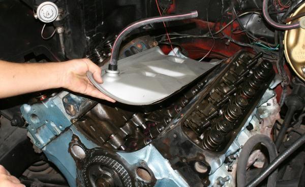

I remember seeing Mopars that had their PCV in the lifter valley cover under their intake manifold. You DO remember lifter valley covers, don't you? For a long time only Chevrolet had intake manifolds that sealed the lifter valley and thus eliminated an additional part and an additional gasket. A brilliant idea in the mid 1950's.
Pontiac V/8's in 60's and 70's also had valley covers with the PCV stuck in them.
I was a Pontiac guy back in the day and you are correct on the valley pan, but the PVC was in the passenger valve cover.

You are wrong. GM was putting Olds 403 engines in the late 70's Pontiac Trans Am's. The Olds motors had the PCV in the passenger side valve cover.
