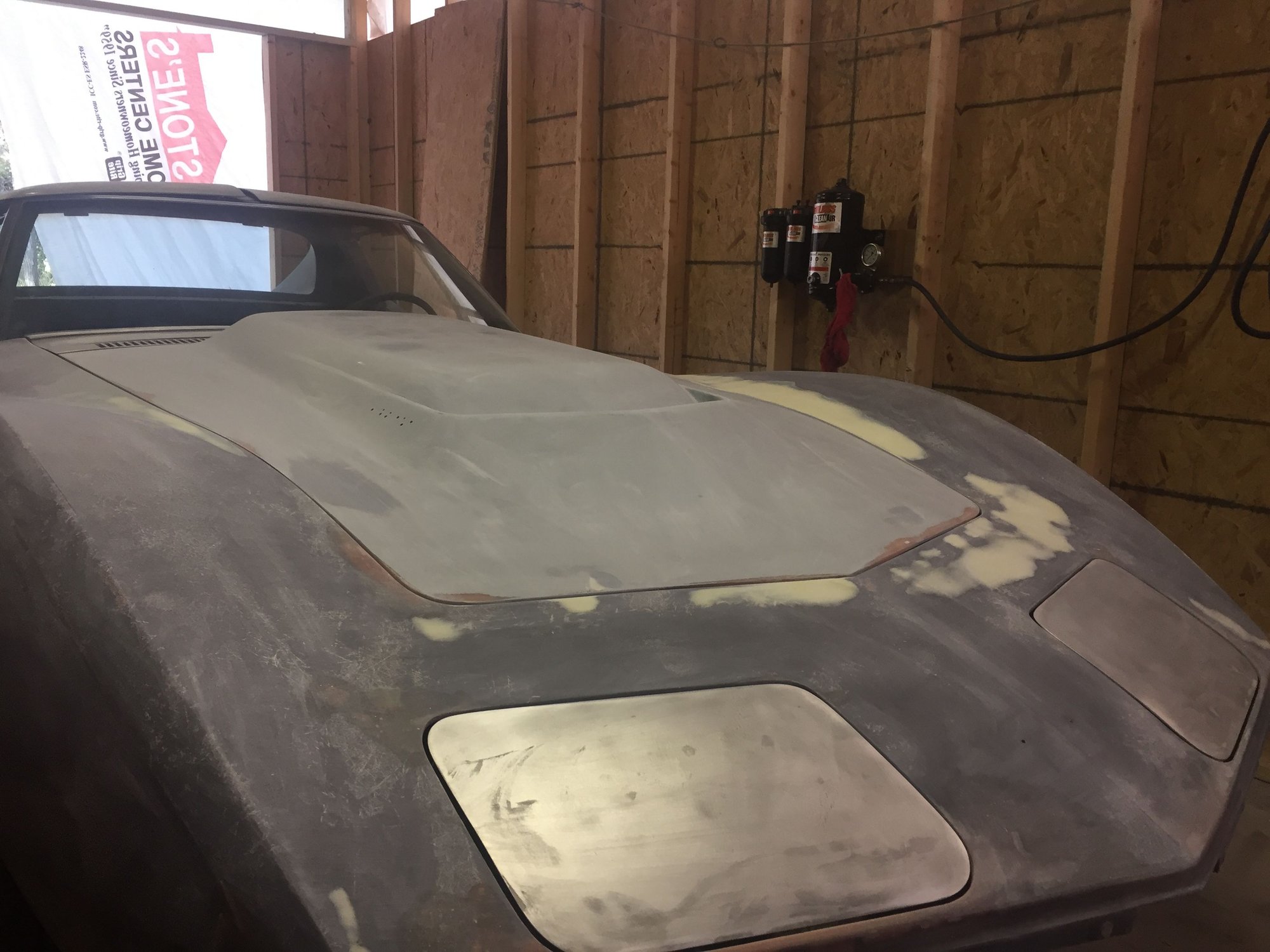

I've been doing this frame off restoration for 5 years now. I'm about at the point of paint. My hope ( if the weather holds up) is to at least seal this car before winter. Spring / summer of 2018 I'm gonna paint this beast Monaco orange. I've been looking at southern polyurethane to use as sealer. Now I'm not married to this decision at all. I'm asking you what you think I should use all the way through to paint. Sub questions include do I need to use something different one the aluminum headlights, grills and window washer cover than I use on the glass ? I would greatly appreciate your advice on what to buy and what to use to get to Monaco orange. I just bought the devilbiss

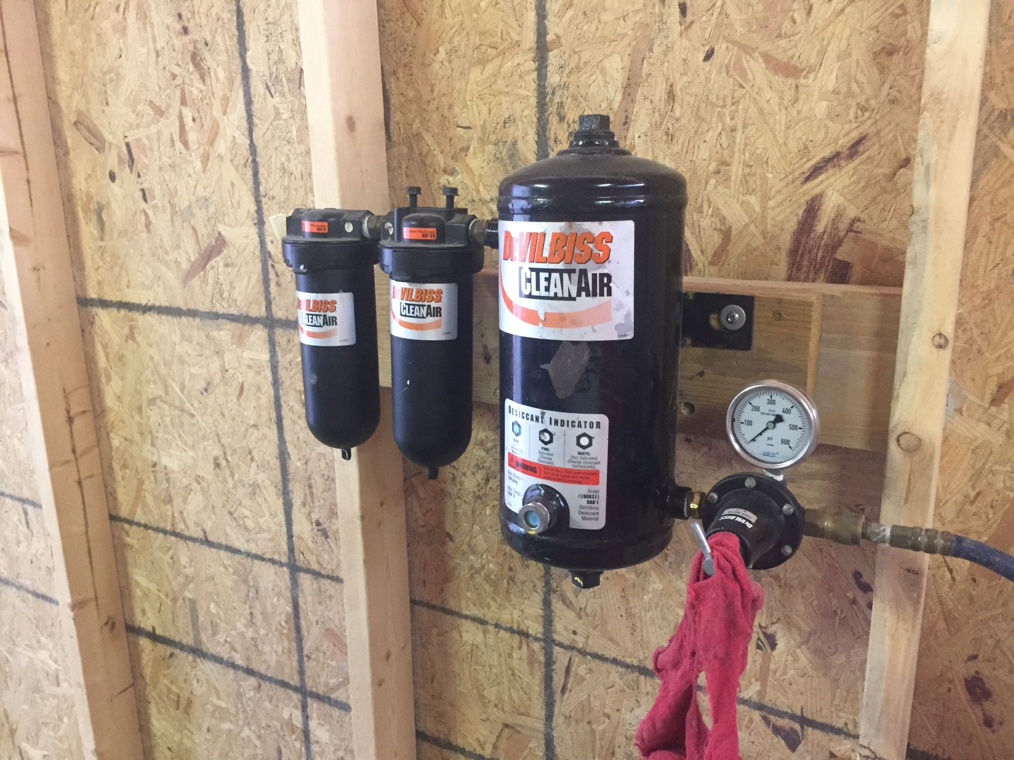

starting line hvlp guns. It includes a gun and a detail gun. My wife's uncle gave me a devilbiss clean air system. I purchased new dssacant and will be purchasing a new compressor in about two weeks. I've painted many many things over the years with excellent results using rattle cans. This will be my first attempt with a hvlp gun. Trust me I have extreme faith in my abilities. I really need advice on paint materials to use. I'm not one in life to usually ask anyone for help, in fact I'm usually the one to give it. With that said can you advise me with what to buy from sealer to color. Thank you for your encouragement , Jef. I'm

Now you and others can do as you wish and use what you want so I do not get a backlash on from those members how feel I am pushing stuff down people throats.
But....you asked so here it goes. If this was a project that I had to do...
The aluminum/stainless steel parts DO get a different product applied to them than what the body gets. The stainless steel trim molding parts for the wiper door and the 'eyebrows' trim for the top hood surround get media blasted and then a special primer that bonds to stainless is used.
As for the raw body...after all my bodywork has been completed....I gelcoat the body. This is due to the fact that your car is the press molded polyester fiberglass and that is what I use.
IF and that is a big IF.....If I could not get gelcoat.....then my next choice would be a polyester primer.
I have not used the SPI products...so I can not confirm or dispute their value in this area. I know 'porchdog' uses it quite a lot and if you want to contact him...obviously feel free to do so.
If you need more detailed info from me...respond accordingly.

I would go to a few body shop suppliers in you're area and talk to them ,than decide which product line to use. After making a choice on a product line use there primer to clear ,every area has a choice or more popular line of paint.My Daughters body shop uses one kind of paint product that's what the body and painter feels is the best ,and they do great work.

FIRST, I am not shilling for SPI.
I was in your position and started researching what to put onto a bare body. I had no experience with a spray gun. I ruled out gel coat because it seemed to require more skill than I possessed and there seemed MANY ways to get into trouble.
I finally settled on SPI epoxy as the first thing I sprayed because of the large number of recommendations it received on the Forum. I was also influenced by Forum member Porchdog over in the GENERAL TOPIC/PAINT AND BODY section. To date, I am not unhappy with my selection.
