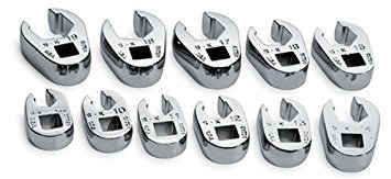

crowfoot line-wrench with extension will do the job.
Yes, if you just need to tighten you can do it with a crows foot. If you needed to get it started it's possible to do it (I've done it once) but every time after that I REMEMBERED to put the lines on BEFORE the trans is fully in place.
100%.and I will also use a universal on the crowfoot for added flexibility.
