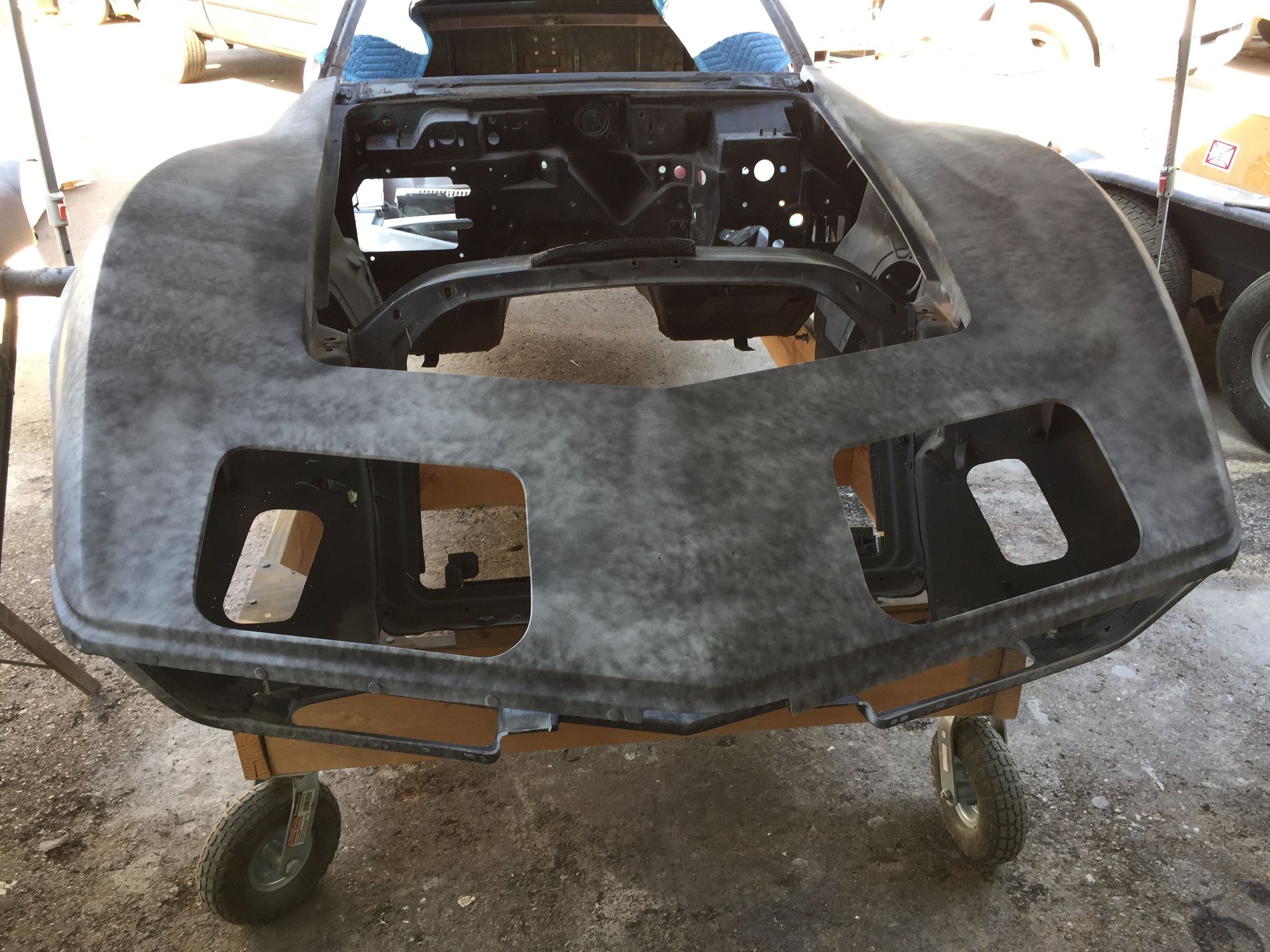

My 69 body is getting closer to paint.
We keep going back and forth over which to paint first, the outside body, which will be white, or the engine bay and bottom, which will be black. The key is masking and overspray, especially in the headlight area.
Thoughts?

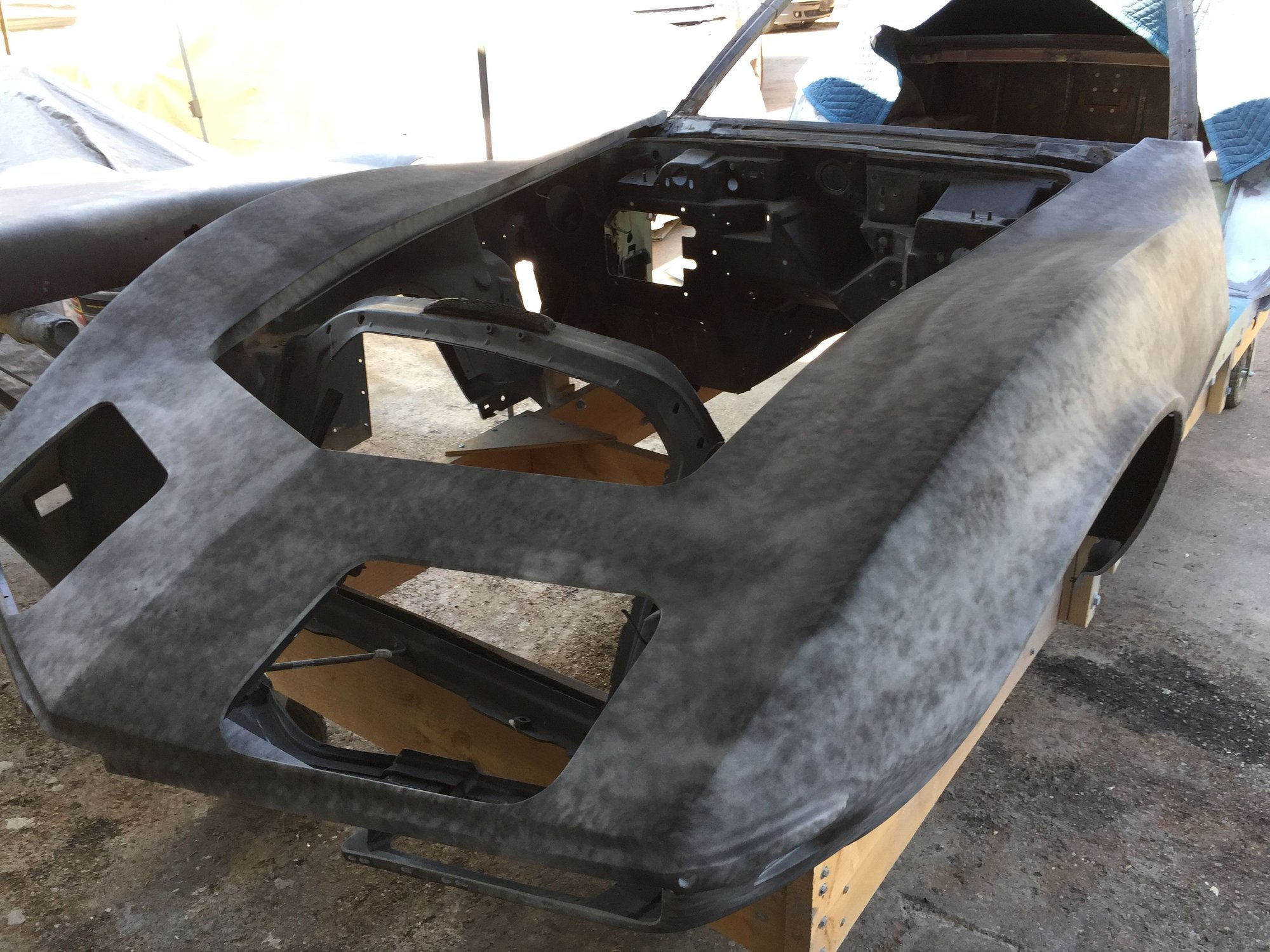

I should have stated that the car body is off the car on an "Alan type" dolly and will be painted on the dolly. Everything is off of it.
The big areas of concern was the nose headlight holes. Lots of holes. Richard, my body and paint guy, said on the one hand, he could color sand any overspray off the body color, but some places (like the lights area) might be tough touching up.
Richard is a perfectionist and just had a car displayed at SEMA.
That said, this is not a restoration so I am not going for originality, ie factory overspray

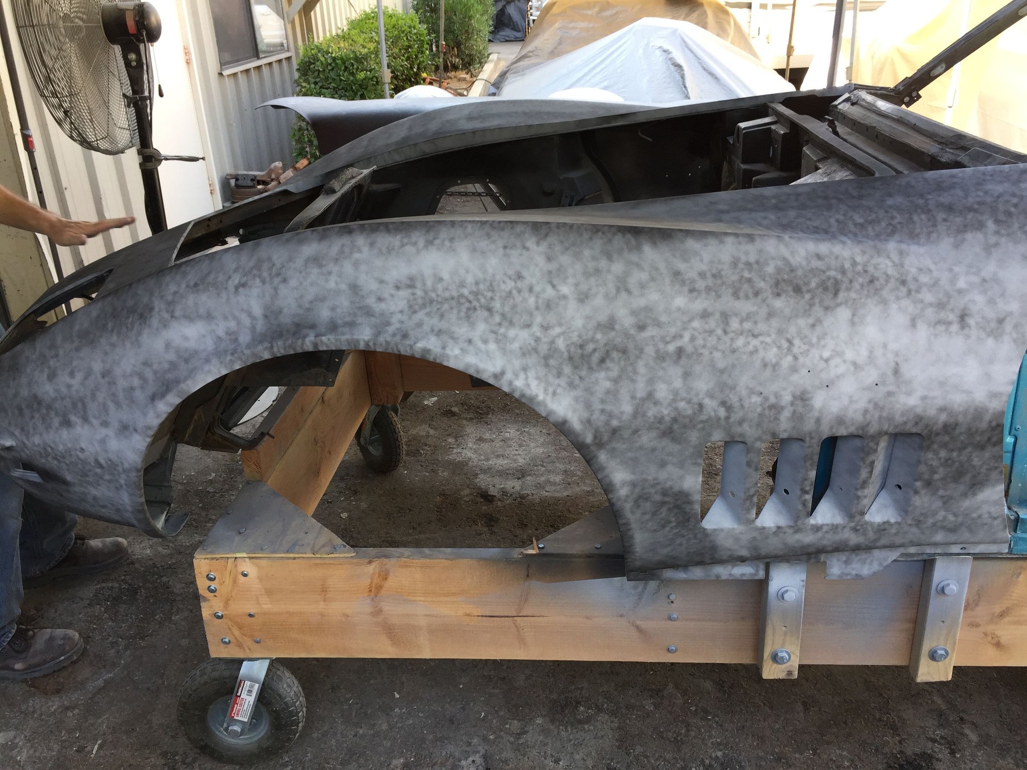

Nope
Black epoxy primer base with sanded skim coat and polyester primer on top

IF you painted the engine compartment black...and then masked it off for the paint job..there still is a chance that some white overspray can taint the black... and this...needs to be touched up....depending on how bad it is...or if you care.
Knowing that if it is done this way..the fender vents will need to be masked off...which is not that big of a deal but that in itself can be a problem IF the inside of the fender where it is going to be painted black is not correct prepped and so on so when the painter goes in and pulls off the masking tape...it does not pull off what was previously applied.
Painting the car white and then painting the engine compartment black...the painter is correct. IF he is going to sand and buff your paint job. Any black overspray that gets on it will be sanded off. And I am sure that if you choose to paint the black AFTER the car is painted white. I bet that the painter will let the paint cure for few days...and thus it will not be that impressionable due to I am sure you are going to use a clear coat...and with that....if any drips get on it...which I doubt due to your painter will be using masking paper. If it did get a drip of black paint on it...it would wipe right off and knowing that you are going to sand and buff it....it would not matter.
I hope all goes well for you and that you have taken into account many variables that can come back and haunt you when you set the body back down and get panels to align. I know it always boils down to what the owner envisions and is willing to accept. And I hope that the last photo that you posted in post #6. Your 'SEMA painter guy' has not gotten to the hinge post area yet. And he is not going to leave or paint over rust where your door hinge shims went.

DUB makes all the exact points Richard, my SEMA body and paint guy, makes. Especially about masking tape pulling off paint that went to places that were not meticulously sanded.
And indeed, the interior and door jams have not been touched yet. I am helping in that area and that is my goal on Monday. The underside and engine bay have already been done
There is also some minor rust repair on the A pilars.
Ultimately, after sanding the interior and door jams are done, it will be hit with epoxy primer. Then we are going to spray Lizard Skin, on the interior for one layer of heat block.
As far a the door gaps, those were attended to before we pulled the body. I realize the risk of body flex after we put it back on the frame
Thanks for all the input.
