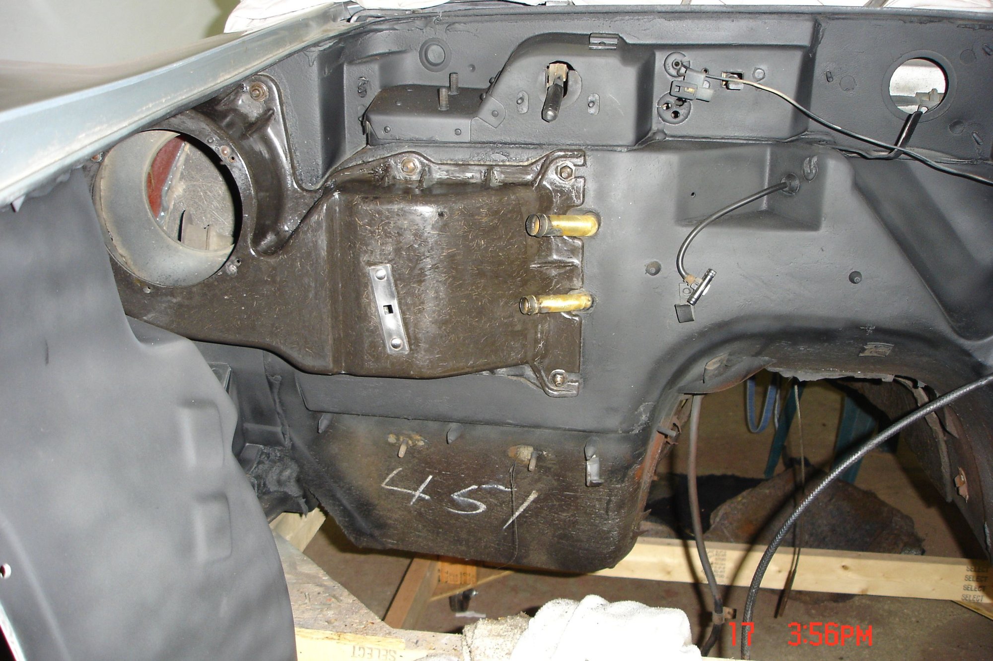

From: La Mesa CA
Here is mine
Nasty dirty

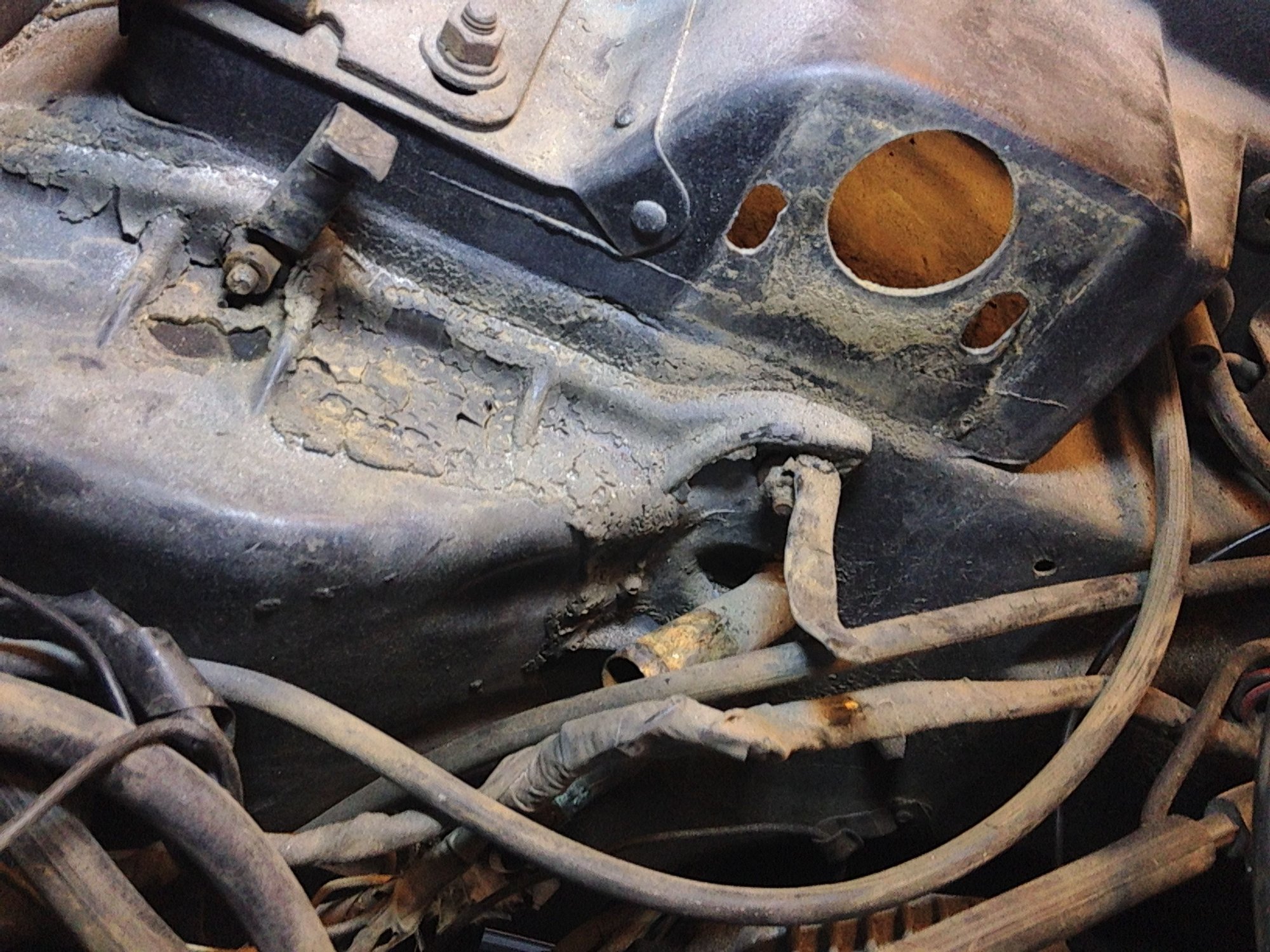

My 69 looks like this
I had it painted in the 90's and the shop that did it flashed on some black to pretty it up, but my best guess is it started out natural
