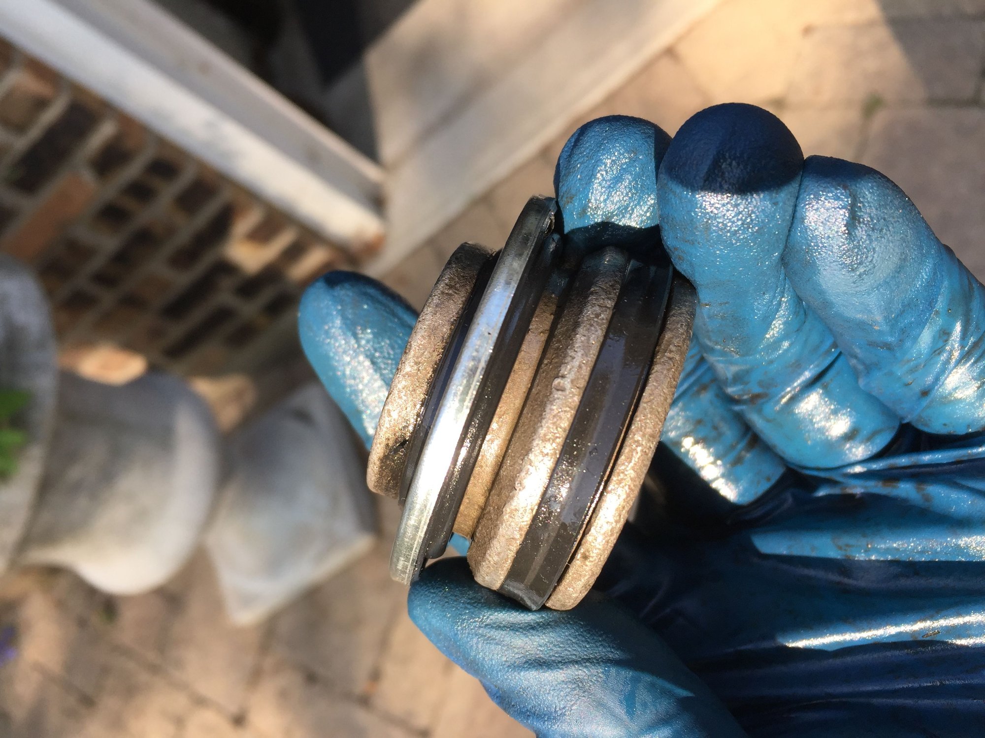

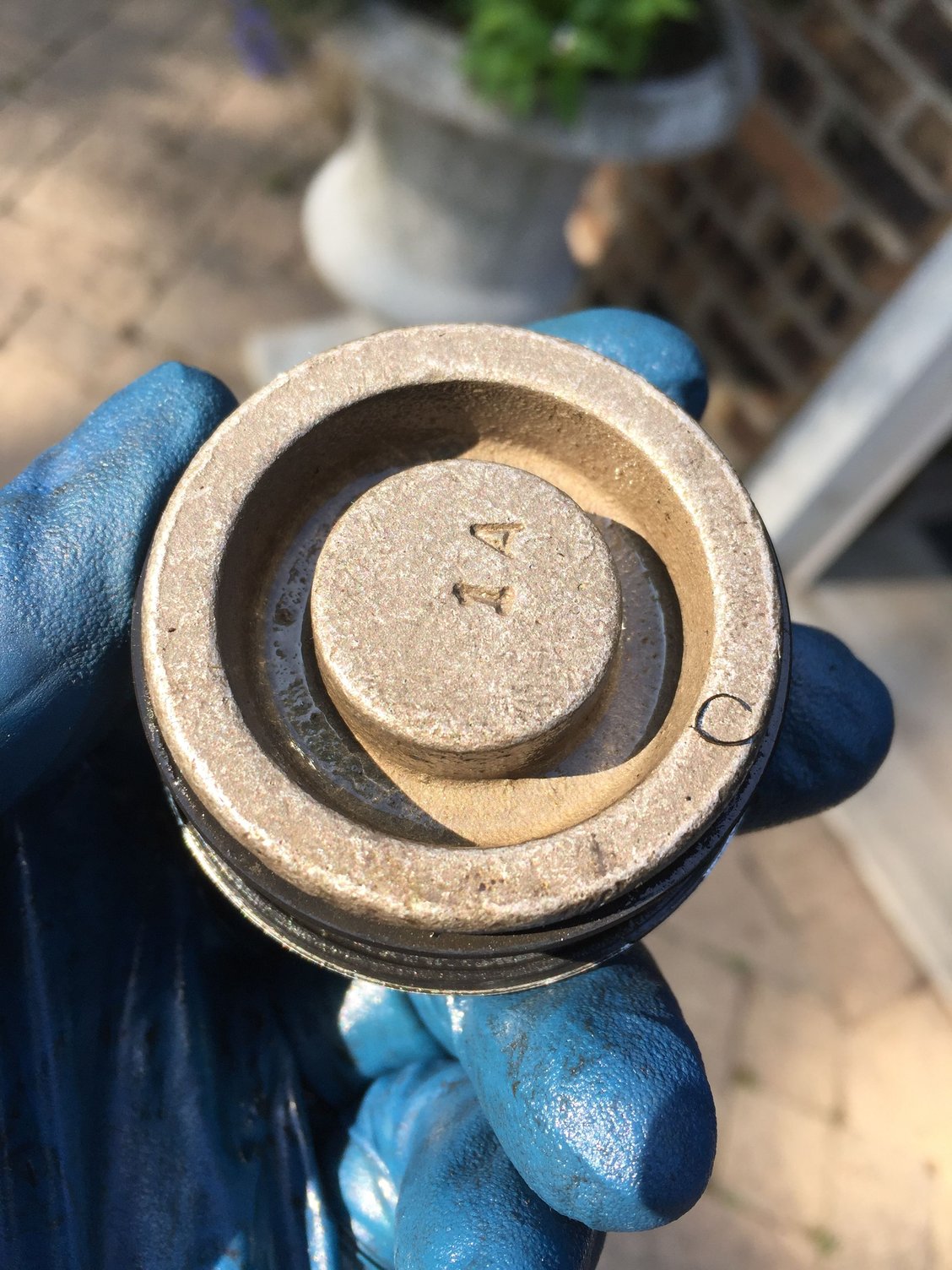

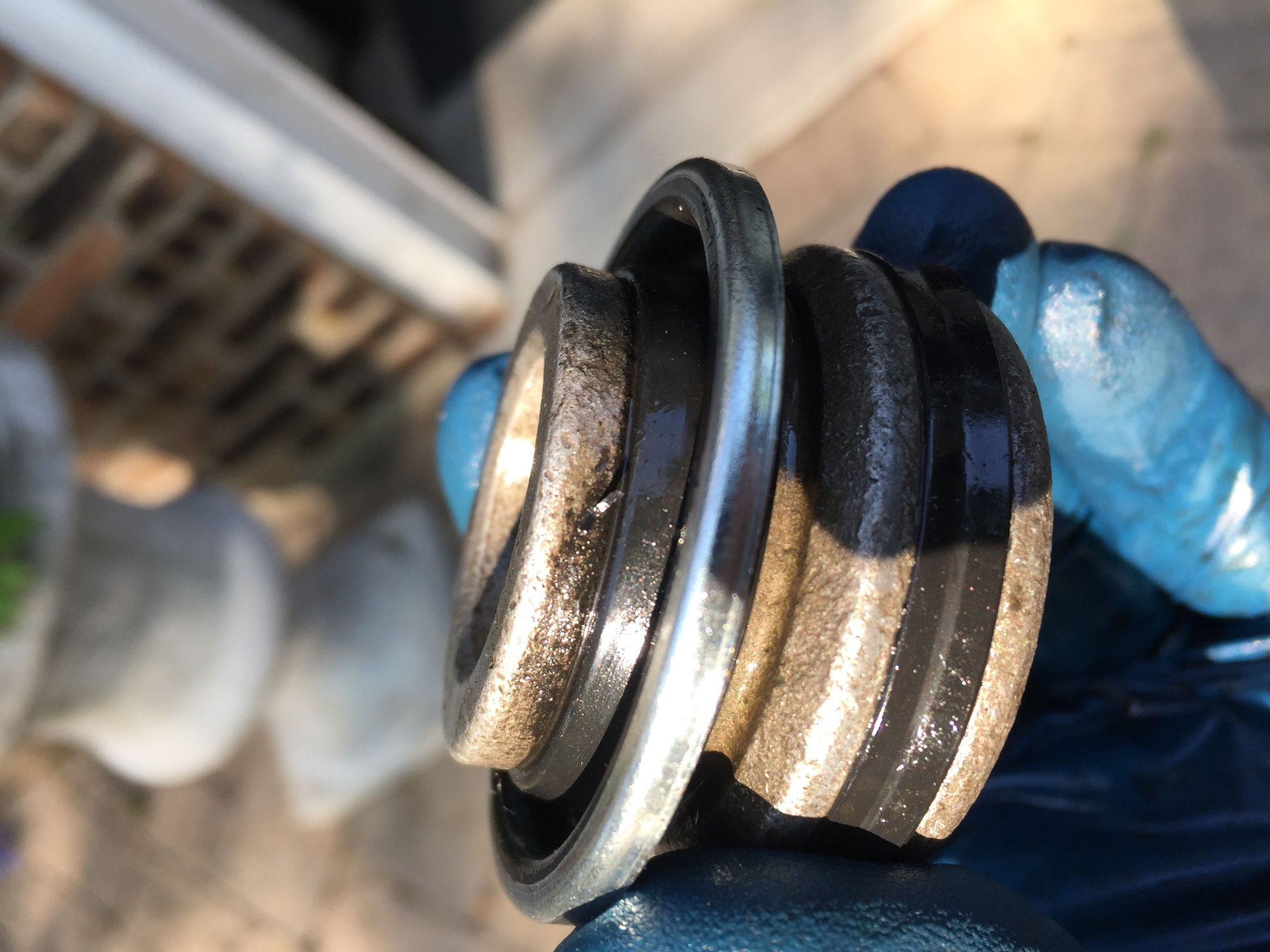

Good Morning All,
I removed the caliper yesterday, which as most of you advised, was not difficult at all. I need your expert eyes however to help me know if i have stainless steel sleeved calipers.
I started by pinching off my brake hose and loosening everything I could on the caliper while it was still mounted on the rotor. Unfortunately, I was unable to get a socket around the bolts that hold the two caliper halves together, so I did that once the caliper was off. Using my electric impact wrench, I was able to loosen one, while just holding onto the caliper. The other one wouldn't budge, though. I needed to put the caliper in my vise for that one, and it was still really tough to loosen. Leaving the bolts snug, I used compressed air to eject the pistons. That worked to an extent, as only one piston ejected (maybe the wood I used inbetween the pistons interfered??).
So here are my questions:
1. Is this a stainless steel sleeved caliper?
2. If it is NOT a SS caliper, what is the reason to switch? The bore appears not to be pitted, and is smooth to the touch (let's assume for the moment the other 3 bores are the same). Can o-rings only be used with the SS calipers?
3. If it IS a SS caliper, what is the best way to remove the remaining pistons without damaging the bores?
4. The pistons look good to me... Does anyone see anything different in the pictures below?

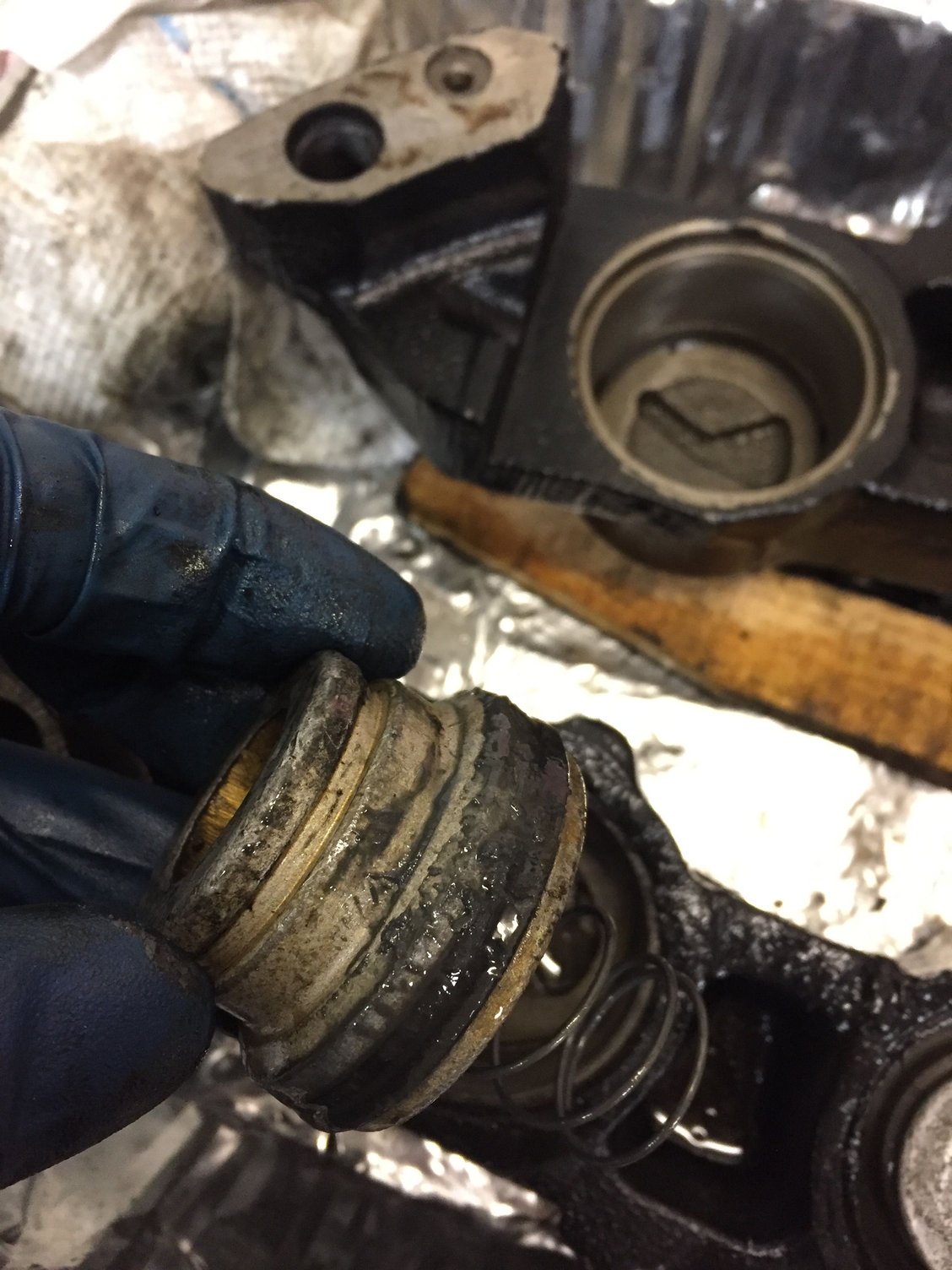

I figured out how to get the remaining pistons out of the caliper halves. The piston that is closest to the bleeder screw was the only one that was sludged up. Could that be an indicator of that particular piston leaking? See the pics below. And I'm still looking forward to finding out if the bores are stainless steel or not. Thanks!

After more research, it appears that I have lip seals on my pistons, correct? I'm also leaning towards the fact that this caliper does not have SS sleeves, as the bore is not super shiny like I'm seeing in some pictures. I'm hoping someone tells me that I'm wrong...

YES. The pistons DO have lipped seals on them.
AS for these calipers having stainless steel sleeves in them I can not see the edge of the sleeve...so I would have to say they DO NOT have stainless steel sleeves in them.
It is easy to tell if you have 'O' ring or lipped seals. There is no mistaking them.
DUB
