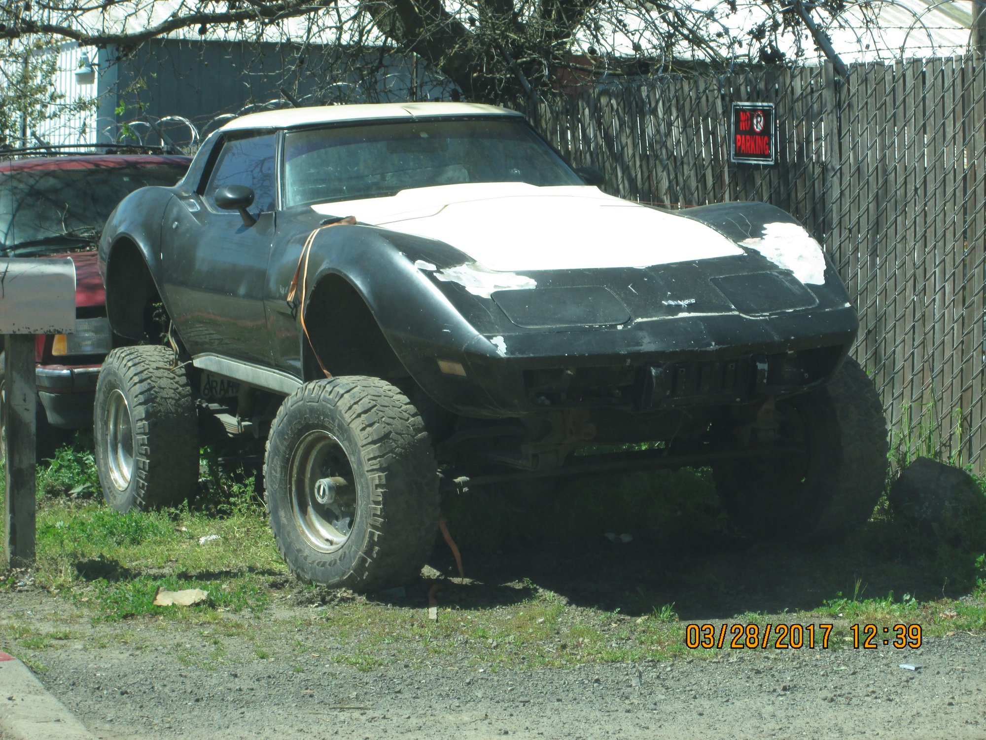

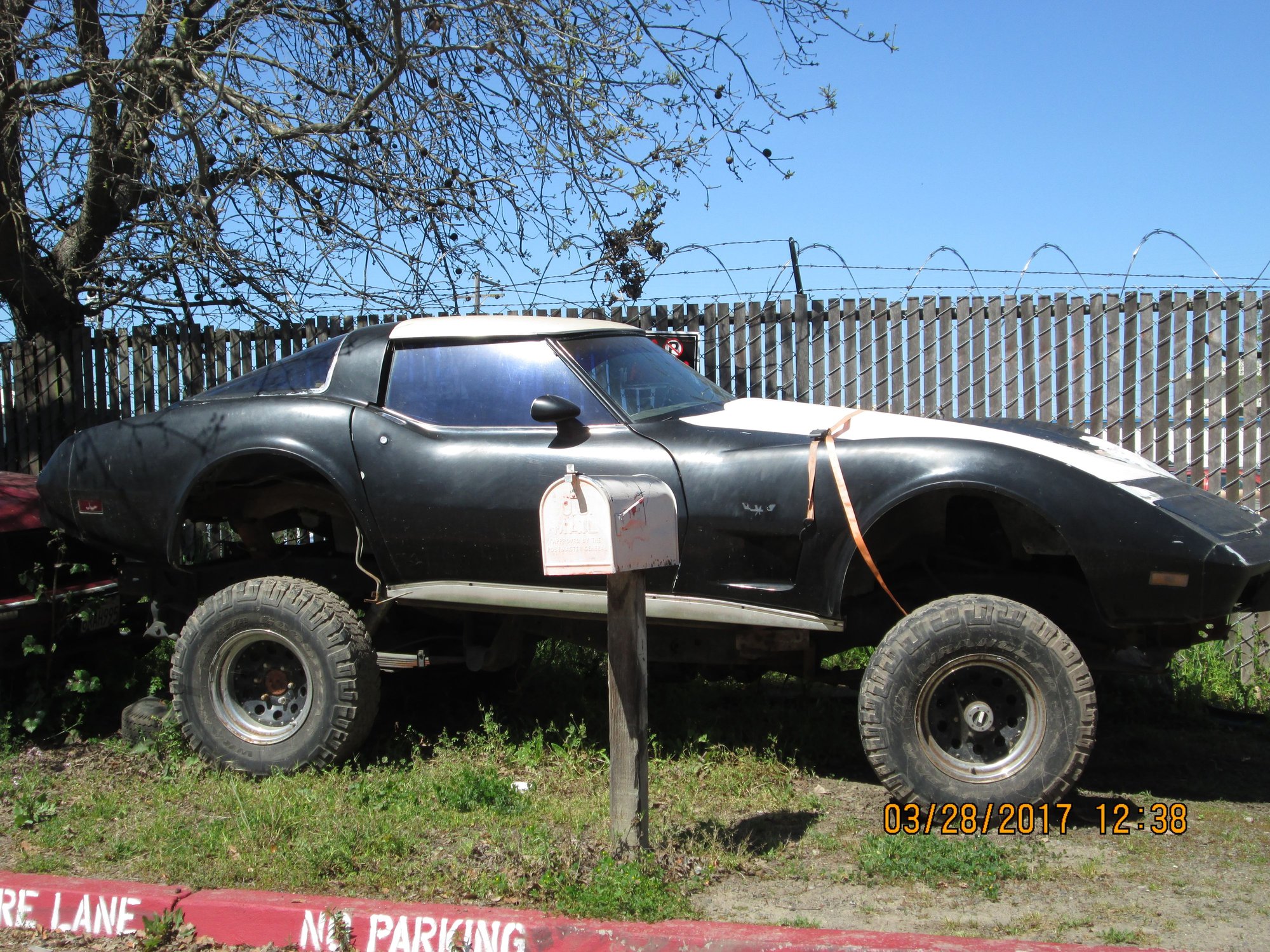

Just Kidding, Not mine!
I found this while investigating an illegal tow yard operating in the City.
The owner was actually pretty proud of the work he'd done.

Like this?
I've got the suspension lifted 12 inches, solid rear axle, transfer case and solid front axle installed.
The frame mods were a headache, but worth it in the end.
New hood is fitted, front nose on order and starting body work.
All running gear and the V8 came out of my 75 Jeep.
And that's how its done up right...
Thanks, BOY, I NEEDED THIS!
MY HERO!!!!! Now we talking! "You" don't need the Gumbo Mudders, because you will be running in sand not Black Jack mud. You only need a small winch because the sand doesn't stick to the drive train like mud does and form a suction on the drive train. "You" still need a brush guard/winch bumper front and rear plus a roll bar. Keep a house trailer tie down screw anchor in the car for when you get stuck between a rock and a hard place. "You" aren't going to have any trees to attach the wench cable too, so you screw the tie down anchor in the sand then hook the wench to, once you get stuck. When you are rock climbing, throw the anchor between two rocks and you are home free.
I was raised in the mud. Not much sand or rocky places here. Here you want something light weight, with good ground clearance and plenty gap between the lugged mud grips on your tires, so the mud will sling out the grips of the tire, while keeping good traction plus you don't sink in the soft mud, dragging your differential and flywheel cover in the mud. "You" need something with a little weight to it, wide all terrain tires so you don't dig a hole in the sand and a snorkel for the intake so you don't suck up sand in the carb. I'm like a fish out of water when it comes too all this highfalutin street car mumbo jumbo, but get me off road..... I'LL MAKE YOU PROUD!

Man...That Hurts! You had me all fired up! THINK HE'D SELL IT?

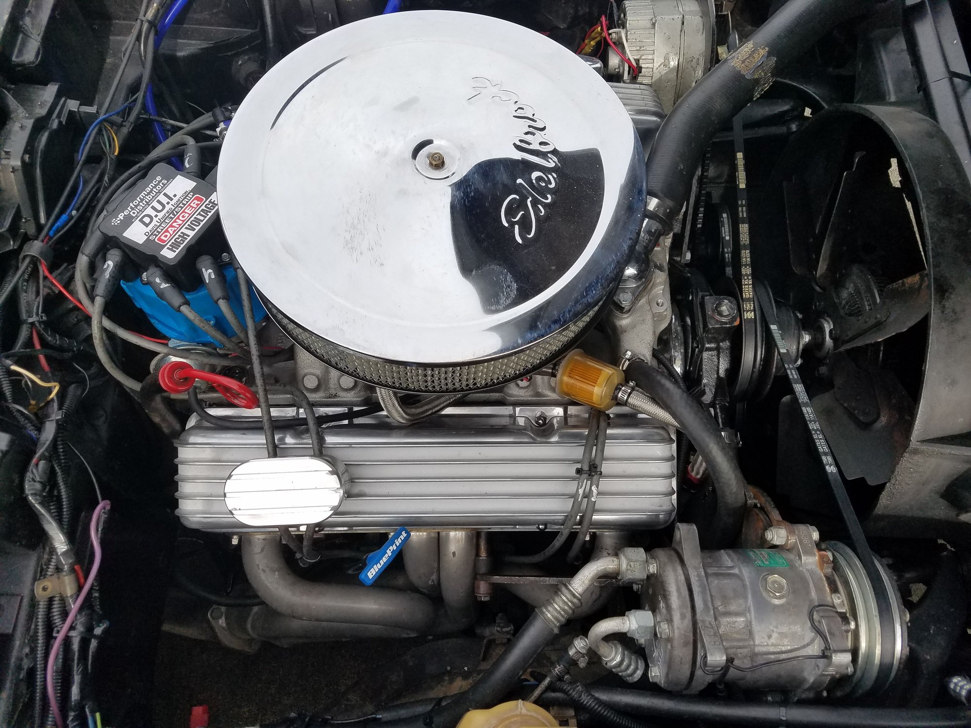

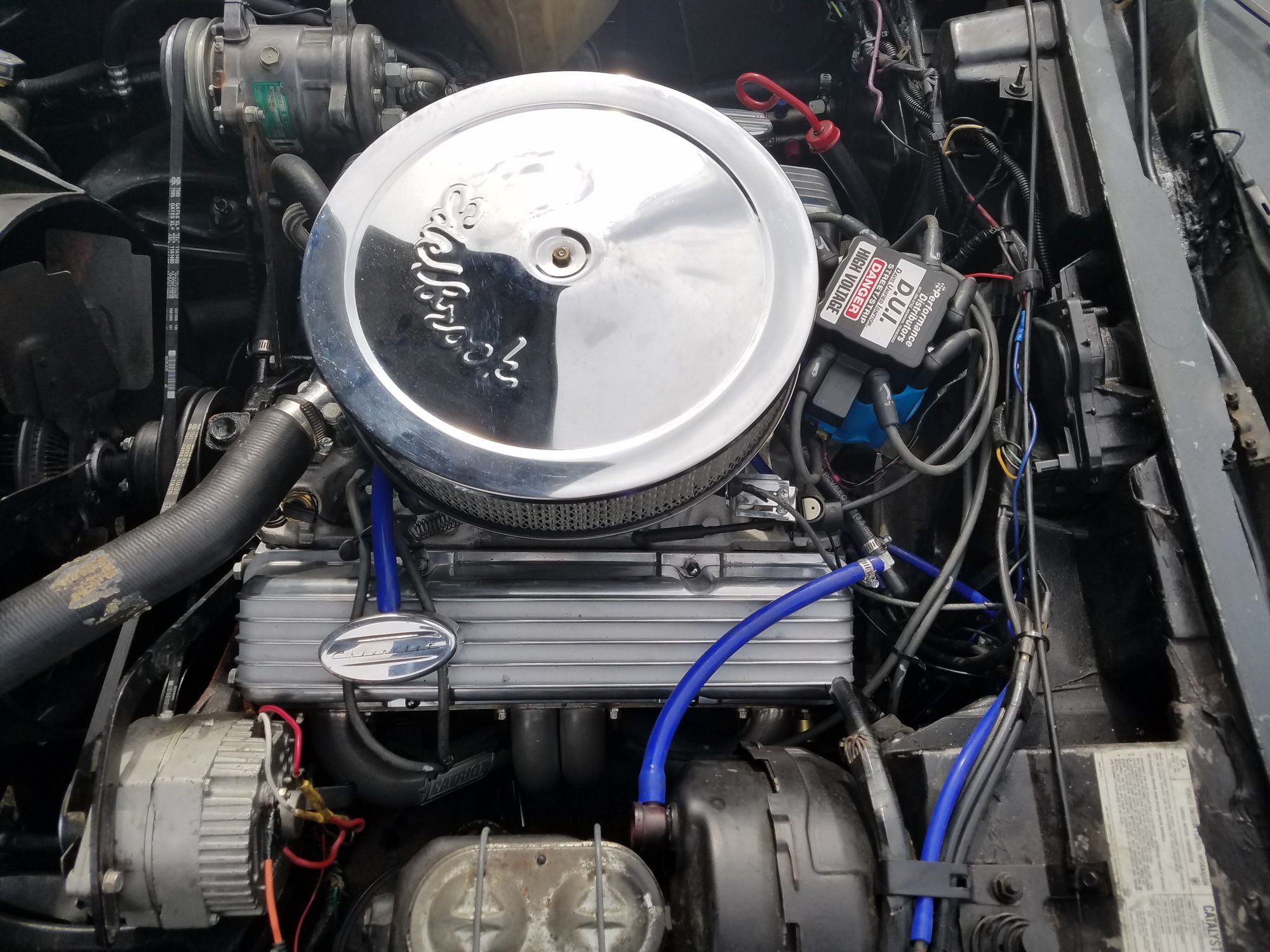

Finally got the oil leaks on the new engine stopped. Had to replace the factory valve covers with heavy duty ones plus install a good PCV valve.
KNOT-HEAD
New valve cover and vent. 2/14/19
New valve cover and PCV valve 2/14/19

they did not stab your distributer correctly..

How should it be stabbed and what difference does it make?

See how that plug wire on the drivers side is hard up on your intake? it should be more square on it, even on both sides.. that is to say it should be clocked back CW a full tooth on the cam
then it would fit and look better.. this way you are maxed out on the timing, as the plug wire/cap will not let you advance it any further..
Also it can cause spark jump at that point

Thanks,
If I more the stab point, will that change the timing?
