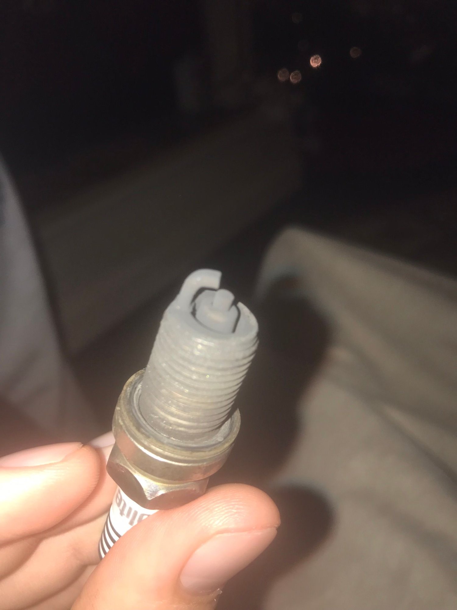

Is it just me or the camera angle? But in post #18 the end of the ground strap electrode is missing. It just looks short of reaching the center electrode. Maybe not.
Old Dec 18, 2018 | 09:57 PM
  #45
Big2Bird's Avatar
Big2Bird
Joined: Dec 2006
Posts: 8,837
Likes: 1,028
Maybe. I "think" I see that as well.

Originally Posted by Japery
these are the hotter plugs. Autolite AR3910
Can you post a better picture?

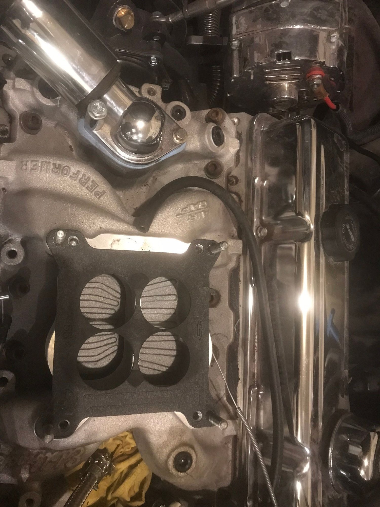

Plenum looks clean

Yes, intake does look clean. But I still question the grd strap electrode on that plug. Looks short to me.
Blue Print puts the ALT on the passenger side? H-m-m-m-m. More work for you eh?
Anyway, that plug should still fire, just not normal. If you were expecting fuel to be sitting in the plenum, it evaporates pretty fast. I bet its flooding some how.
Hard to tell but looks like the drivers side of your carb base gasket is stained with fuel, leakage? Maybe?
So. Lets digress:
You have a Eddy intake designed for a Spreadbore carb.
You have an Eddy carb
You have an Squarebore bolt pattern.
You have a 4 Hole gasket or spacer.
You are experiencing a flooding condition.
There must be a clue there somewhere. Not sure you should be using the four hole gasket. Maybe an open style would be better What I am getting at, I wonder if that gasket is blocking any ports on your Eddy carb?
It's a cut back ground strap. Old racer's trick from back in the day. I guess this Autolite comes like that? Anyway, cutting the strap back like that it will still fire, just won't last very long. it also won't make more power that way, go with a regular ground strap.

Maybe this is a dumb question but do you get a gasket to fit the carb or the manifold?

there should be a metal adapter plate for the spreadbore to squarebore carb. Edelbrock make it and says its mandatory. Its about 1/8" thick and needs gaskets above and below.
it looks grey because of the flash but its black powder.
I always cut back my straps on the Top Fuel stuff. The shorter ground strap exposes the spark for better ignition of the hard to light off nitromethane. The ground straps also would stay cooler being shorter and wouldn't burn off as bad. I never saw much improvement in gas engines though, although I have run them like this on the street and they last just as long as regular plugs with long ground straps.
