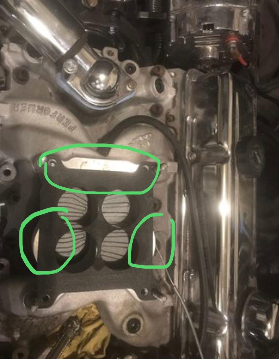

It appears to be the Performer Air Gap with the dual bolt pattern and the spread bore type pad....I have circled the areas in green that are the problem areas that the 2732 plate will address.....
My own 2101 leaked around the front of the carb base circled.....this was due to an old model 1406 Edelbrock....the newer ones are better in this regard.

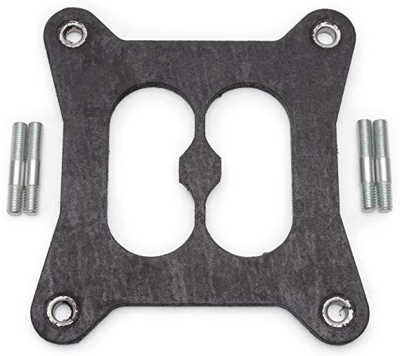

A gasket is designed to seal two items together without leaking. As you can see in photo / post #68 the gasket has no material under the four hole plenum area.
That is just some fiber hanging in mid air doing nothing. If you take a look at a FelPro 9100 base gasket, post #63 you will see that an open style will suit your needs a little better than the four hole style. Or the gasket underneath that, might be better yet. It copies your intake but not your carb base.
(Had you had some type of four hole style intake, then, you would have had the correct gasket)

would this 1/2" heat shield gasket work?
Old Dec 23, 2018 | 02:45 PM
  #76
HeadsU.P.'s Avatar
HeadsU.P.
Joined: Aug 2017
Posts: 8,336
Likes: 2,810
From: Cool Northern Michigan
Better than what you have now. You can also get this with a aluminum heat shield that fits under this thick gasket. I have used this on the Eddy 2101 Performer intake with a Holley 4150.
Not sure about fitting your Eddy carb. I have never seen the throttle base plate of the Eddy carb. May have to trim the center tab section but it should fit your spreadbore ok. I believe its designed for Holleys. IDK

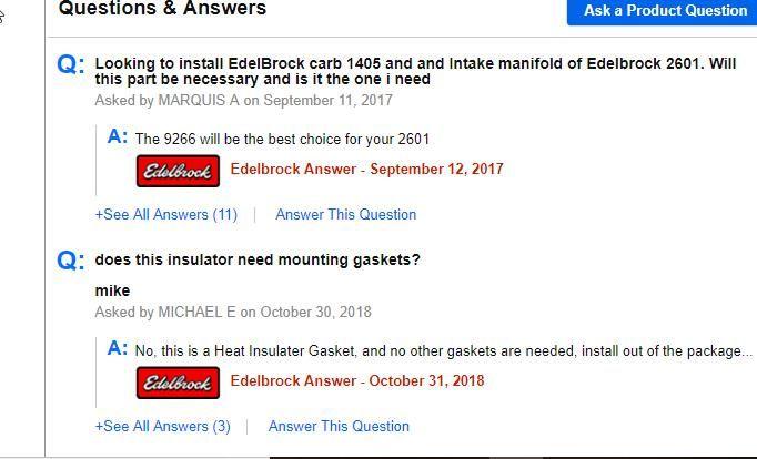

Summit's site says the 9266 is a direct replacement for the 2732. However it also mentions 4.5 psi max for an eddy carb.
A:If its a performer series carb, yes you need a plate. You should post the carb model number for a more accurate answer. If you experience hard start problems in warm weather after the car is at operating temp, you will want a wood or plastic spacer. Edelbrock carbs have a fuel boil problem. If you have flooding issues when its cold then you will want to bring the fuel supply pressure. Edelbrock states their carbs dont need over 4.5 psi fuel pressure. I installed a holley fuel regulator to solve my problems as well
MICHAEL from MA answered on February 19, 2017
To persistent spark plug fouling
