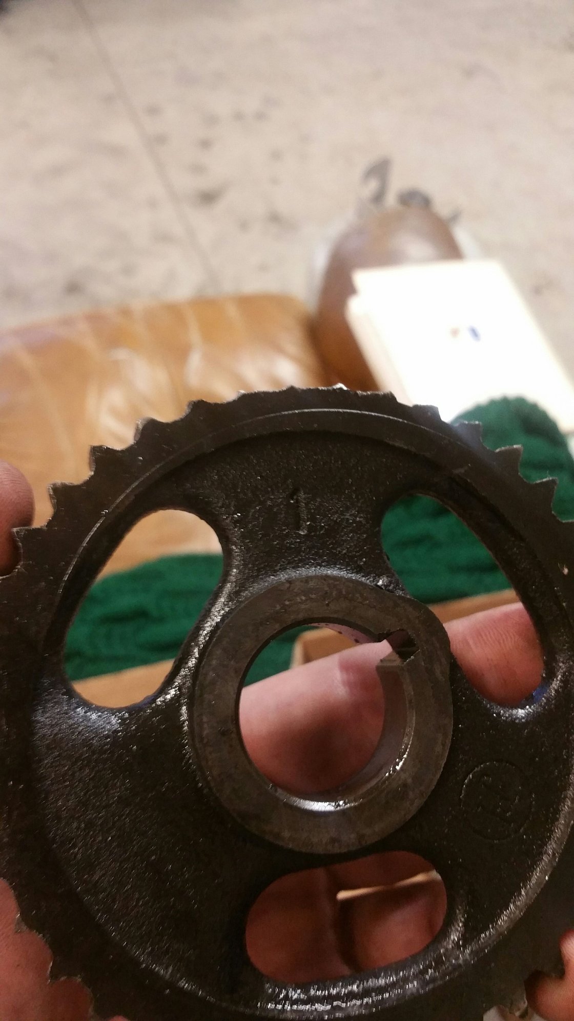

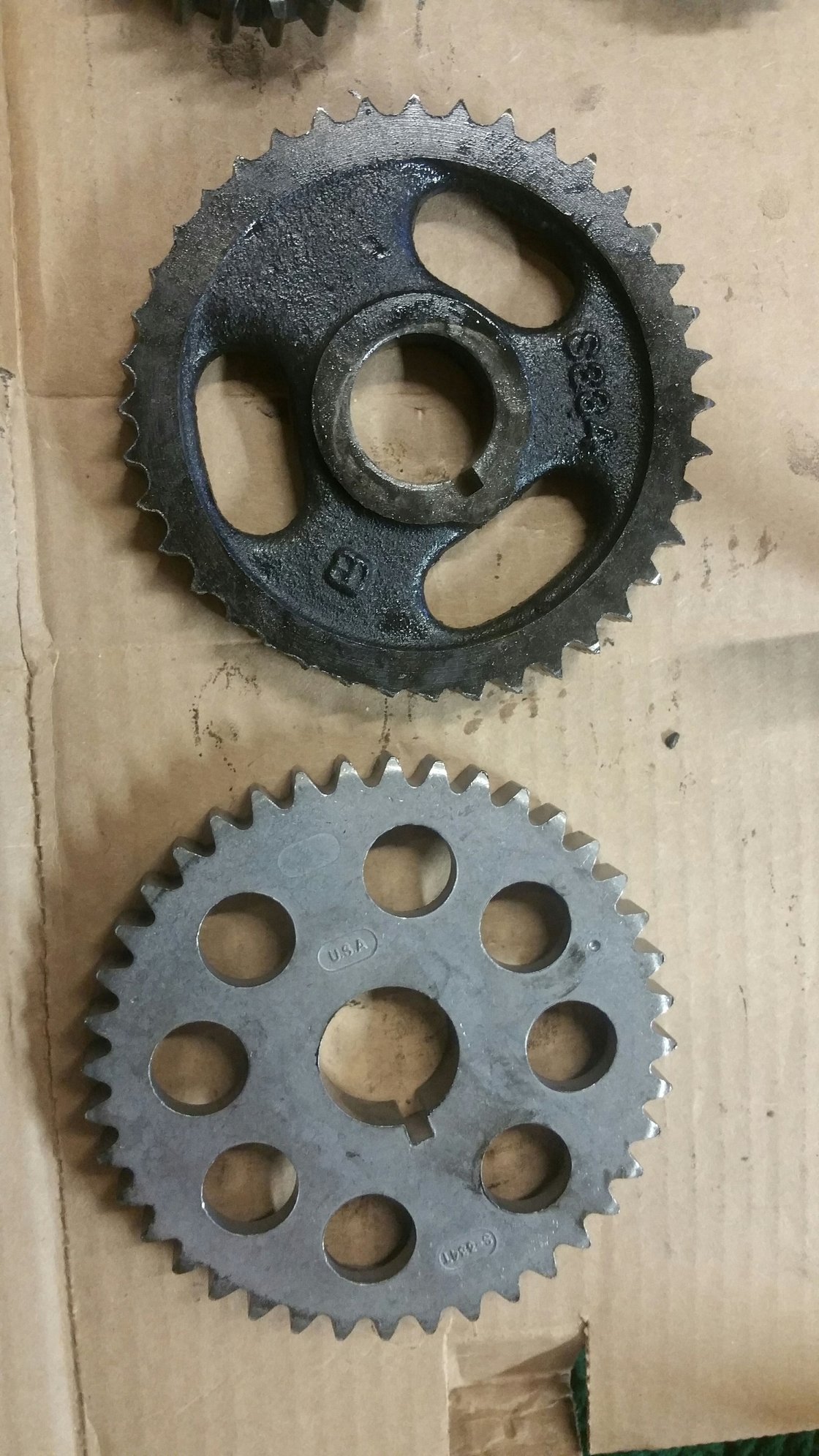

With timing changing when you shut down and restart, assuming the dizzy is clamped tight and not rotating, I'd suspect the timing chain is getting real sloppy. Or perhaps distributor bushings are worn out or balancer still slipping. Something is moving.
Here are pics of the cam gear I pulled out of my 67 CJ5. Dauntless V6 which is a Buick oddfire 225.
That was the most wear I've even seen on a timing set. The chain was so loose that when pinched at center there was maybe an inch between the sides.
The jeep actually ran really good like that though a little lacking on power. Once I replaced the timing set it ran like garbage. After a lot of frustration, ending up figuring that when the PO did a tuneup, he put on an even fire distributor cap. Probably an auto parts store screwup. Until I brought them part numbers, they couldn't get me the right cap. Lots of confusion out there with the odd fire motors.
My point is that problems can be multifaceted (espicially with old stuff) and more importantly, you can't assume anything that's been done before was done right. Even master mechanics make mistakes but I'm more referring to PO's.
Chasing this kind of thing down sucks but after you figure it out, it's very rewarding. Good luck and stay sane!
