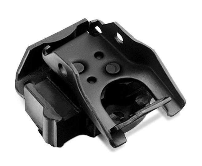

You can buy rubber mounts that have a movement limiting feature designed into them. This one is made by Lakewood, but I'm not sure if it will fit a Corvette.
