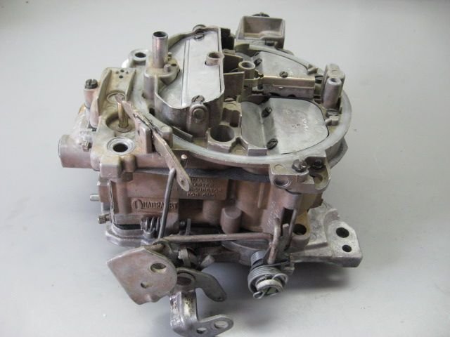

Look closely at the number and the way it's stamped: First of all, the number is stamped the wrong way - look at a corrrect 7041205 here (I dont have a photo of a 7041202 stamp, but the 7041205 stamp is the same):
Then, look at the first "0" in your carb stamping, and compare it to the second "0" in the stamping: One of them is a "zero," and the other one is an "O". Rochester never used 2 different "0" stamps in the same part number:
Your carb is a re-stamp. The textured surfaces show that it's been sandblasted and replated. A commercial rebuild that's been hacked. It is not what it is represented to be - likely pieced together from several different carbs.

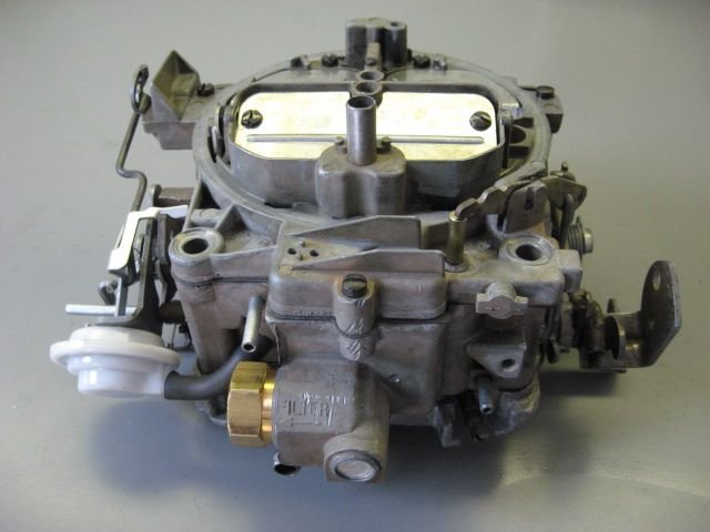

Here are some photos of an actual, authentic 7041202. Compare this to what you have:
The reason the Q-Jet is in a box and the car has an EDL carb on it is because that commercially rebuilt Q-Jet in the box doesn't run right, and probably never will. Leave it in the box.
Lars

Likes: 6,391
The 7041202 carb would run and work great if it was a "real" one that was not tampered with. It is effectively identical to the Vette 7041213: Jetting specs and setup is identical. Unfortunately, from what I can see of the carb with the fake stamp number, I would not recommend using or attempting a rebuild of that particular 202 carb, so searching for a 213 would be a good idea. I don't have any rebuildable 213s in my parts inventory, but the OP would be well advised to not exclude the 202's, 203's, and 212's in his search for a good, rebuildable 1971 carb that would be "visually correct" if a "numbers-matching" setup is not a requirement. Any of these would produce an outstanding level of performance at a reasonable cost: The 202/203 Chevelle carbs are a few bucks cheaper on the used parts market.
Lars
