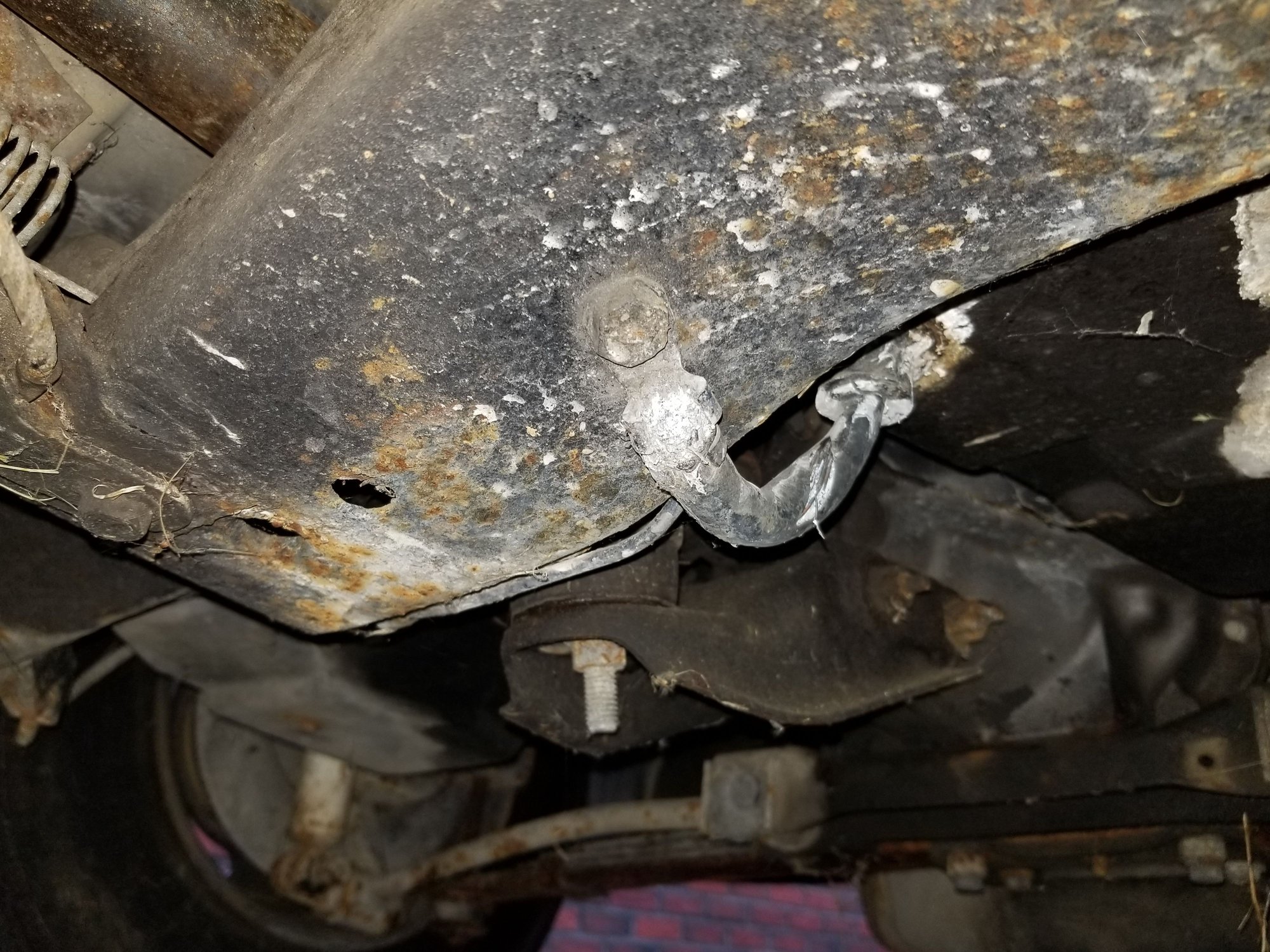

another ground. the first. the worst. my 75 looked like this... straight below battery box. the lug on the frame is a cheap POS. if cable isn't too bad, a solid copper one could be crimped on the end of the cable. the big heavy grommet where cable goes thru batt box is a PITA. doesn't have to be salt. differential metal electrolysis. steel to copper to aluminum wire. i used to build starters for a living. i had 10 in the basement. i can do a delco starter with my eyes shut. i won't use them. ditch the starter for a perm magnet gear reduction unit and lose 15 lbs up front.
