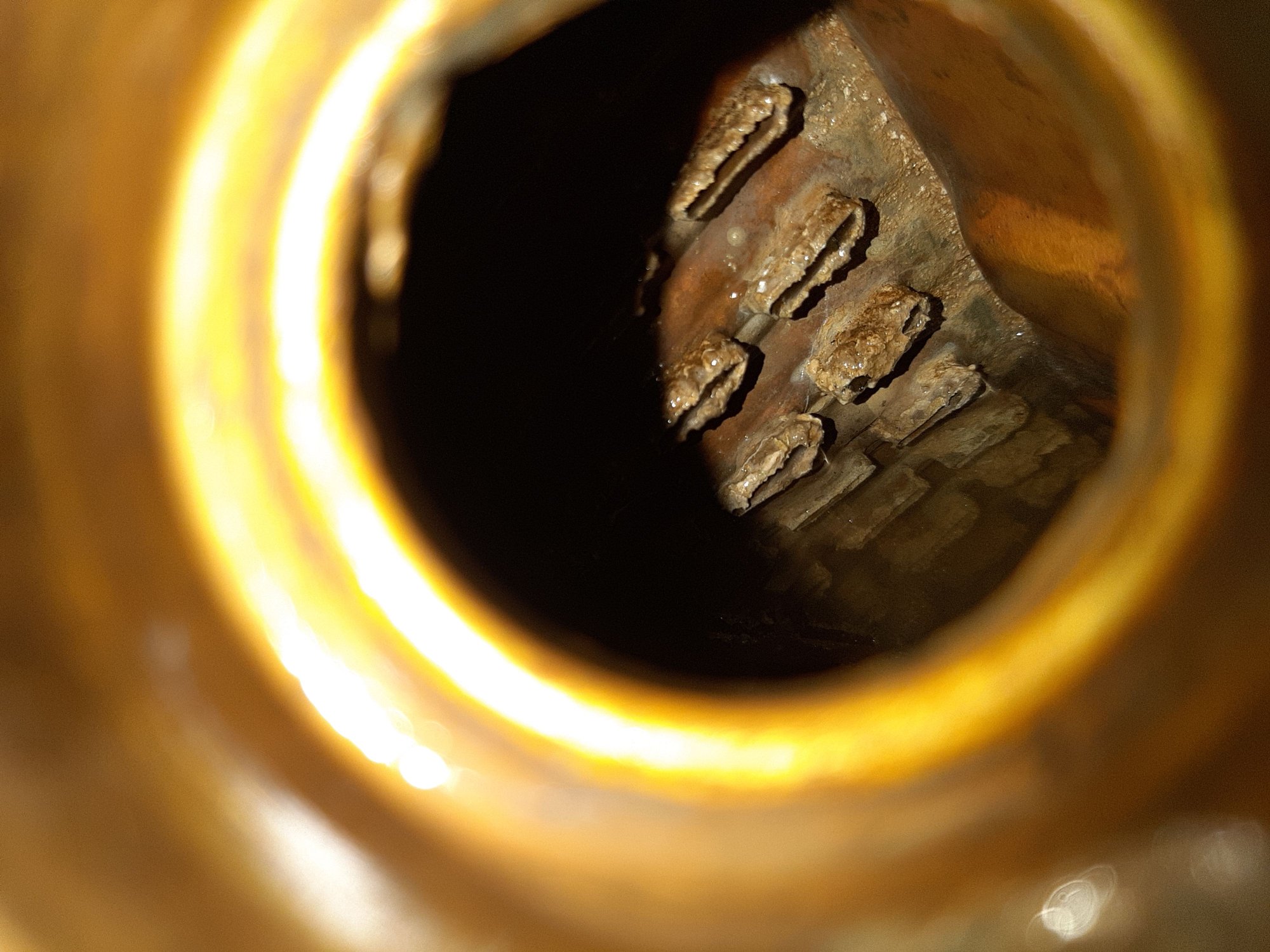

Hard to tell by the picture but do you have a six blade or seven blade fan?
And yes, the rad needs an acid dip.

You might be able to get rid of much of that lime buildup by getting some 'radiator cleaner' (not flush) and going thru the process listed on the jug. It can be found in most auto parts stores, right next to the radiator flush stuff. It takes some effort and time to use it properly; but if it saves pulling or replacing the radiator, it would be well worth it. I used it on my '71 car's radiator about 10 years ago and it did a really good job. It will stay that way if you use nothing be antifreeze and distilled water (low $ at grocery stores).

I have a 6 blade fan.
At work we sell liquimoly radiator cleaner, its supposed to clean like deposits out. I've already used that but didnt do much maybe needs more?

New radiator, 40 minute run including 20 km highway

Probably the best solution to your problem. Putting that clogged-up rad 'out to pasture' was merciful.
