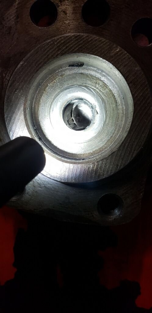

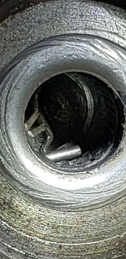

Two summers ago before my engine and transmission rebuild I decided to have a new clutch put in at a local shop 500 miles later after lots of shift problems and clutch adjustment issues here’s what I found.
Guess what I installed on the rebuild? Yup a bronze oilite from autogear

Not for nothing, but that is a caged bearing. I would only install a full compliment bearing there...but I digress =) The bushing will be just fine.
