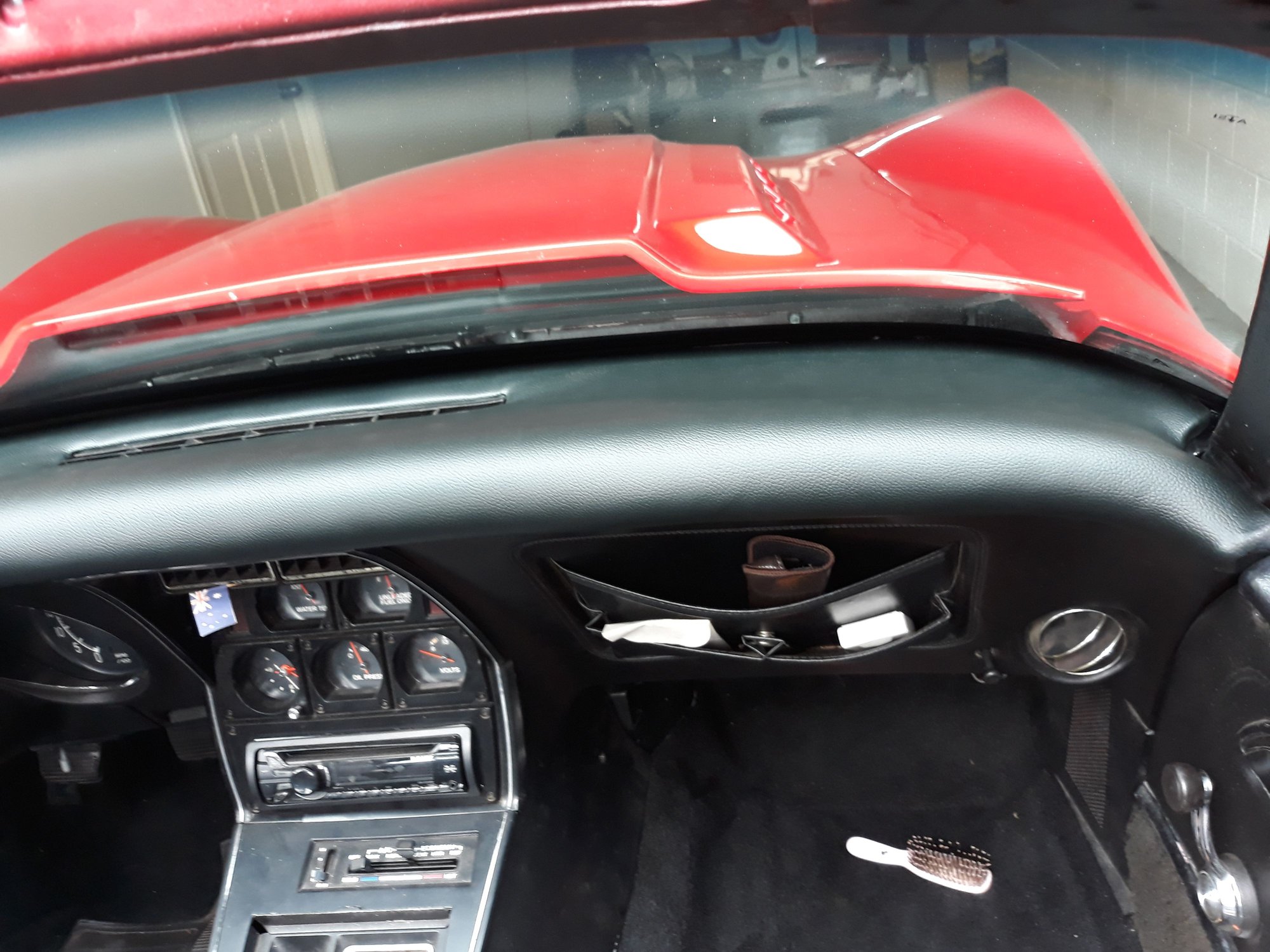

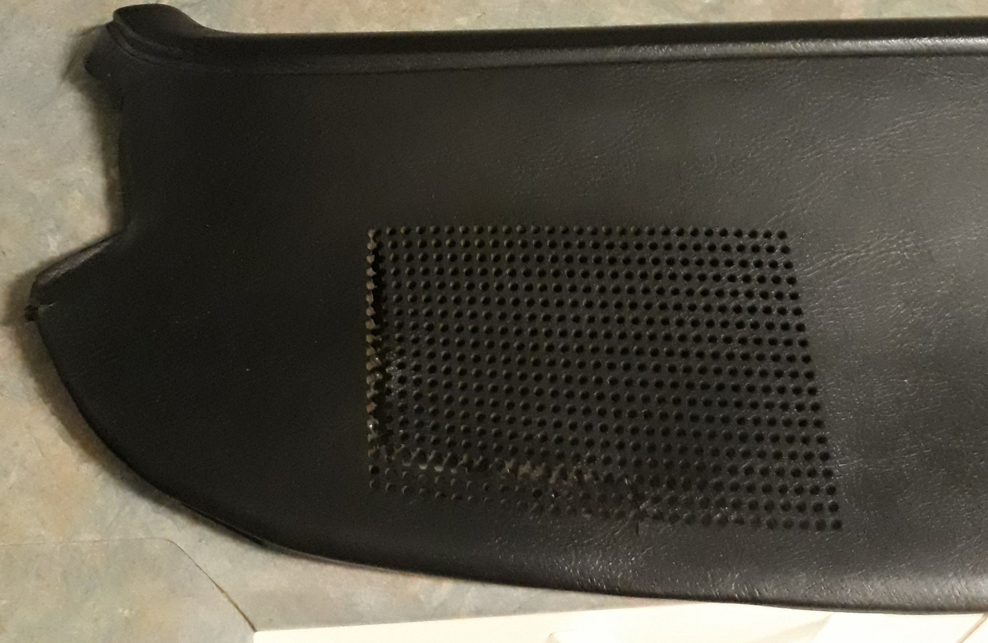

Bit of an update, been busy with work, working a lot of afternoon shifts and trying to get things done in the morning before starting work.
The vinyl on my dash was cracked in multiple places and the speaker grills were rat ****, so when one comes up locally I'll be buying a dash pad, however there are none where I am at the moment and I decided for now I'll try my go at re skinning the vinyl and moving the speakers to behind the kick panel. So I had a crack at a cost of $15 and it is by no means perfect at all but I think it looks better than what I had and will do in the mean time.
I then moved onto doing the front end. New control arm bushes, tie rods, ball joints and shockers with a coat of KBS and re sealing the brake calipers and a coat of paint. Didn't get a before photo so I took side photos which shows before and after. Looks good currently hopefully stays like that for a while.
Photos -

Honestly, my dash wasn't as bad as yours.
But this drove me insane.
So I did this.
like yours. Maybe not perfect, but heaps better. Some thin (4mm) foam with vinyl over the top.
Speakers in kick panels and in the back.
