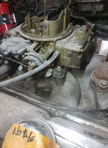

Okay so I decided to go complete fuel hard line from pump to carb.
I have ordered everything I need to complete the job including a 37 degree flare tool as I'll be running 6AN fittings from pump to carb with an inline fuel filter.

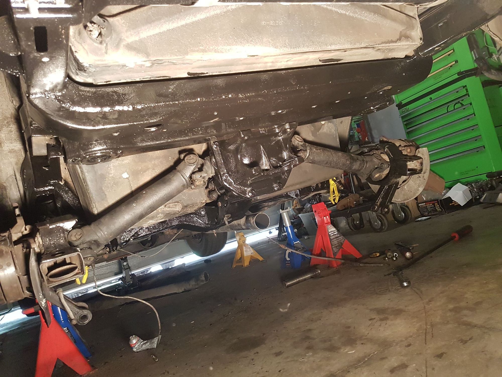

So next thing I did was put the passenger side trailing arm in. I decided that I would align the rear axle myself so I ordered a shim kit for the trailing arms so I can get it spot on.
Diff it back in.
Definitely not show quality but I have the whole rear end KBS coated and it will be functional. I didn't do the half shafts, I'm kind of wishing I did but figure when I take them out to replace the uni joints I'll give them a clean up and paint.
Still waiting on parts to complete the rear end, parts being rear brake hoses and pipes that run along the caliper. Caliper seal kit and trailing arm shim kit.

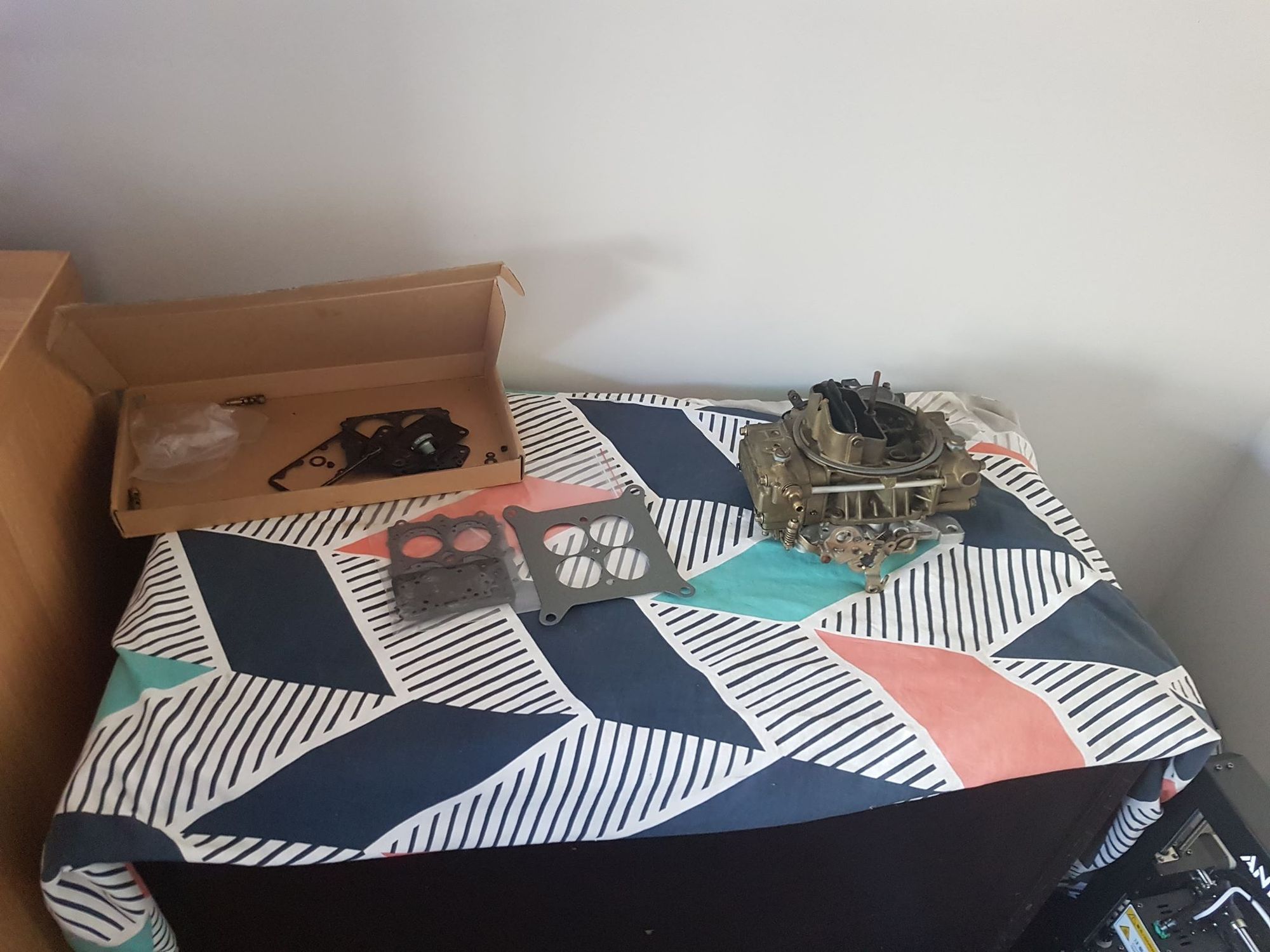

So whilst I've been waiting on parts I decided to put a kit through the Holley carb.
All done. Now I'll wait til I get my fuel hard line done before putting it back together.
Not as clean as people get but once again I'm just after a weekend cruiser not a show car.
So my next steps for the motor will be to clean the intake manifold.
Fit the hard line and carb, adjust valves, upgrade to HEI. Get running nicely and then go from there.

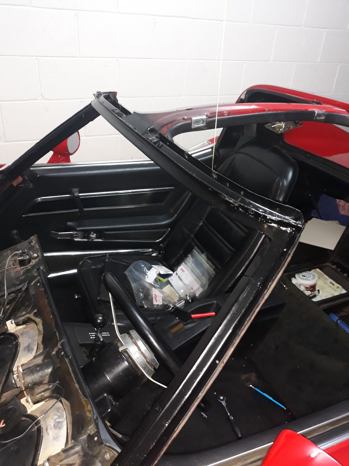

got a heat gun ? you will need one to unstitch the glue , scrapers for helping and above all else PATIENCE , you cant rush it or you will tear the glass edges .

first thing to realise , its a big messy job , all the pieces will need to stay undercover with winter coming , so make sure you have room .
Taking the whole clip off in one piece is the best way to go , you need to see how bad the bottom surround is , but with rust that bad , I would say your firewall to steel join is not so good anymore .
anyway , I have been there , so if I can help let me know ,

Hello and welcome to the forum. Just started reading your thread so excuse me for the late welcome.
I'm from southeast Queensland, originally from the states. Just did my windshield frame as well. But must admit mine wasn't as drastically bad as yours
Rust in upper left hand corner, when I hit this with a wire wheel, it opened up a hole the size of a 20cent coin. (Like a quarter for the Americans). Fortunately for me it was just the outer most layer that was badly rusted. Some light surface rust in both lower corners and upper right.
In the process of cleaning up the lower windshield frame.
Sealed with rust converter and painted with a satin epoxy enamel. And yes that's factory red paint on the top of the T bar. Don't think the stainless trim had ever been off on this car. A bit of a welding project, but a small one compared to what your looking at. Lot's of really good advice on this forum however. If you can weld, you'll get there in the end.

I'm now working on the lip that runs up the front of the firewall followed by the top.
If anyone has any tips / measurements for this that would be great.
Also I ordered some Vette Panel Adhesive but it got denied to be sent to Australia for some reason (Got a refund though)
I'm after a similar product, what's similar guys?
I tried to get the VPA as well , I got told if I ordered a pallet full I would get it , Its classed as a hazardous material so the shipping charge for a couple of cans would be astronomical ! I even said I don't care , I just want it , but they still wouldn't get it over. I tried Summit racing , they airfreight shock absorbers cheap to Australia , but they wont sent VPA as well.
I can think of 3 things that might help you with the shape , if your windscreen glass is still in one piece , you could use the shape and guesstimate the curve, or make a fibreglass edge off the glass so your not handling the full glass piece. . Or if someone is local with the same year birdcage that doesn't have a windscreen in it , you could get some fibreglass and make a skin off the corner and use that to check your shape as you go ?

Hmmm, I'm thinking I'll put the windshield in and fit the bonding strip and it should give me a rough idea then I'll use some tig rods and make a shape by bending them to try and get it correct and make a sort of mould.
Also in regards to the VPA which I don't have access too.
I just bought some kitty hair for a bargain and some rage ultra.
But I just found out I do have access to West Systems. What are peoples thoughts on West Systems and what product do you use.
