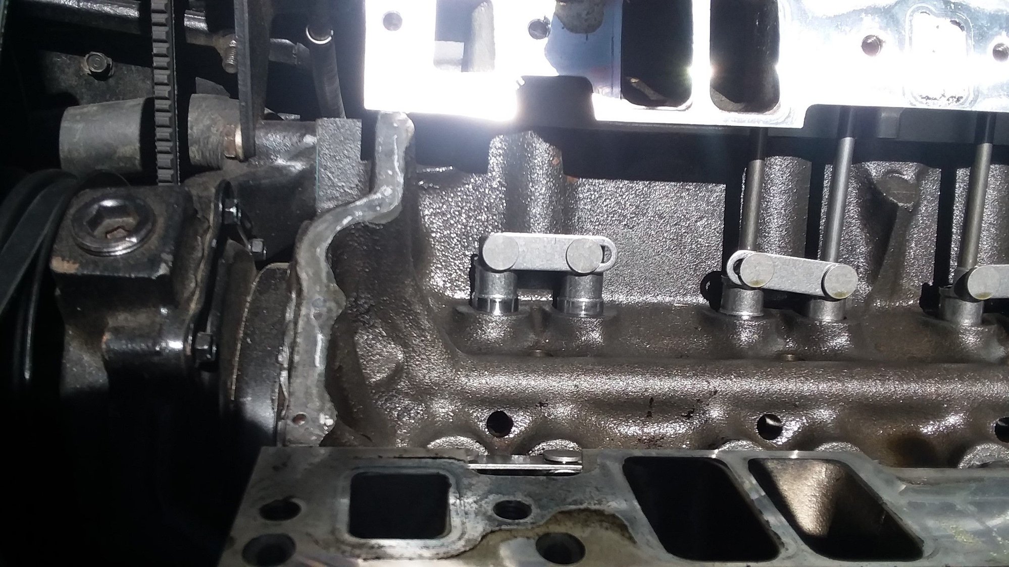

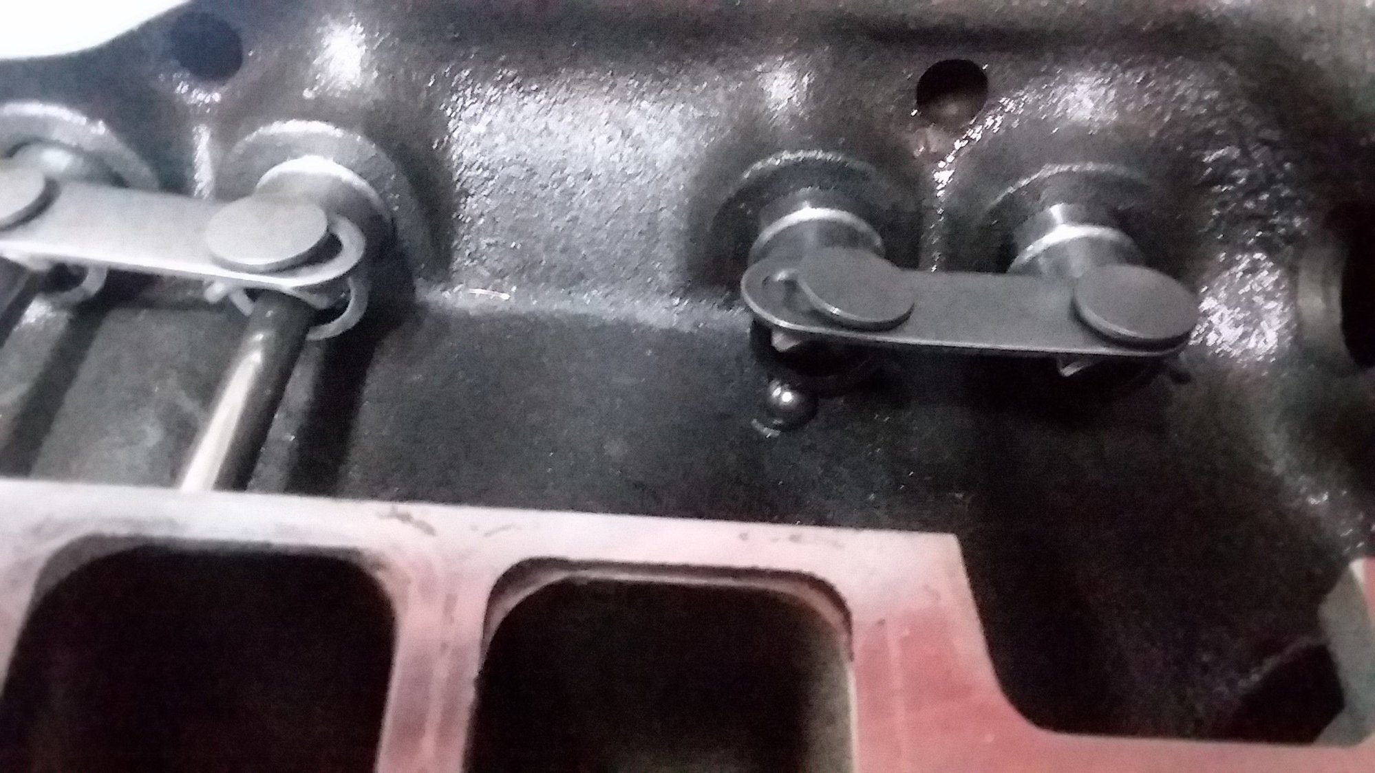

The lifters are not budging, they are completely stuck in the bores. I'm afraid to go trying to pull them out with vise grips or something for fear of tearing up something else. I suppose I've gone as far as my limited abilities will take me. Should I go ahead and try to remove them?

If it were mine & I did Not have another good block in the corner ...and I had No recourse w/ builder ... I'd TRY to save lifter bores ... pull motor ... remove pan and look for debris and look up into cam for damage ... remove cam sprocket ... remove fuel pump & rod ... remove cam expansion plug at rear of block .. TRY to remove cam from rear while jostling/manipulating damaged front lifters on cyl #2 ... determine if damaged portions of lifters can be cut/straightened enough to remove without wrecking bores.
Failing that, damaged bores Can be repaired / bushed ..$$$$$
Sure looks dry in there.

Well, I found the pushrod end jammed between the block and the lifter. Managed to drive it out with a screwdriver and a BFH.
The lifters came right out and they looked OK. Put them back in, turned the engine through a few rotations and they are both moving up and down freely.
Got all the new pushrods installed, valves adjusted and poly locks installed, all but one that was on the wonky valve. The threads are messed up. I still think there was something wrong with that valve and rocker. It was not showing as much thread above the nut as all the others but now it's showing just as much. Probably have to buy a whole new set of locks to get just one.
I'll get a new gasket today and put it all back together tomorrow. And then go back to my original problem. I'm sure hoping it's just the plug wire.
Gotta love it, right?
I think that's from sopping up the gas that dripped in there from the fuel line. I do think I will pour a little oil over everything before I put the intake back on, though.

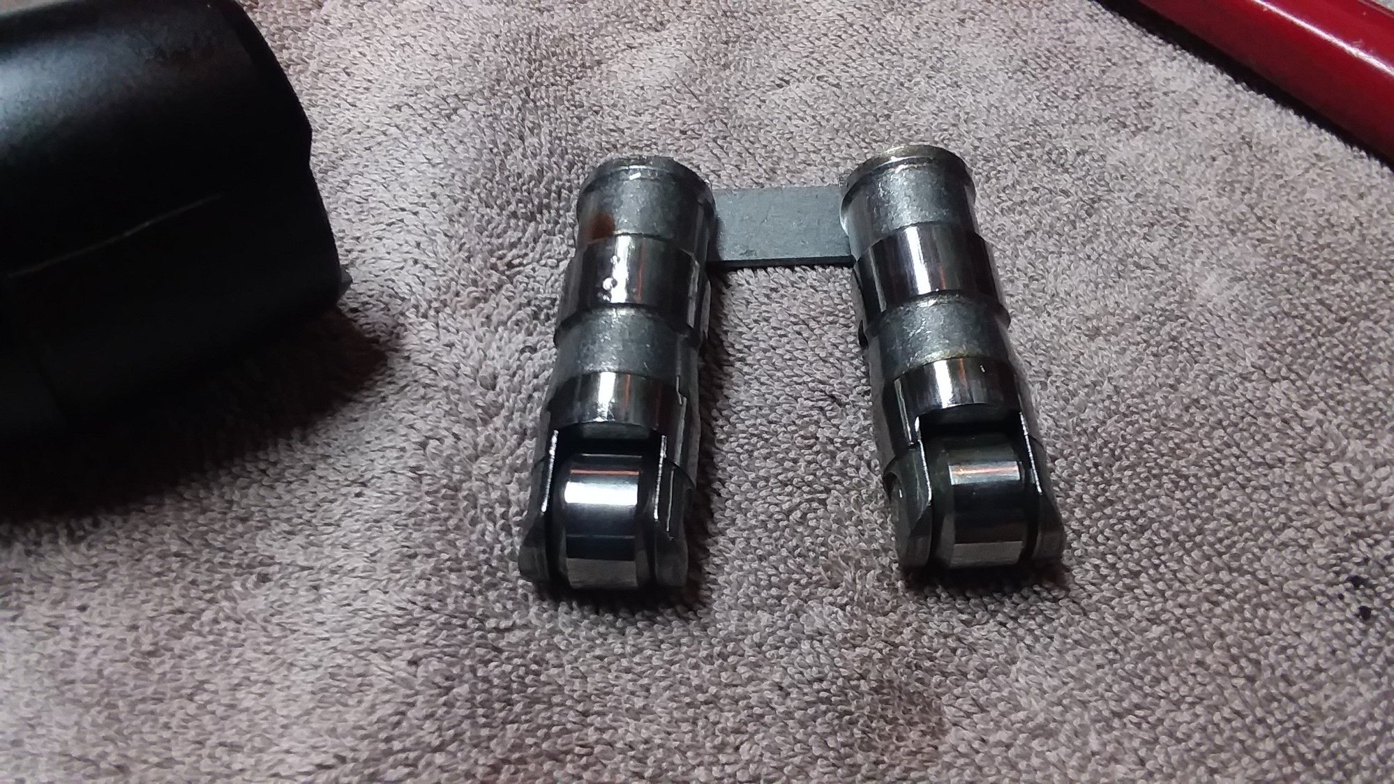

in the pic of a lifter pair on bench ... the one on Left (I think intake cyl #2) ... I think that's same one that had wedged PR tip ... its oil band appears either wet w/ sweat or dinged up.
To Now I have a broken pushrod
Maybe I should just replace them to be sure?

If it's liquid, simply clean it off ... but ...
... if it's beat up ... replace.
