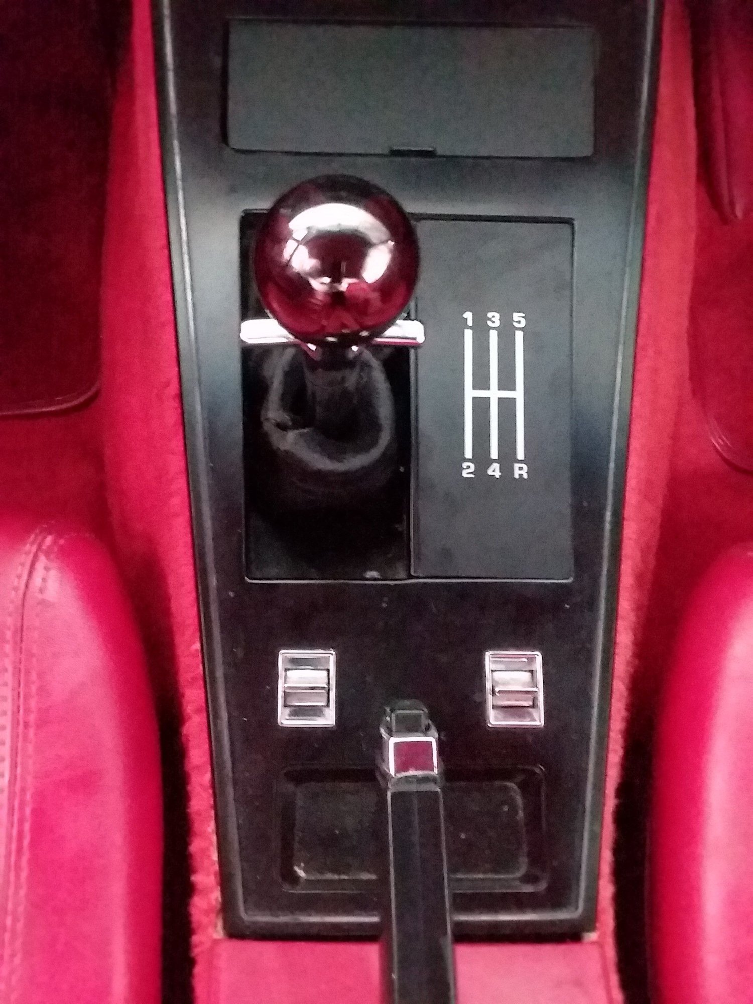

is it a real 5 speed or did he just sharpie an extra gate and write 5 on the ball?
No, I actually saw the transmission come out of the box from Silver Sport.
at least this is right
