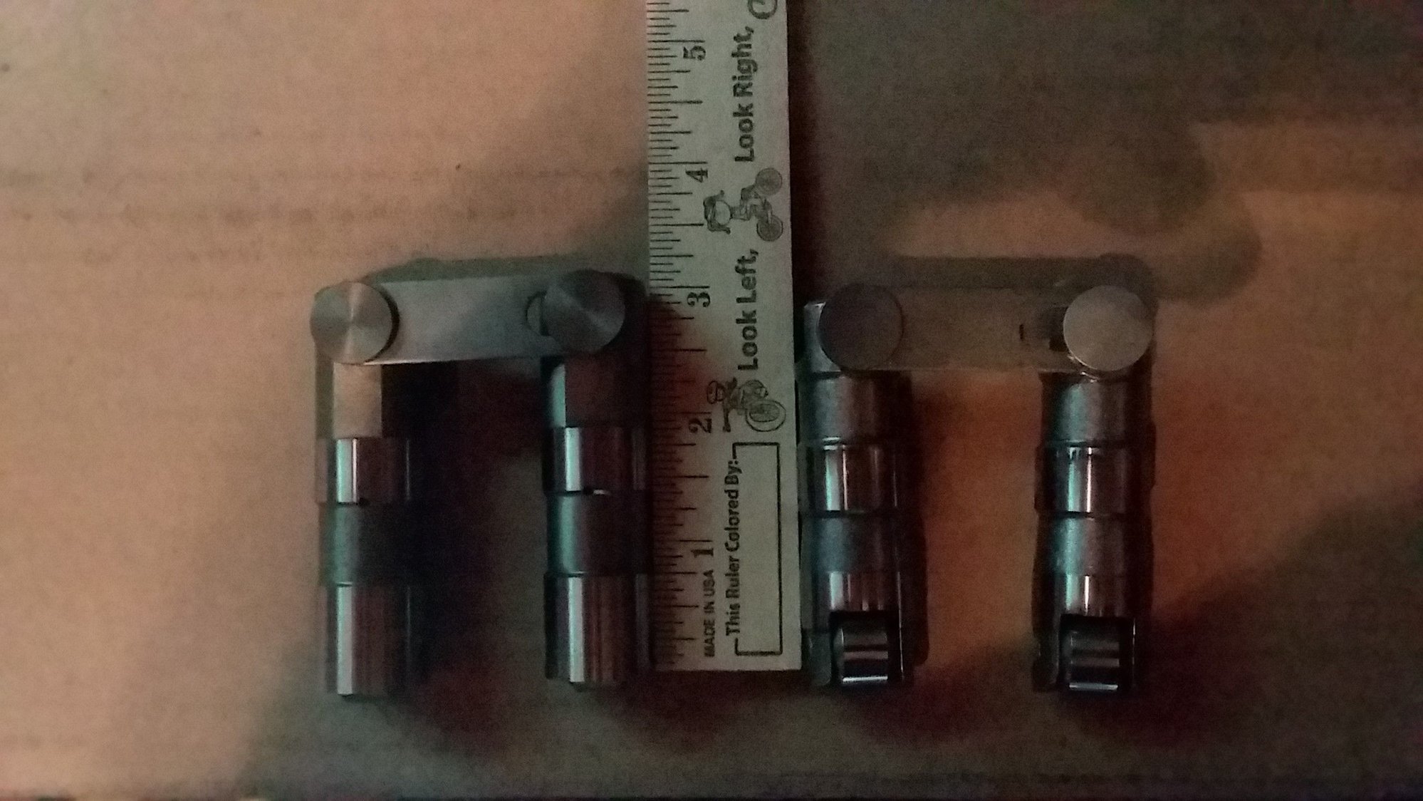

Lunati lifter on the left that I paid for, the one on the right is what I got. Holeeee cht.
Lars is right about the level of disappointment from folks like me who lack the skills to do serious work. Now I'm worried that it's not a Lunati cam, either. I have disassembled down to the water pump, maybe I can go one step farther and pull the timing cover. Lunati rep says the "Lunati" stamp and part # will be visible without actually removing it from the engine. I just have to remove the top sprocket. At this point, I ain't gonna tear it up any worse than it already is. Good grief.

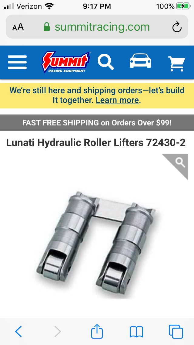

I ordered the Lunati lifter from Summit to replace the lifter damaged by the broken pushrod. Obviously it's not the same lifter that the shop installed in the engine. It's a hydraulic roller. I paid for Lunati and got something else. I would have never known if the engine had run right to begin with so maybe it's a good thing.

I would sen the pics to Lunati and see what is what. Maybe they are both Lunati, someone is going to be giving you something
I sent pics to Lunati, he said It's not Lunati or Comp either. He doesn't know what it is, but it's definitely not Lunati, which is what I paid for.

Am I wrong? I think I see a Flat tappet and a roller.
You keep saying "lifter" but not really saying what you think they installed? Hydraulic Roller or Solid?
I'm still not understanding your lrecent ifter picture. Are you sure you did not order the Summit lifter wrong?
Yes, they may not be a Lunati and probably generic.

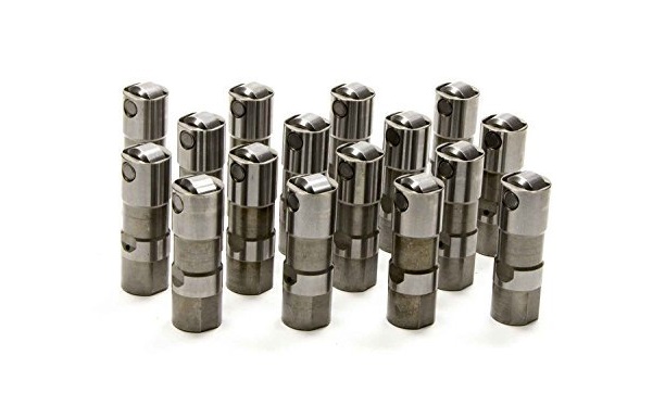

the one on the right looks like this one
but I guess it would have Lunati etched on it. So maybe not.

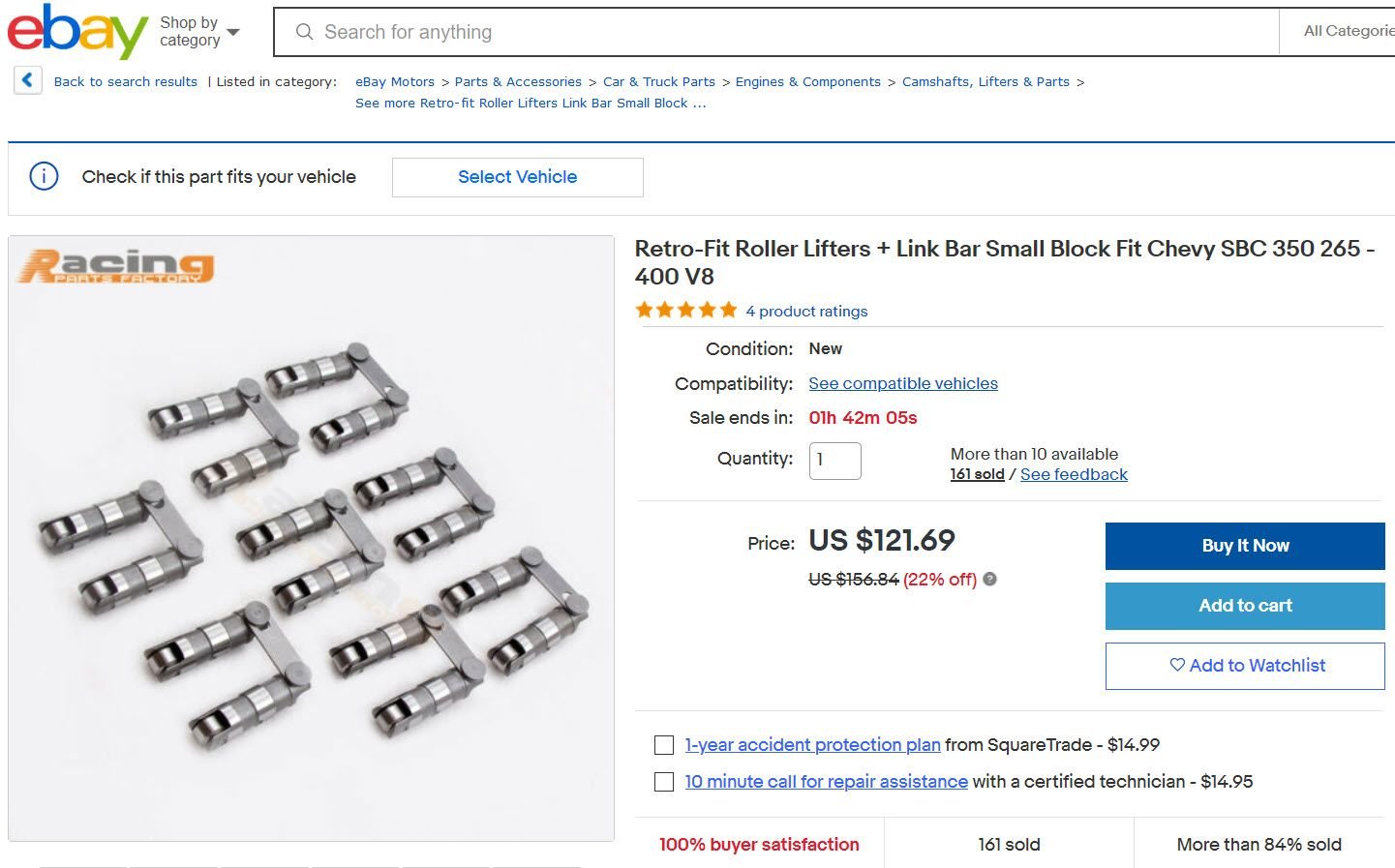

Look familiar?
To Now I have a broken pushrod

That sure looks like them.

Most hydraulic rollers "look" similar.

They're Both rollers ... the Lunati on Left has an encircled roller (like OE GM rollers are) and that is Much stronger than the failed open-wheel junk on Right ... machining for Left costs more to perform. Both are retrofit as they're paired w/ link bars.
OE sbc roller lifters aren't paired & don't use link bars ... entirely different system to maintain lifter alignment
