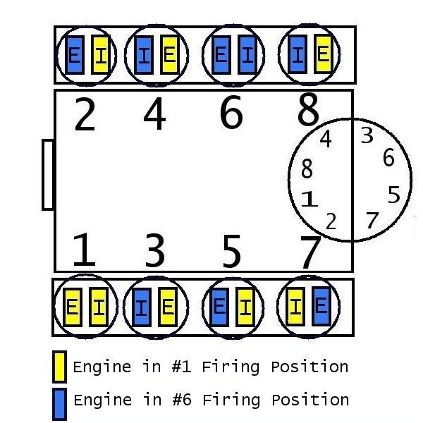

Are you adjusting #2 exhaust with the engine at TDC for cylinder #6?
https://www.jalopyjournal.com/forum/...valves.168345/

If #2 exhaust is not sitting on the base circle of the cam you will have the pushrod extending further. See my post above #7 in thread.

No, I am adjusting #2 exhaust intake with #1 at TDC according to the depiction I have.
I just realized it's not the exhaust valve, it's the #2 intake valve with the problem. Sorry. Good thing I don't try to make a living doing this.

To clear up any confusion, it's the second valve back on the #2 cylinder which is the intake and I have the engine set at TDC for cylinder #1.

I interpret the point as being .., don't adjust any valve unless-until verified on base
