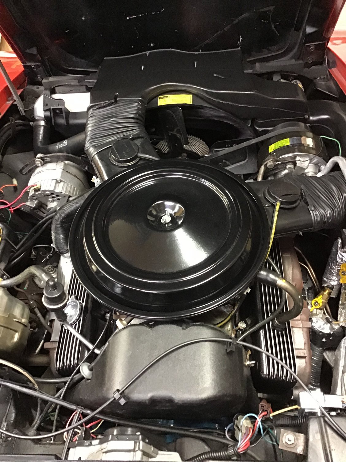

If you are speaking of the L-82 78-80 dual snorkel with the front airbox.....it is hands down the best thing to bolt onto a C3 Vette small block.....it is also the ugliest.
The L-82 unit moved plenty of air and it was much cooler than inside the engine compartment......
Myself...I have an 11" K&N open filter top deal that fits up in the L-88 airbox......I can see it through the back of the scoop.....it is not sealed but that is for another day.

see link in post 3 ..done on temperature study including L82 full throttle second snorkel opening...and yes L82 79..surprisingly hot in engine compartment..ugly..maybe but does hide other uglier stuff on mine
Video also of full throttle actuation

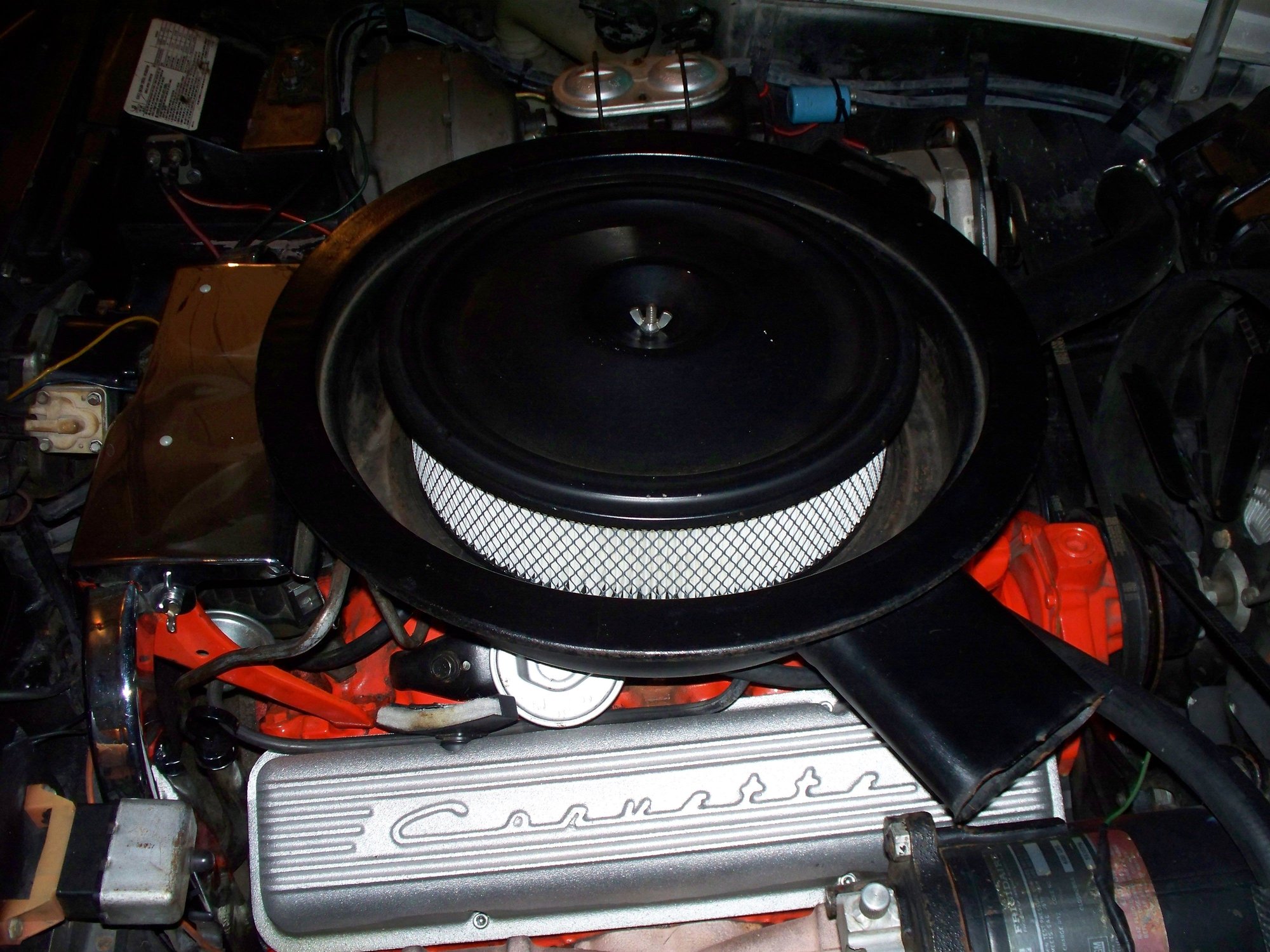

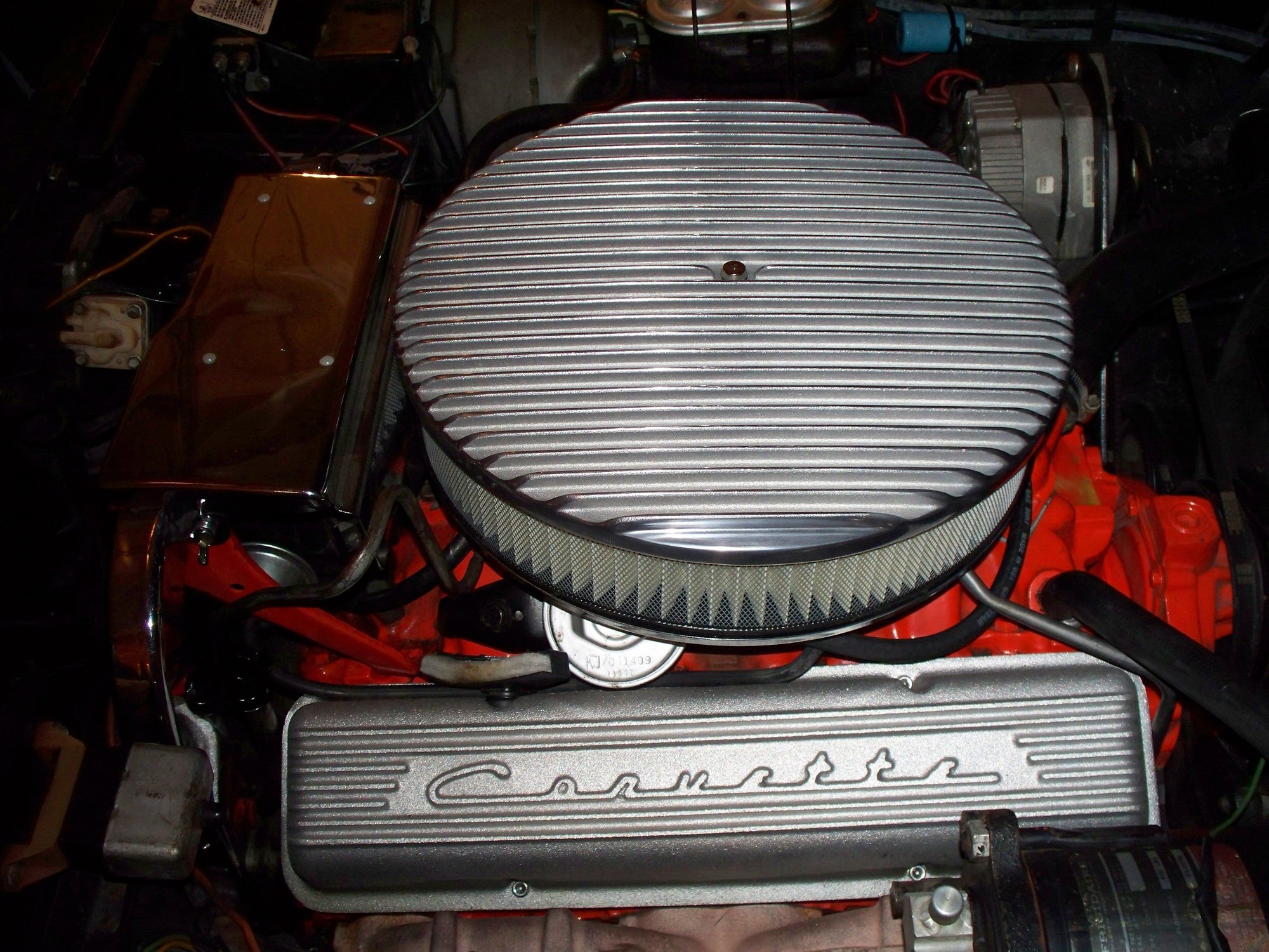

Not trying to hijack or anything here but while this topic is in discussion I might as well ask here. I have purchased this dual snorkel air cleaner to put on my 74 and am considering cutting out the now sealed dual hood scoops and using them for forced CAI.. does anyone have any thoughts on this and why it might be a bad idea? I dont drive the car in the rain but figured I could incorporate some form of drains to prevent that from being an issue.

I think that is a great idea!
I would not worry about water ingestion unless you submerge the car. It would take extremely large quantities of water to hydro lock the engine.
Think about airplanes with piston engines in rain going 150 mph or more. They don't have an issue and ingest a whole lot more water during rain than your car ever will.
So those NACA scoops are currently non-functional? If you hook up the CAI to them opening the hood may be a challenge. Then closing the hood making sure the hose does not come into contact with the exhaust manifolds or belts/pulleys and cause issues there.
Might want to see if you can get the air from the wheel wells, which would require some cutting.
Or you could run it back to the wall in front of the wiper tray and tap in there. That's where I got the additional cold air for mine. Benefit is you get a little ram rise there too. The base of the windshield is a high pressure area.

I would tend to say just the opposite. There is a greater difference in the street driven car since it averages slower speeds and sits idling at lights allowing for under hood temps to rise to a greater degree than a vehicle moving at high speeds.
because im a gluten for punishment I and converting from an open element to a dual intake CAI myself to prove to myself theres no great difference for a street car.
