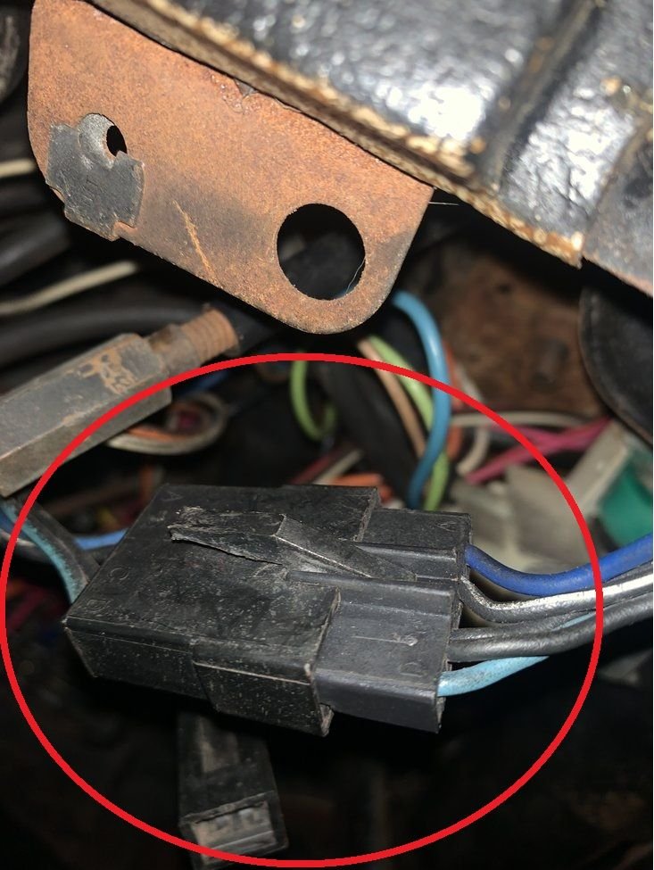

This connector is for your wiper switch, see the Dk.Blue wire?
That is the broken wire at your switch and it goes to your washer fluid pump
honestly I can live without the washer pump but the brights.. that’s my concern.
The broken wire at the switch is just a ground path to the pump, so there is no power going through it anyways, just tape the end.
i tried. I stripped a wire and extended the connection from the blue wire but it won’t connect to the other wire end because there’s not enough copper.. something idk.
