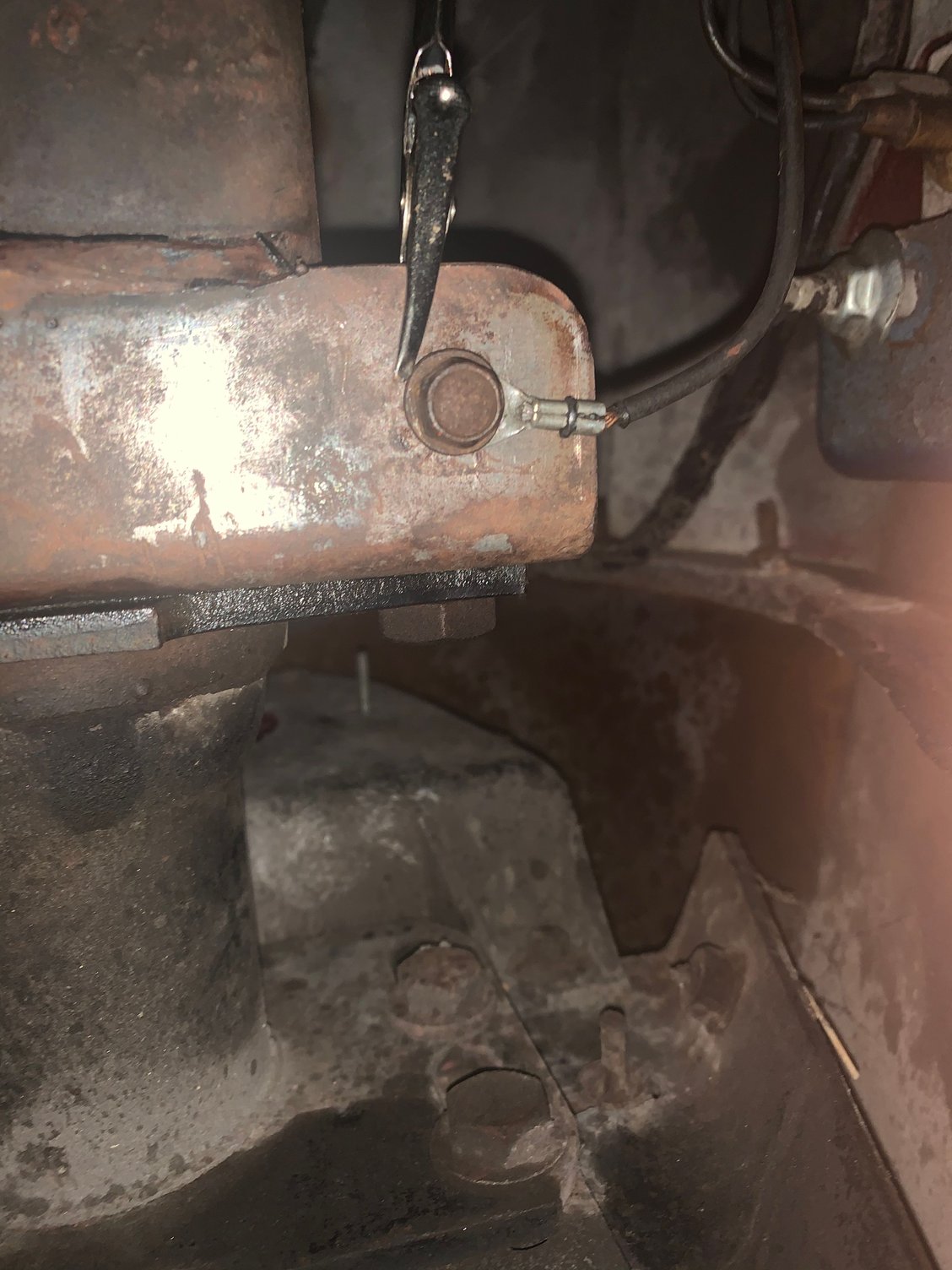

Originally Posted by fishingfooltim
I had the same problem on 1979 vette and cleaning the rust off at that ground solved it.
This is the only rear ground I could find
These are the 2 grounds in the front by the headlights, I have them on top of eachother because the screw for the original ground was broken.
Cleaned it up a tad bit. Still didn’t fix the issue.

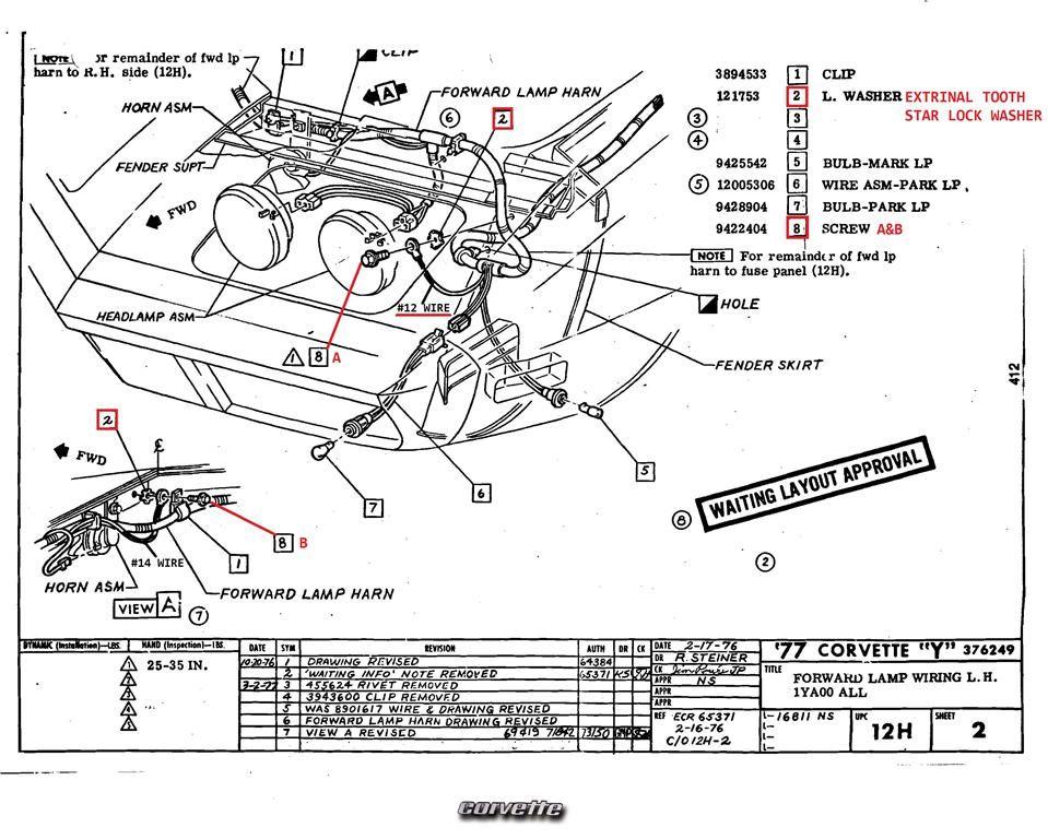

The bolt that broke off when you replaced the FLH should have bolted to the LH fender support area.
That support should be bolted to the main chassis and would be your common ground path.
Where you bolted the 2 ground wires to the center support may not be the best place for the larger #12 ground wire. I could be wrong...
Is there any chance you could drill a new hole near the broken off bolt so you can put that wire back close to it's original location?
ALWAYS WEAR SAFETY GLASSES!!
It is important that you purchase the correct external tooth star lock washers as they bite into the metal as they tighten.
If you choose to try this take the center bolt out to match and drill the same size new hole.
Match the same size for new bolt, nut and star lock washers for the new hole.
So you would be using just a bolt nut and the correct star washer to secure that #12 ground wire eyelet.
Also, you want the lock washer installed just like the diagram shows, against the metal.
This is why the Assembly Manual is a MUST!!!

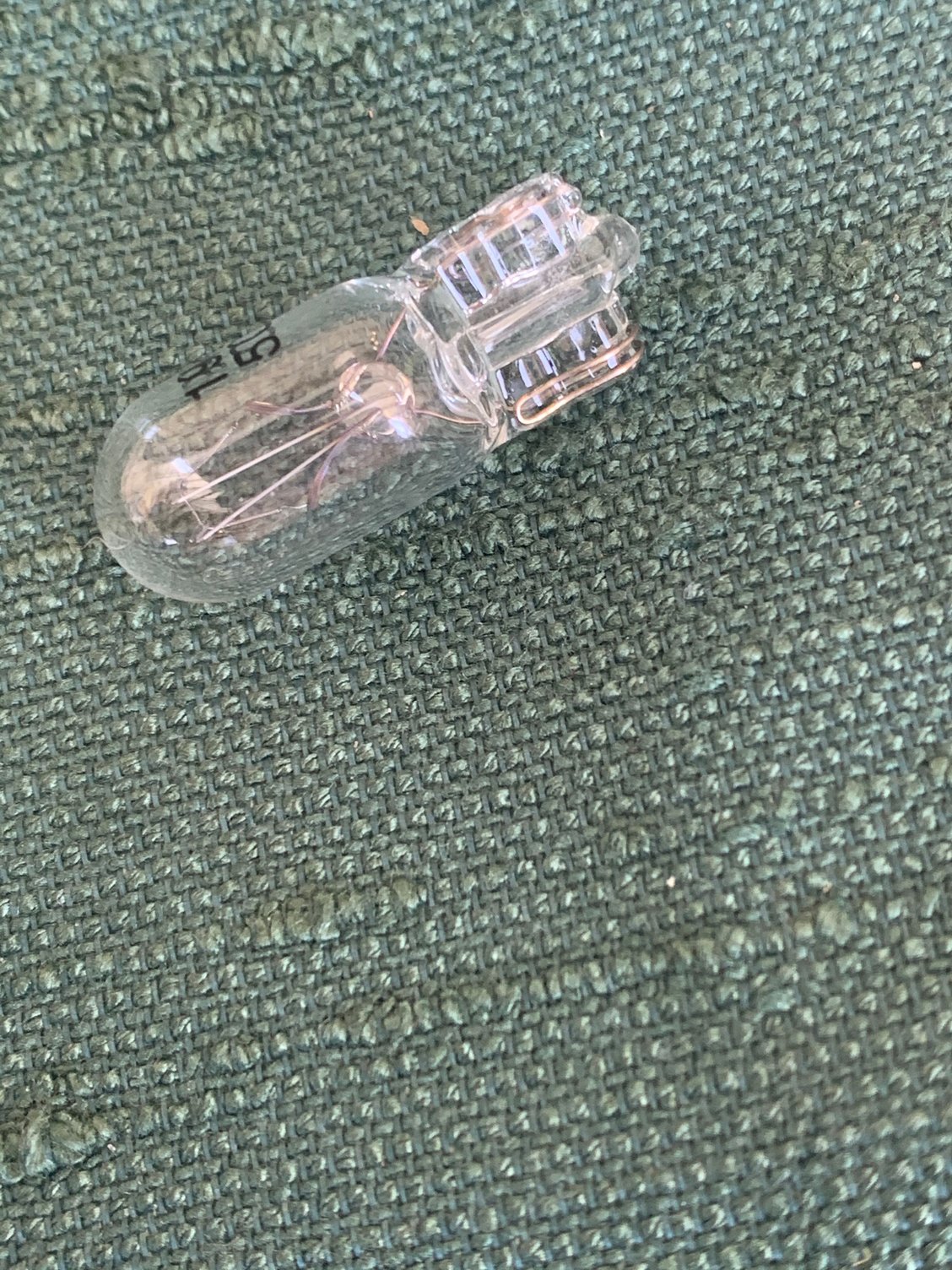

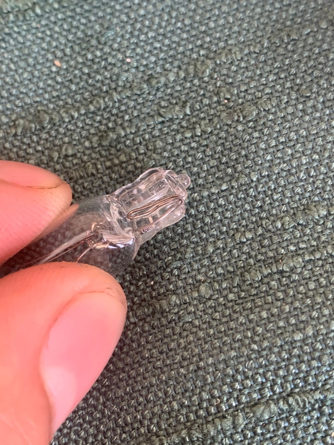

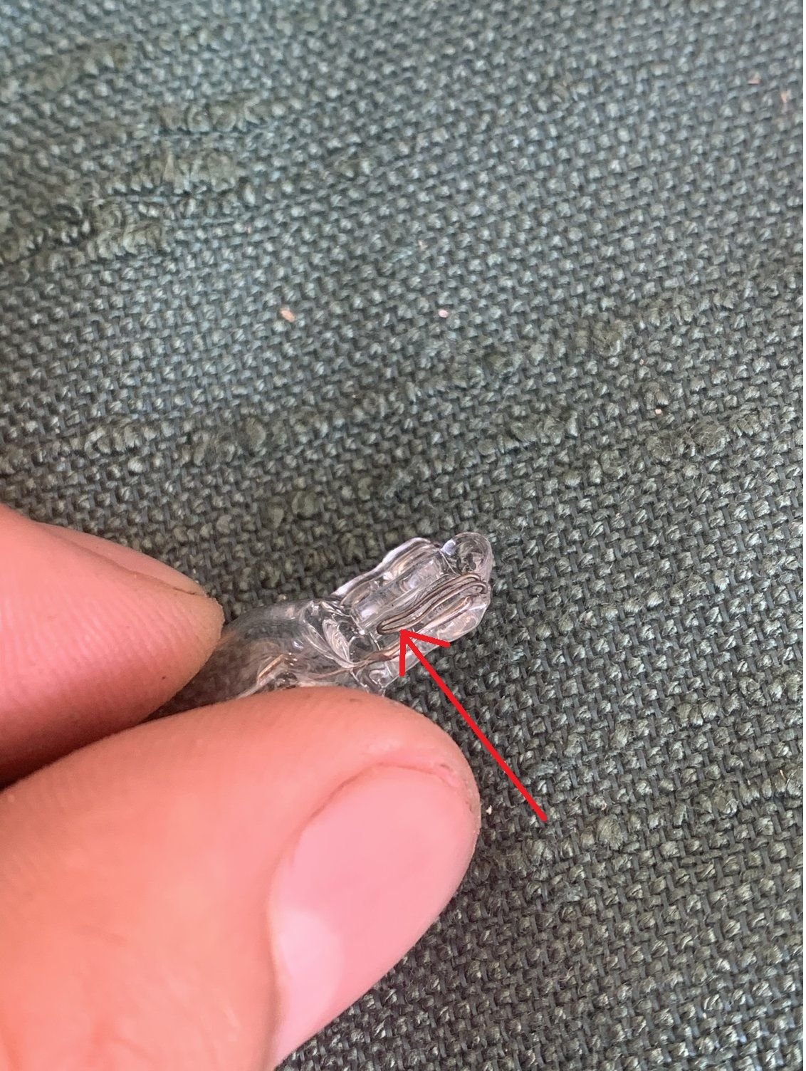

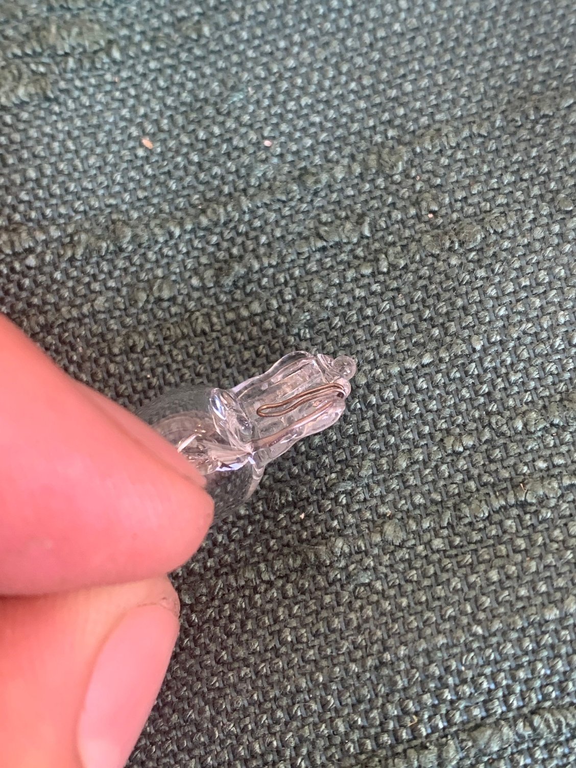

Like in your other thread, you must make sure the little loop wires on the front side marker lights (bulb #168) are pulled away from the glass.
If it's a used bulb and even a new bulb I'm replacing I always bend that little loop wire out a little.
They MUST make a good contact inside the socket.
Again:
I think your close to resolving your turn signal problem.
It's just like Ukjohn said it's about current flow and if these loop wires are not making good contact that will do it.

Yes I understand, It's when you turn your headlights ON is when you have a problem.
To be clear, your rear side marker lamps (RED) never flash when the turn signals are on, just the front (AMBER) side marker lights flash.
You can see on this drawing that the current flow is different (circuit #9) when your headlight switch is pulled.
That's why it's critical that the side marker lights and front turn/park signal light bulbs are making good contact and are the correct bulbs side markers #168 and turn/park #1157 .
Also you know the ground wires are good because you have been there and the results are labeled below.

I use a very small screwdriver and lift the loop wire up just a little on each side.
