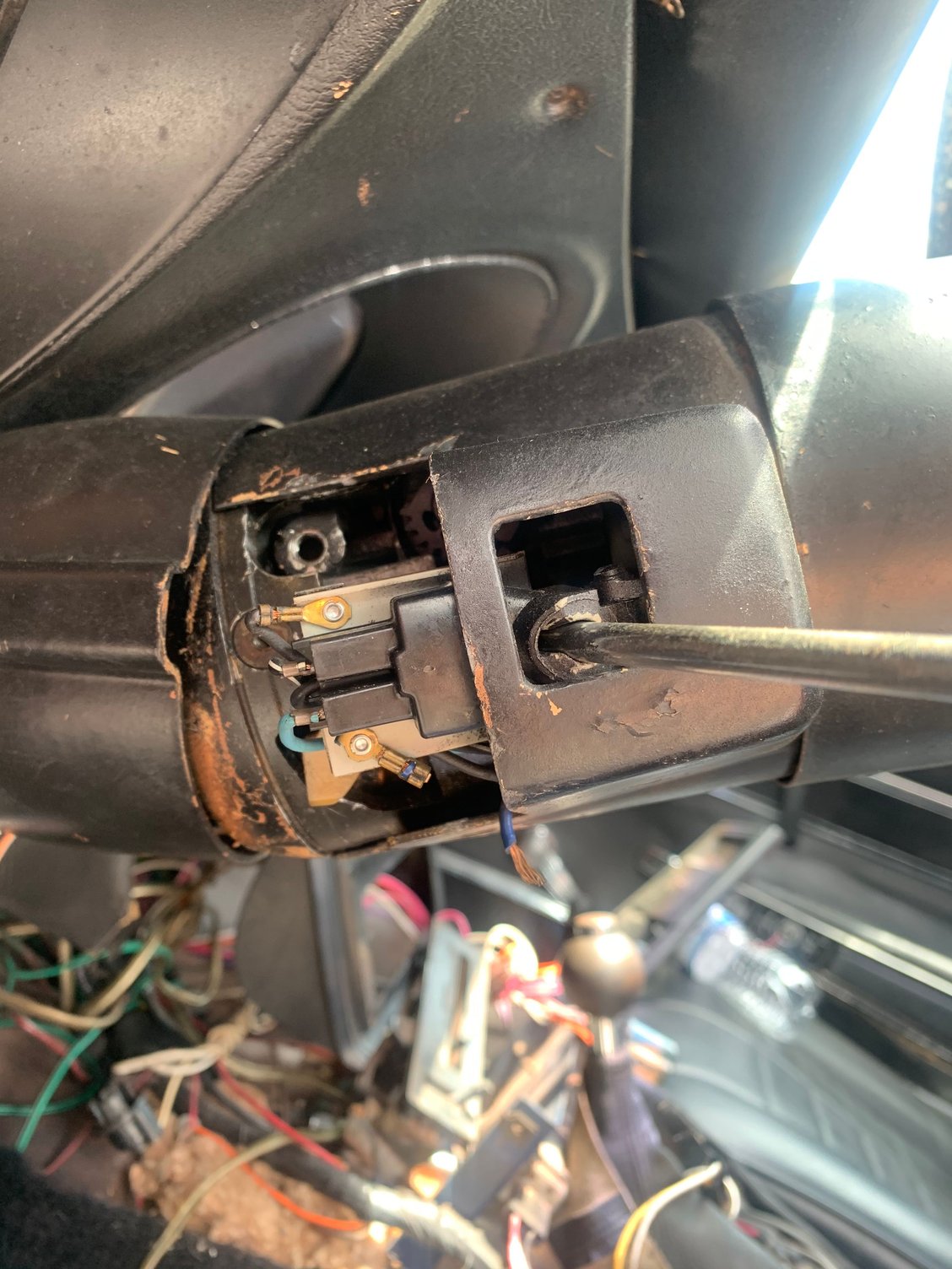

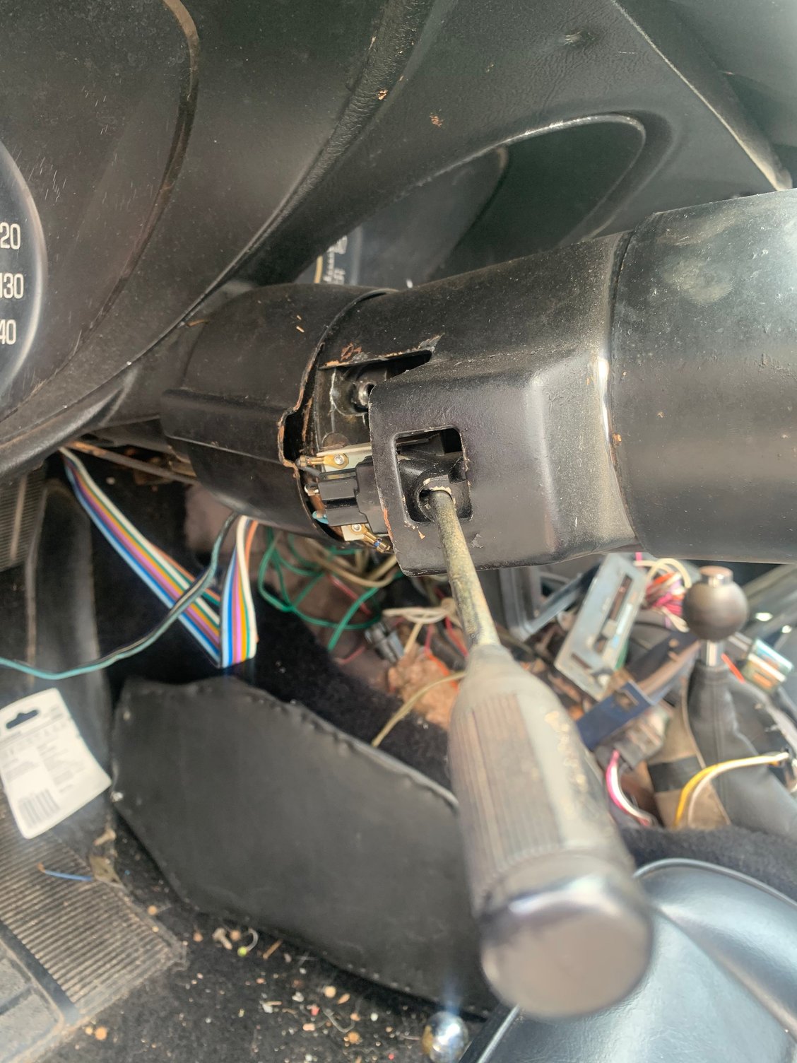

Take a photo if you can of that part that is broken...

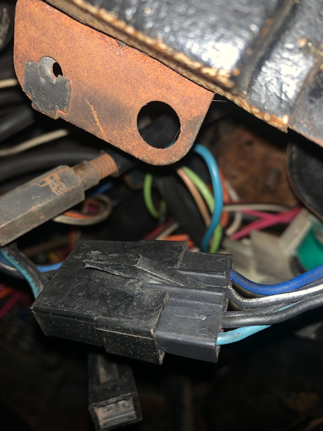

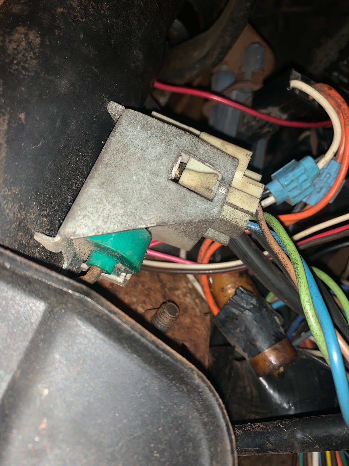

Also, if you climb under the dash on the steering column you will see a couple switches.
One is dimmer switch left side. Press the spring loaded button where the red arrow is pointing, see if High Beams go out.

Originally Posted by bmotojoe
You talking about the pivot bracket of your wiper switch?
So the turn signal arm just flops around correct?
God you’re a ******* genius.. yes, yes it flops around but also the blue wire is ripped apart.. and I can’t fix it.
I’ll take a pic tomorrow.. I’ve been up for about 20 hours now buddy.. I’m working 3-11 central time
Old Jun 8, 2021 | 09:47 PM
  #67
bmotojoe's Avatar
bmotojoe
Joined: Oct 2007
Posts: 4,380
Likes: 1,742
From: Seattle Area Washington
It looks like you have a tilt-telescopic steering column or T&T column. The 1977 is a 1 year only wiper switch both T&T column and standard column.
To me it looks like the pot metal pivot bracket has broken, it is the weak link in this design.
All is not lost, if the wiper switch portion of the switch functions, low speed, high speed the broken pivot bracket can be replaced.
GM used this style bracket on many different models, with a simple modification I can make a replacement bracket work to repair your switch.
Save you about $400-$500 for a NOS 77 wiper switch.

Did you try crawling under the steering column left side and push the dimmer switch in to see if low beams come on?
Unfortunately im still at work.. its currently 9pm Central time and i get out at 11. I took a couple of pictures before i took off to work and posted this at work lol
when i get home ill look under that crammed hole, can I get a little more detailed image of what im looking for?

So i found a video explaining the dimmer switch so im assuming if i follow that thin loose (probably broken) metal stick ill find the dimmer switch..

bmotojoe's Avatar
bmotojoe
Joined: Oct 2007
Posts: 4,380
Likes: 1,742
LINK:https://www.ebay.com/itm/26486465605...4AAOSwaU1fUYcf
Scroll through the phots on that link.
See that round green round button? Your button may be a different color, all the same
Press the green button in, it may be stiff to press in but when you hear it click the lights should change from all 4 to just 2
There will be a metal rod in the very center hole of that button so make sure it remains there....
metal stick,,,lol

bmotojoe's Avatar
bmotojoe
Joined: Oct 2007
Posts: 4,380
Likes: 1,742
That "metal stick" if you mess it up will cost you about $300.00 IF you can find one....
6 pictured in post #64, 2 others not shown, at $500.00 a pop how many you need?
Doesn’t work..
Old Jun 9, 2021 | 01:28 AM
  #79
bmotojoe's Avatar
bmotojoe
Joined: Oct 2007
Posts: 4,380
Likes: 1,742
So you pressed that green button in, heard a click and the headlights didn't change from all 4 to just 2?
Old Jun 9, 2021 | 01:30 AM
  #80
bmotojoe's Avatar
bmotojoe
Joined: Oct 2007
Posts: 4,380
Likes: 1,742
It looks like the button might be stuck in, see if you can get a screwdriver in between the plastic button and the metal switch frame and push it back towards the steering wheel,,,gently
