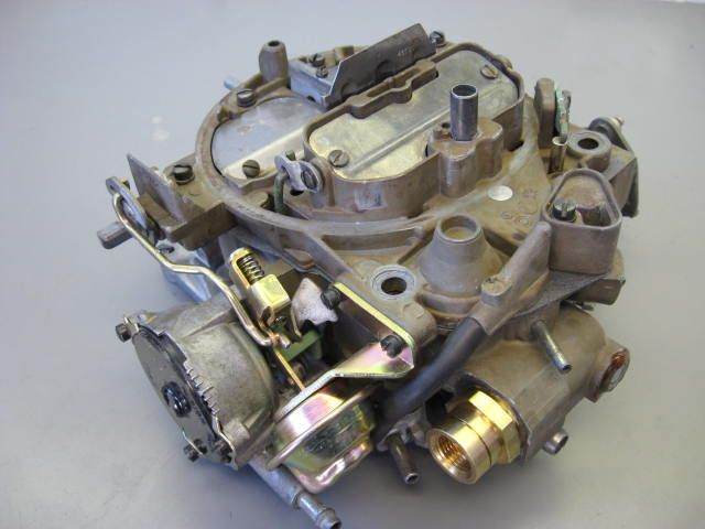

You need to get a qjet that works on a 78 Corvette. Do you know what car that carburetor came off? . A 78 will look like this:

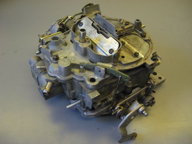

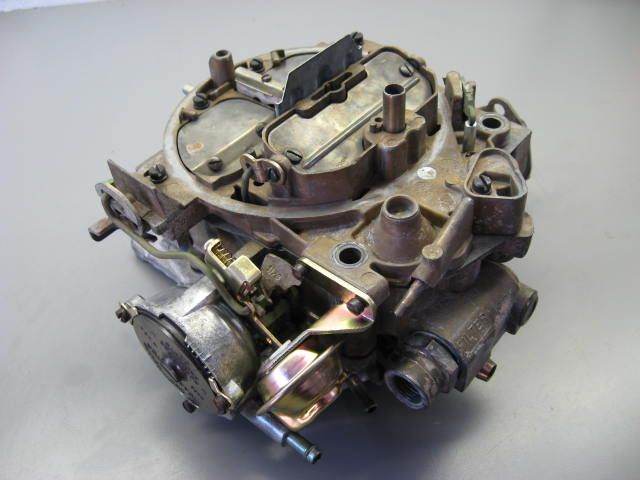

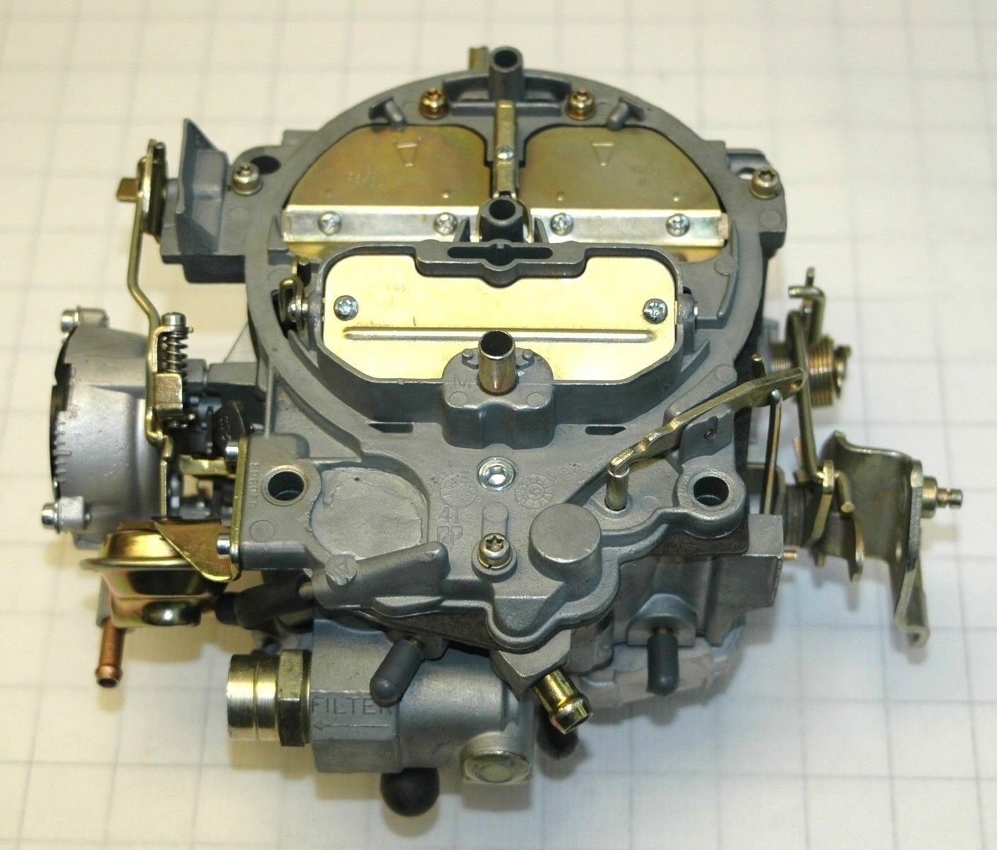

That's correct. In 1978, the Q-Jet on the Corvette was changed significantly from the 1976 - 1977 Q-Jets by adding the large EVAP nipple in the front of the float bowl. The carb you have pictured is a pre-'78 carb that will not directly swap onto your '78 engine without significant modifications.
1976 Corvette Q-Jet. No vacuum nipple at the "B" position, and no large forward bowl vent for the EVAP canister (carb pictured has not yet been outfitted with the vacuum hose to the choke pulloff):
1977 Q-Jet. The "B" vacuum nipple was added, but still no 3/8" forward bowl vent for EVAP:
1978 - 1980 Q-Jet with both the "B" vacuum nipple and the large 3/8" forward bowl vent tube for hookup to EVAP. Hot air choke was changed to electric choke in 1980:
