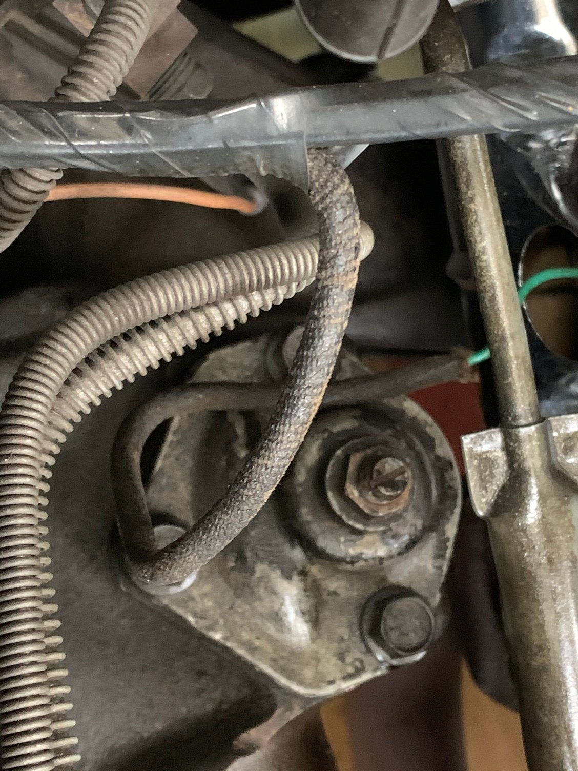

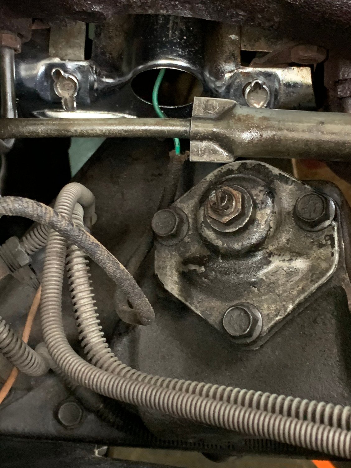

Update: Thanks to all for the advice. Problem fixed. The OHM line(I think that is what it is called) was not connected to the temp sending unit. Was kind of a pain taking the cover off to be able to plug it it; BUT all is good. Thanks again. You'll see another question as I went to replace coolant...

Mine is is a green wire that runs from the gauge thru the engine wall and along the drivers side in the engine bay and plugs into the temp sending unit which is on the drivers side of the engine. There was a silver aluminum cover(maybe header cover?) that I had to take off (pain in the butt) to be able to reconnect the wire. My cover was held on by silver wingnuts. I’ll take a few reference pictures this morning and post them.
