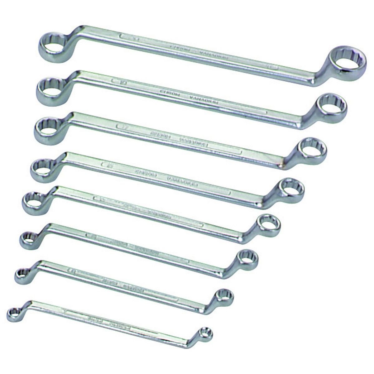

Also, a set of offset box-end wrenches might save you some time.
