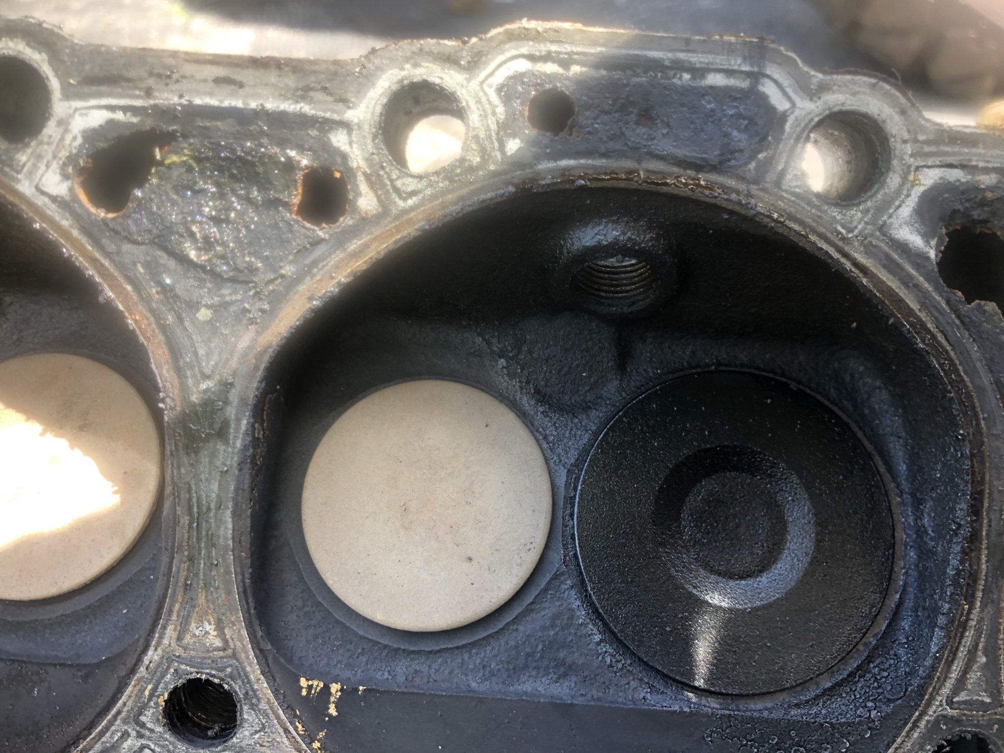

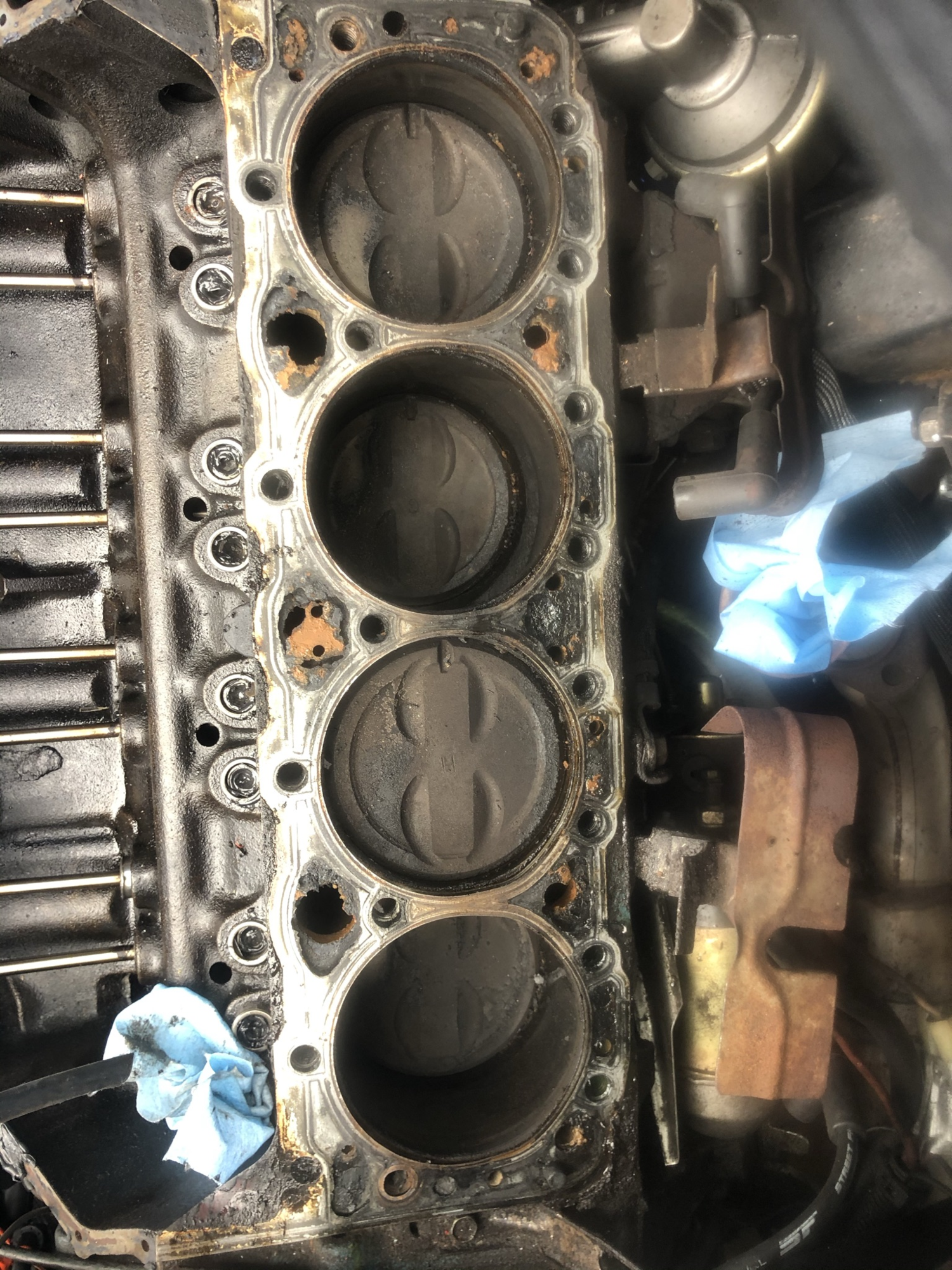

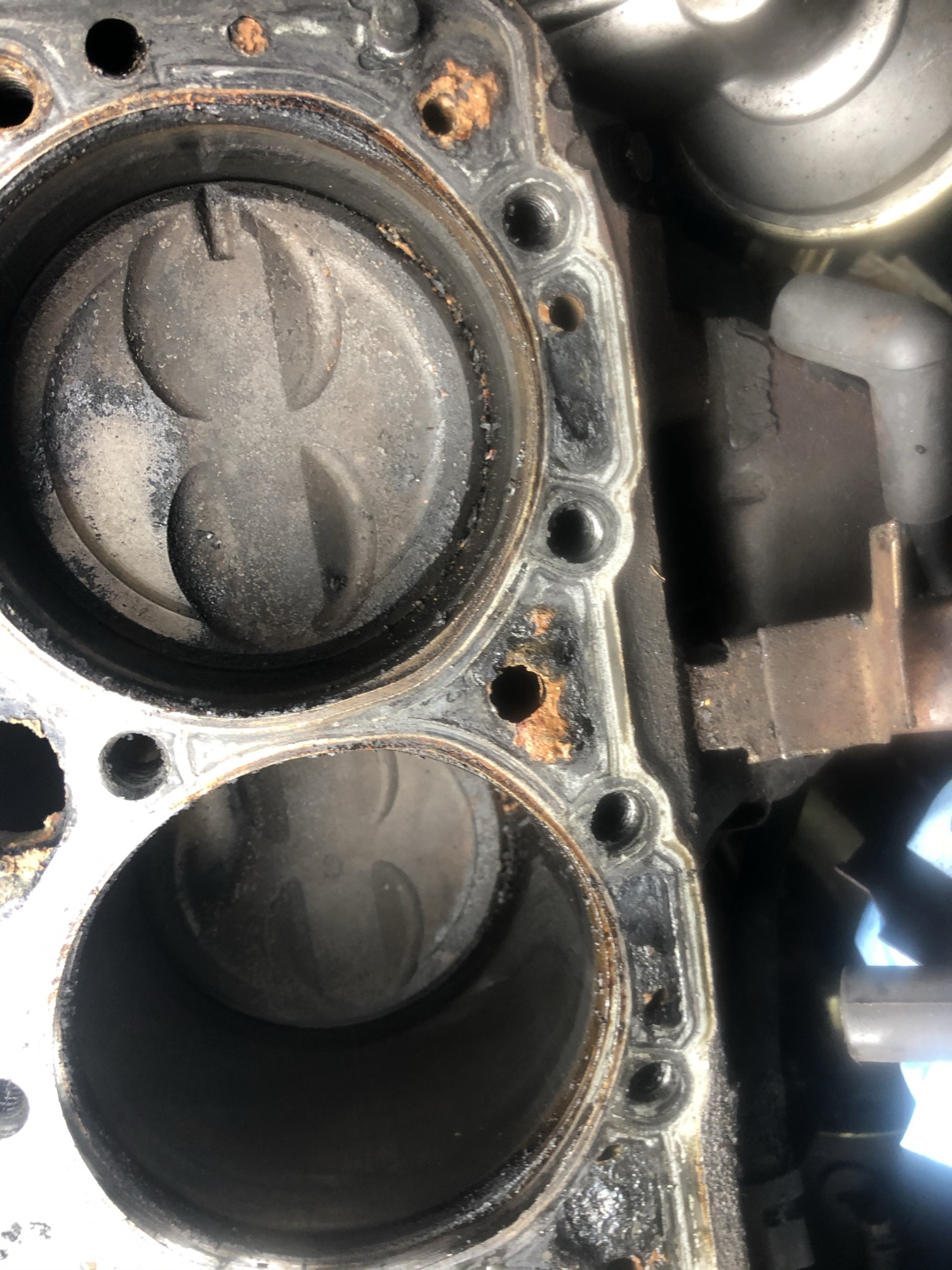

I agree the intake change shouldn't have done anything. I changed the lifters as well. Haven't leaked tested the valves yet. what's your take on having it machined? pretty bad shape from I can tell.
Old Apr 5, 2021 | 08:05 PM
HeadsU.P.'s Avatar
HeadsU.P.
Joined: Aug 2017
Posts: 8,336
Likes: 2,810
From: Cool Northern Michigan

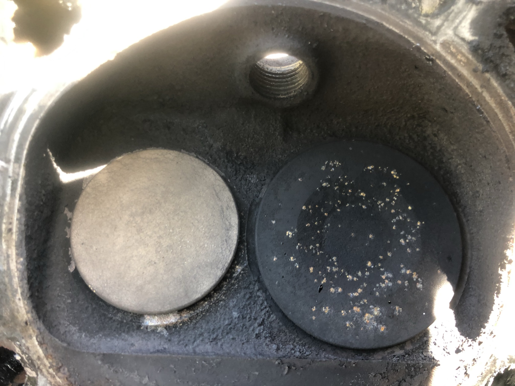

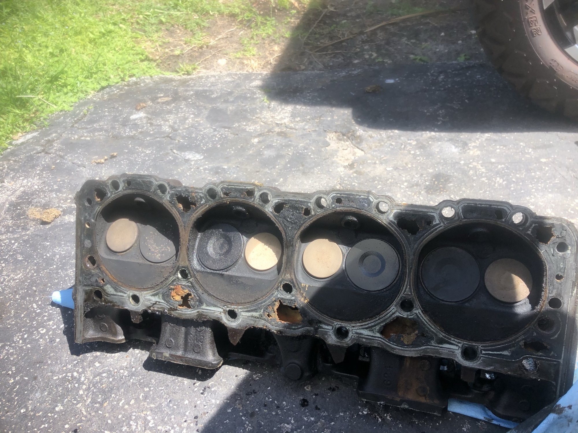

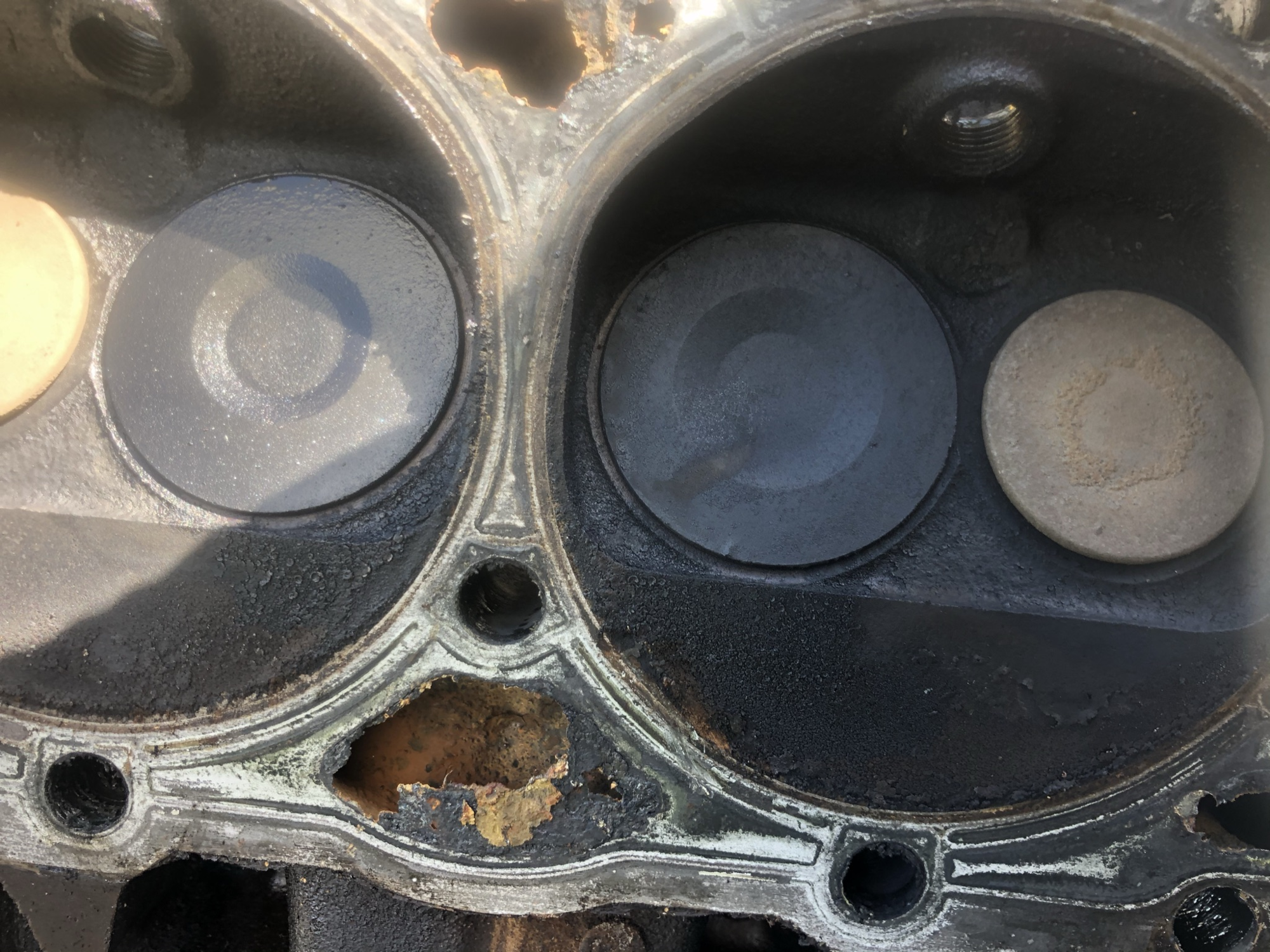

The picture with the head in front of the tire. Almost looks like the exhaust valves are not seating. But why?
A clean-up shave on the heads would help. If they are worth saving. Seldom does a machine shop let you go out the door without a complete valve job.$$$$$$$

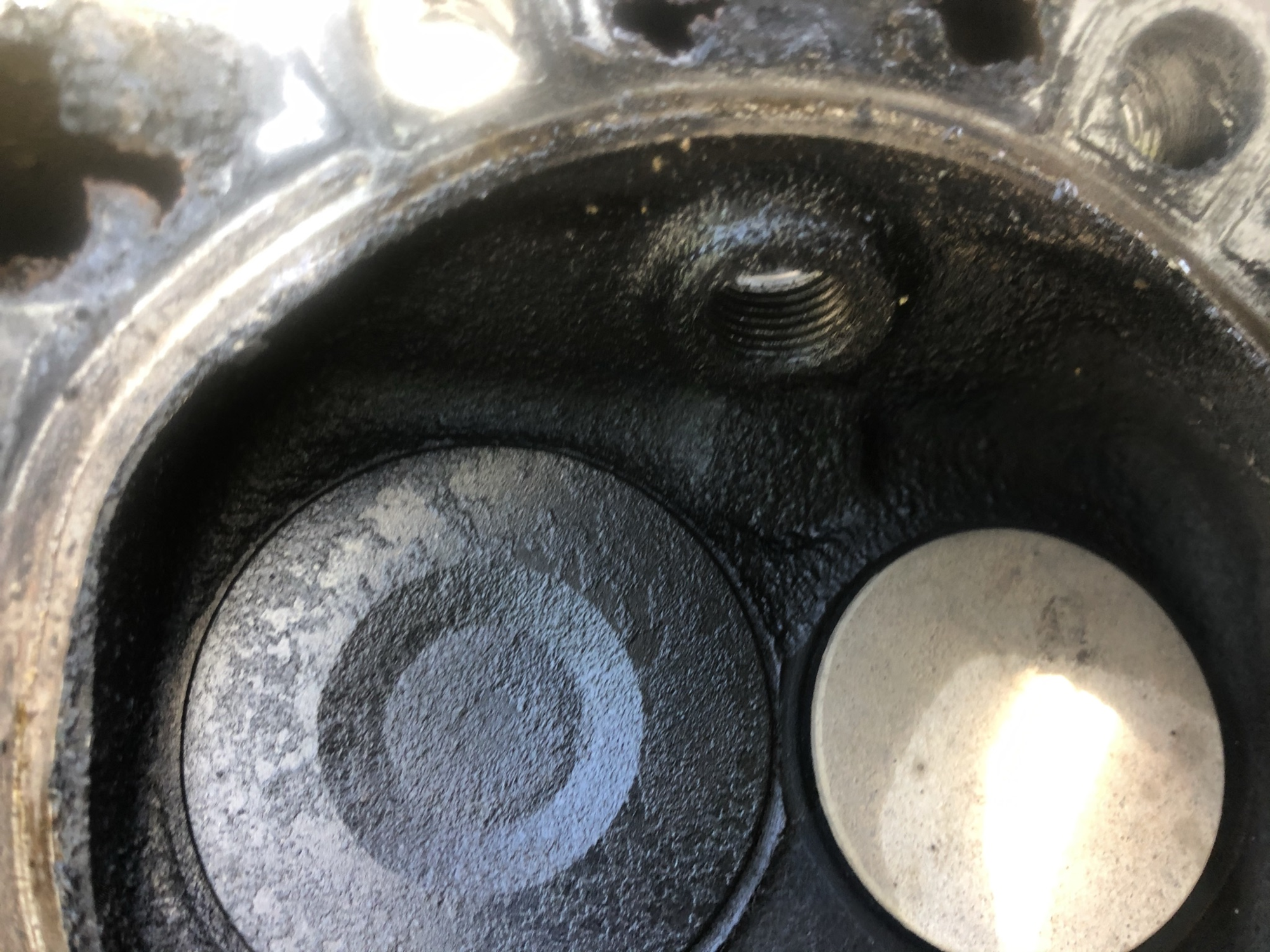

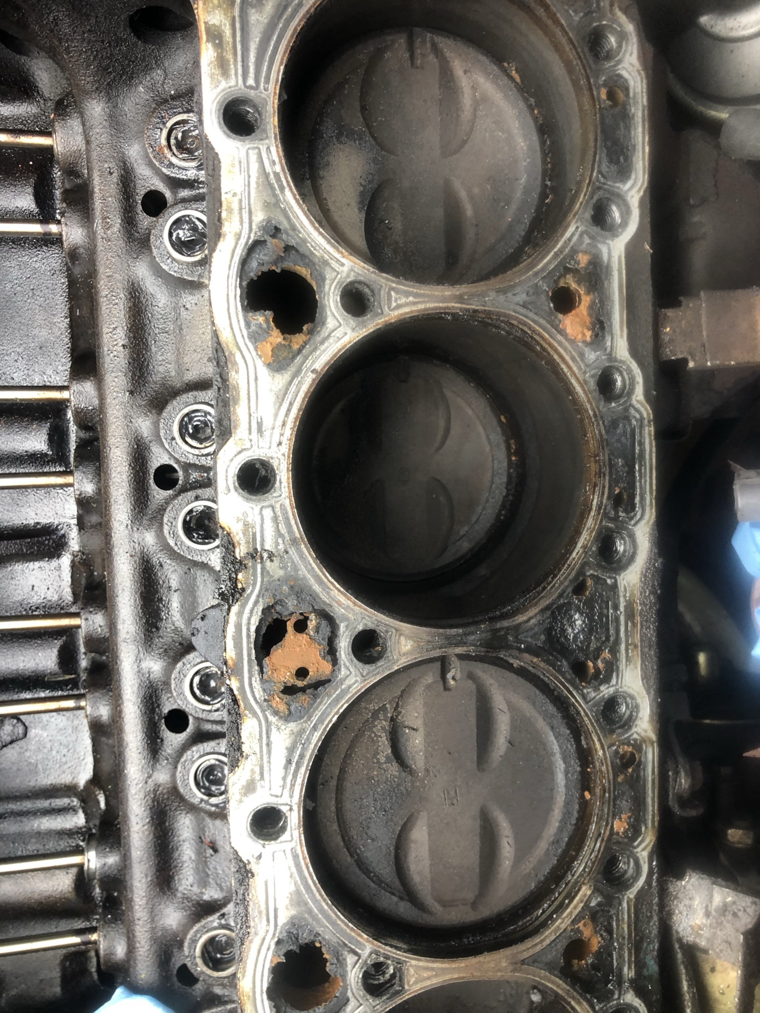

Ouch!
Insert spark plug.
Pour water into chamber on top of valves. See if it leaks out.
Report back.
Basically pics look normal from here.,

machine shop here is 1600 for the entire engine. a mechanic I don't feel is very good wants 1000 to remove it put it back in and test. Every time I use a mechanic I get screwed (coming from the guy who just messed up his own engine). The son of the owner said his dad will probably do both heads with valves for 500 if I provide new springs valves etc. He does the labor only. I can order this stuff myself and do it. But the clean up has me worried. look at that condition.

I would be hesitant to be off buying new Heads when You still don't know what the original no compression problem was or still is. Probably wasn't a need to remove the Head or Heads to diagnose what is wrong but now that You have at least flip them up side down and fill the camber with solvent and see if it all runs out past the Valve Seats.

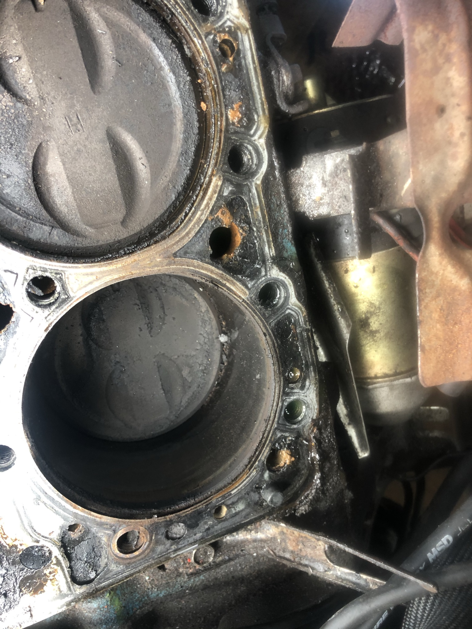

well if the heads are the issue the fix may be cheap if I replace them with those aftermarket or clean them up myself new valves etc. Once I get in there on the other side and remove that one (they need a cleaning anyway look at that pic) I'll have a better idea.

That's what i'm going to do either tomorrow or wednesday and check. I'm glad I removed it. Look at that gunk. New gasket and a nice shave is what it needs. But like augiedoggy said may be better getting new ones and some more power instead of doing this.
