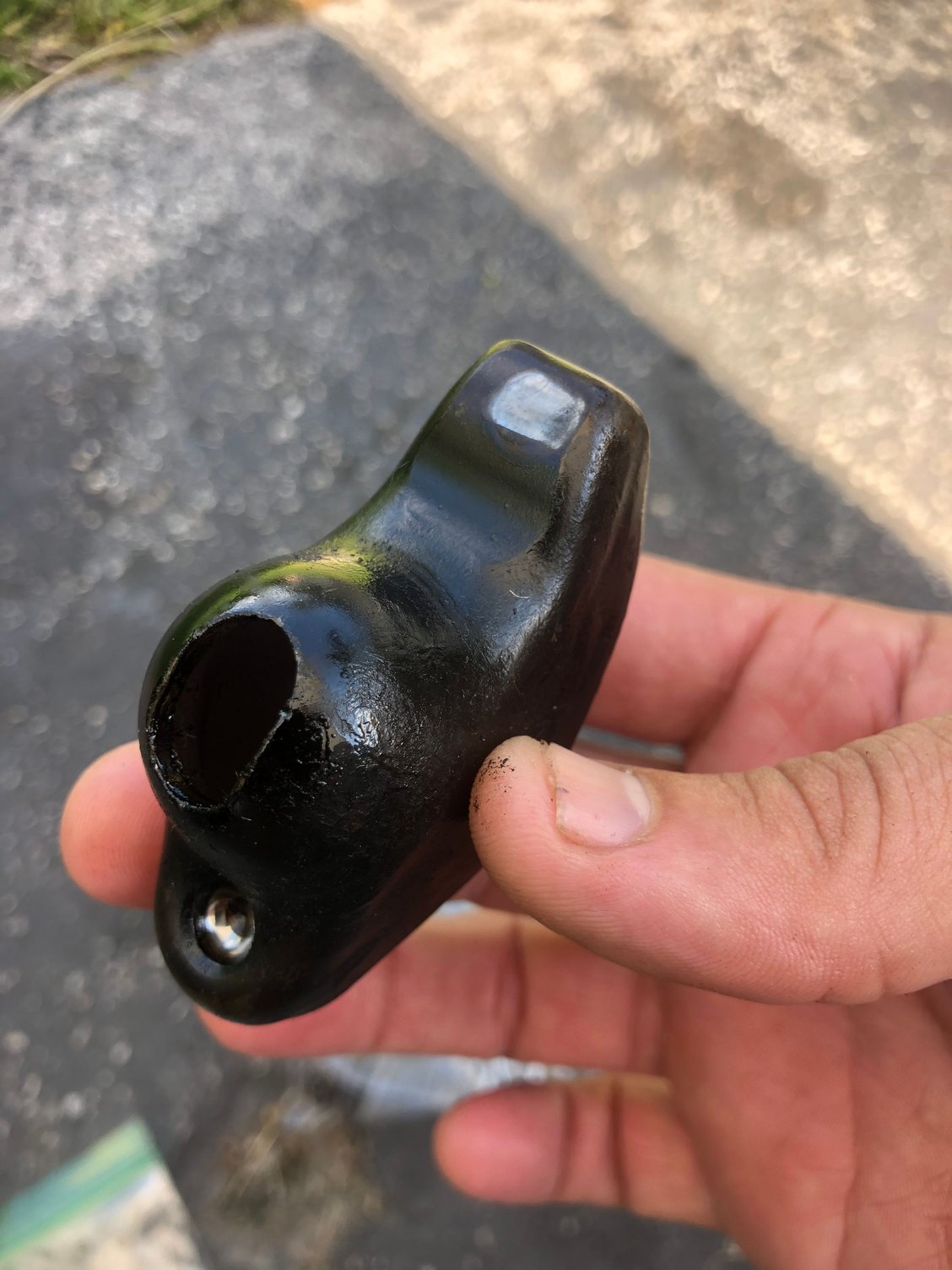

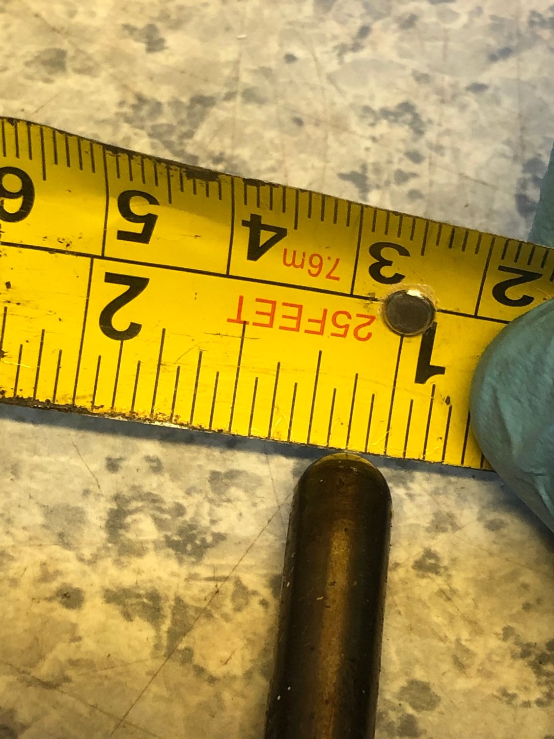

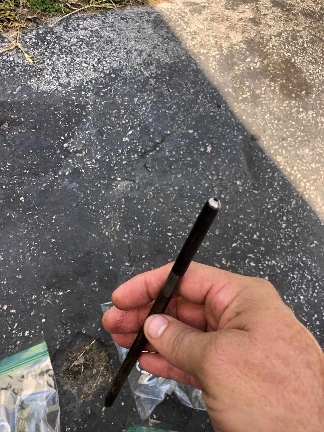

So what was the metallic sound? Are the pushrods still straight, or did they bind and bend?

yep grinding noise and loss of compression happened with old lifters. Rods and rockers are in good shape I have the pics in other thread none are bent. Used moly lube on new lifters not that at this point made a difference I just replaced them since I had it opened. Same length exactly.
beautiful

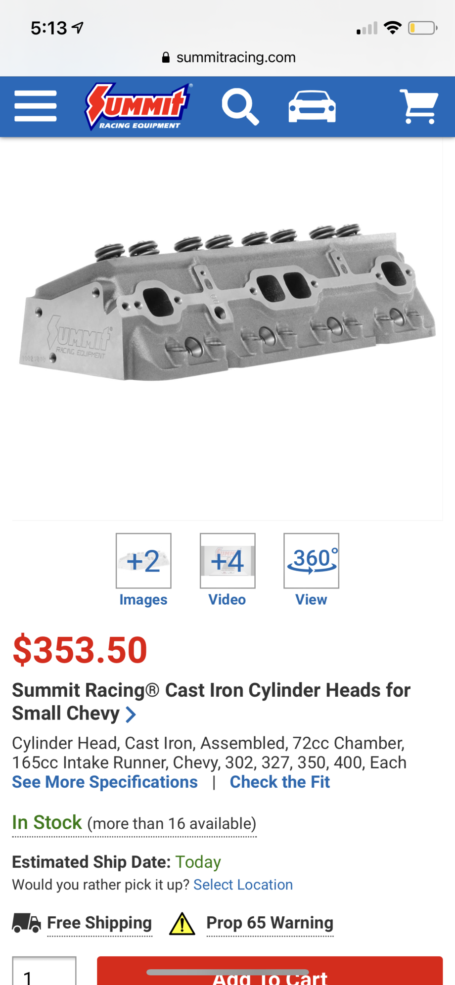

If you are asking for my two cents worth, yes I guess they would be alright for your app. Comes out to $ 707 a pair.
I see at Summit that for $ 727 a pair you can get a smaller chamber. A 67 cc instead of those 72s. That would bump the CR a little bit higher.
They got real good reviews at 4.75 stars out of 5.
What ever you decide, on after market heads, note that your old style sparkplugs will not reach anymore.
And before you install one of the heads the temp sensor port is smaller than stock diameter. A quick trip to the machine shop, drill & tap will fix that.
Is there a reason you don't want to go with aluminum?

462624 is my stamp on original heads 68cc from what I researched (assuming 67 is basically same deal). Why have the machine shop mess with the port? why not find a temp sensor that'll fit? and aluminum I never thought about. link me. thanks heads up as always.

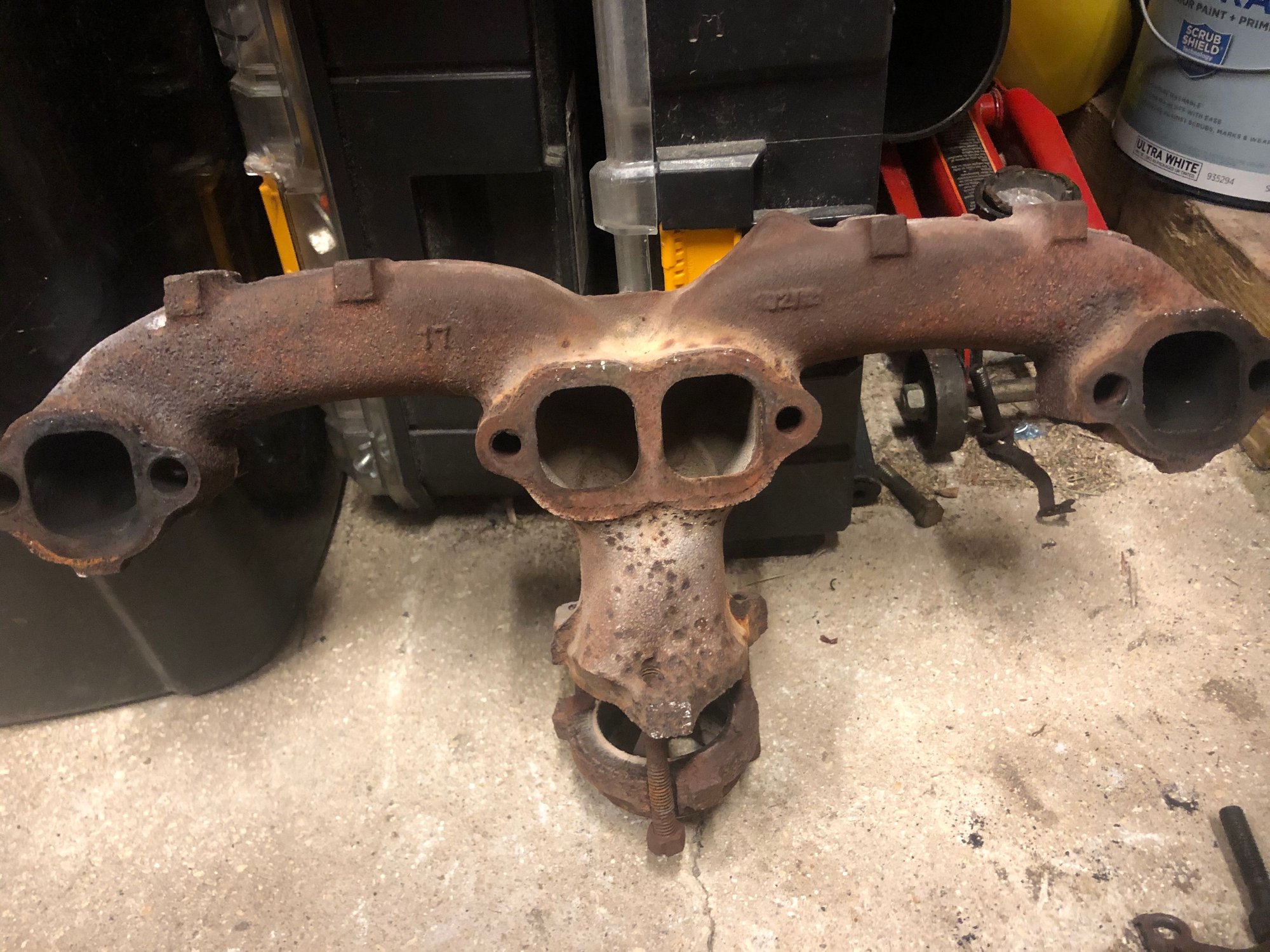

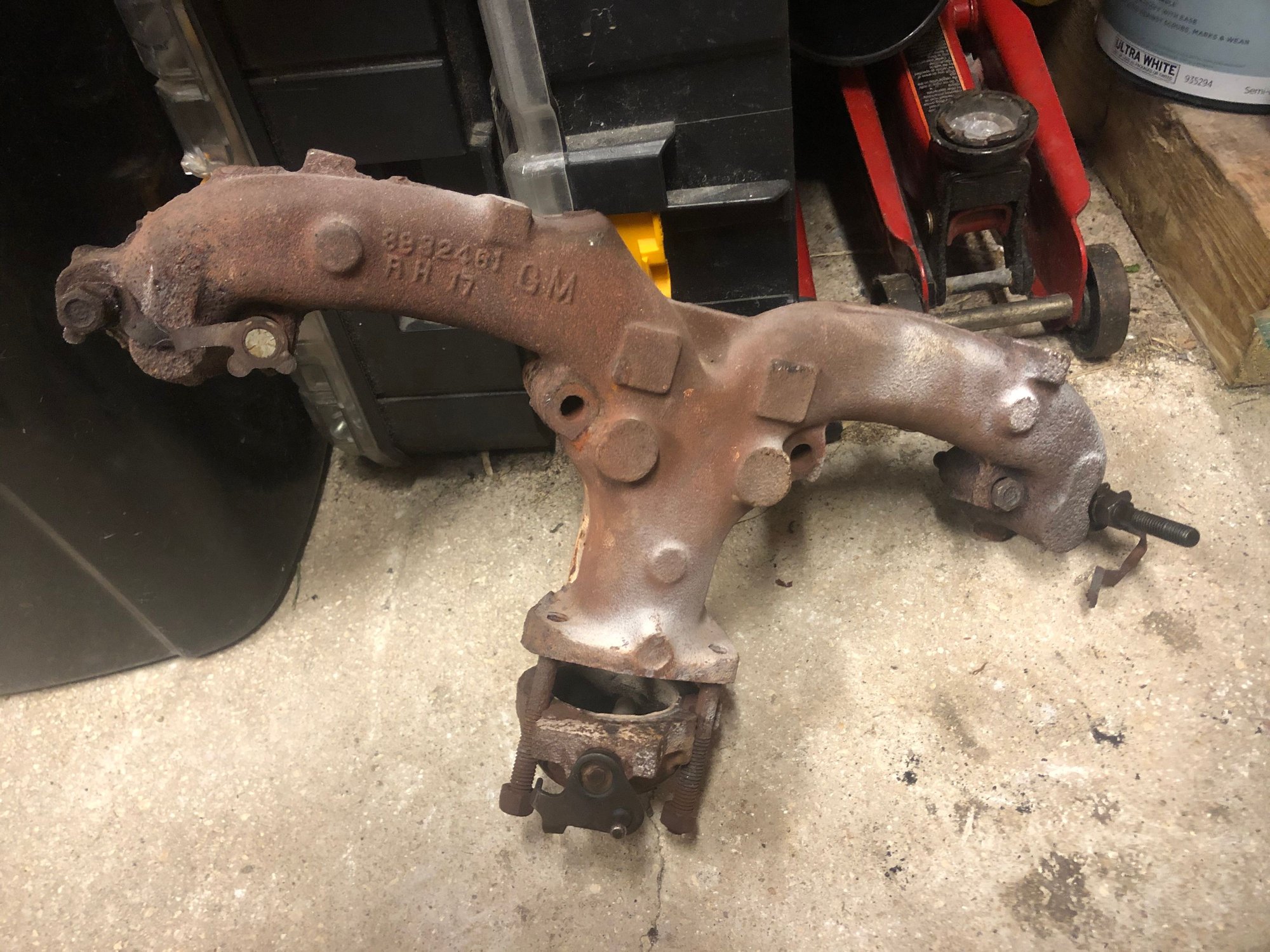

By the way check it out. I'm replacing the bottom portion with a spacer and removing that garbage that didn't have the flap anyway if you remember.

wait a minute. those are vortec. direct fit? other than the temp sensor?
https://www.summitracing.com/parts/sum-152123
