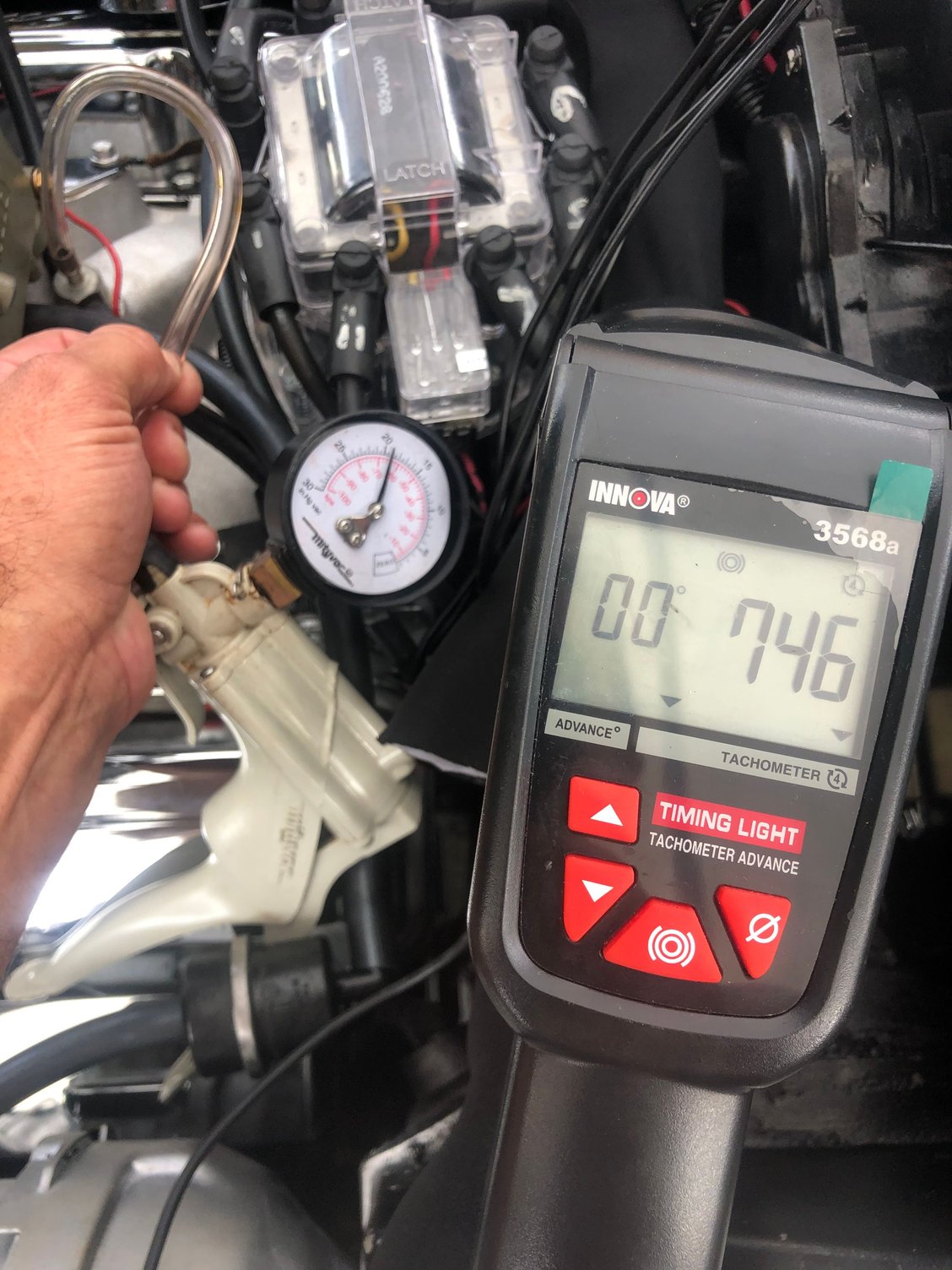

I used my mighty vac again on the 3 way manifold connection with a/t trans line off and headlights off. capped. same pressure about 15 hg (when I squeeze the line shut it stops jumping around and stays at what pressure it was at. 15 every time.
NOW CHECK THIS OUT.
Took the 2 idle mixture screws on both sides of carb that NEED TO BE ADJUSTED AT THE SAME TIME, does nothing for you UNLESS YOU CAN SEE HOW THE VAC INCREASES. so, I turn the screws completely clockwise to close them, then counter 1 full turn. start the car up with my vac connected. shows 15hg. SHUT OFF THE CAR (this is important for accuracy) and turned the 2 screws counter once again a full turn. started the car and my vac showed a change to 19hg. Did it again and saw no significant change at all. I'm sure now I have to combine this with other changes but I STOPPED at this point.
What changes did I see? Car is NOT shaking horribly when placed in gear. why? because my rpm's are up around 625. I can keep fiddling it to get it a bit more stable but for now it's really good.
What happened to my timing you ask? lol. It's the same. JUST in case I rechecked it and it's where it has been for mechanical (36x300). The vac advance connected changed? Went from 20 to 22.
The light gun is just there for rpm readings. Notes between pics.
turn them at the same time WITH CAR OFF EVERY TURN.
notice mighty vac and rpm's. wants to shut off and pressure was low.
now notice mighty vac. I brought my rpm's down from 800 to 750 to 700 ish area. feels good.

You nailed it! 19 in-hg is what you should see. I'm glad it worked out.
