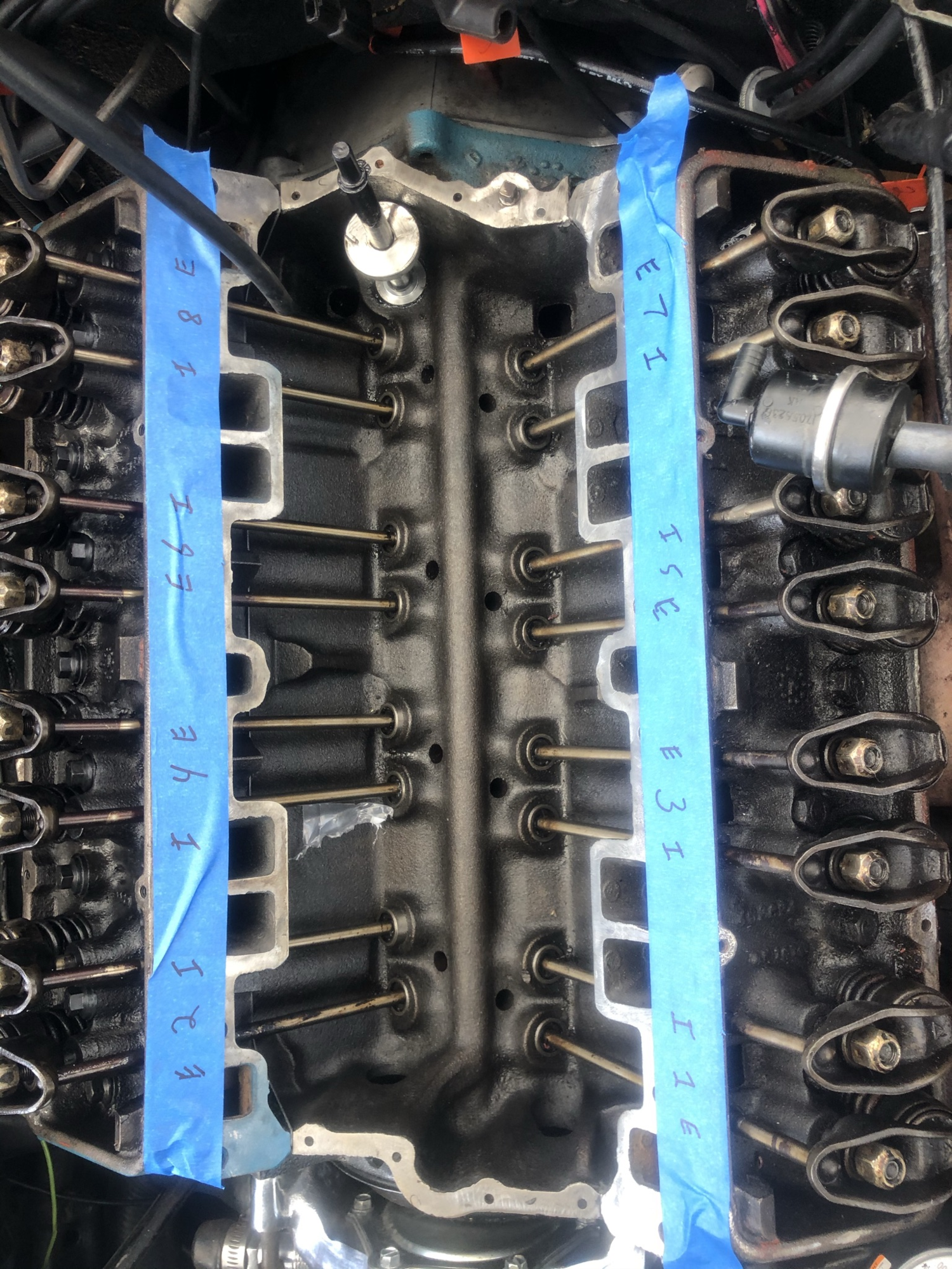

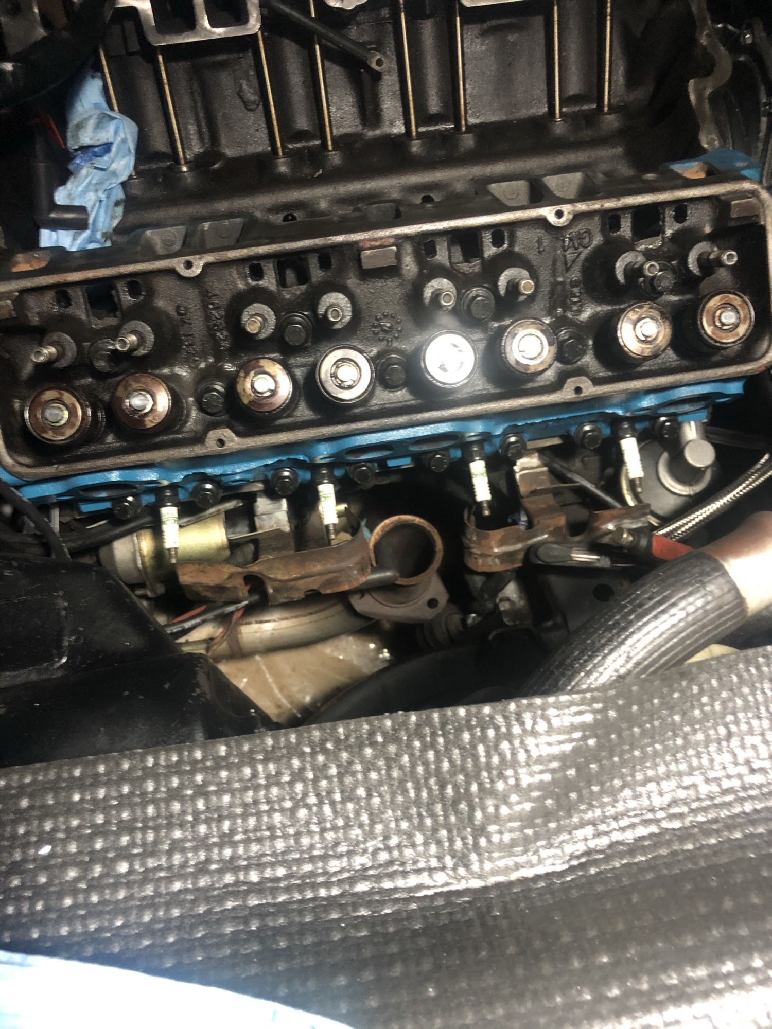

You said you put the old lifters back in. Trying to remember one of your post about you said you tagged which bore the lifters came out of. Correct?
I used to use Moly Lube on everything back in the day. That's all there was. Long before super-duper break-in special formula lube.
But Moly is a thick grease and I was cautious about not applying any to the pushrod tips. Just a dab of oil works fine.
If you think coolant did get into the lifters I would be concerned about the water not flushing itself out. It would sink to the bottom of the lifter even after priming the oil system. Should you remove each one and turn it up-side-down? IDK It may burn off later.
Update: Now I see an additional problem. That oil pump primer is to be used with the Intake in place. The collar on the shaft is designed to help build up pressure only with the Intake. That is likely why there was not much oil at the rockers.
And, choose your Intake Gasket Sealer wisely my friend.

labeled each lifter before. Bet there is water under each one still correct. Don’t mention moly lube please lol.
got it about the primer
sealer for intake suggest one in the name of God

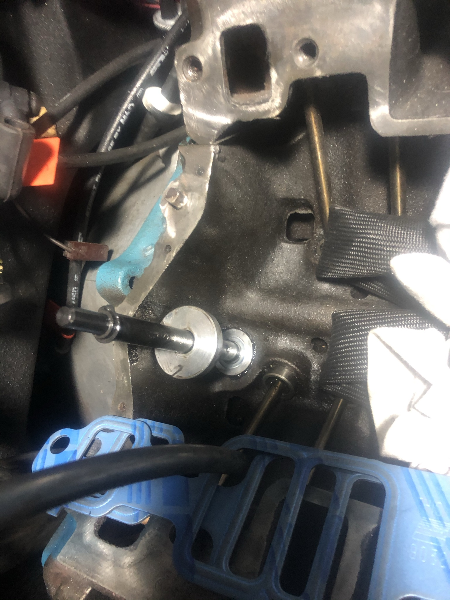

There are two types of oil primer tools. One has no collar that would fit into the Intakes dizzy hole. They are around $9 and don't work all that great.
The best ones are like what you have. The collar keeps the oil pump from loosing pressure in the dizzy hole. But only if the Intake is mounted.
That is also why a gasket goes between the dizzy flange & the Intake. There is oil pressure under there.
It takes a hella ofa corded drill to spin the pump for any length of time.

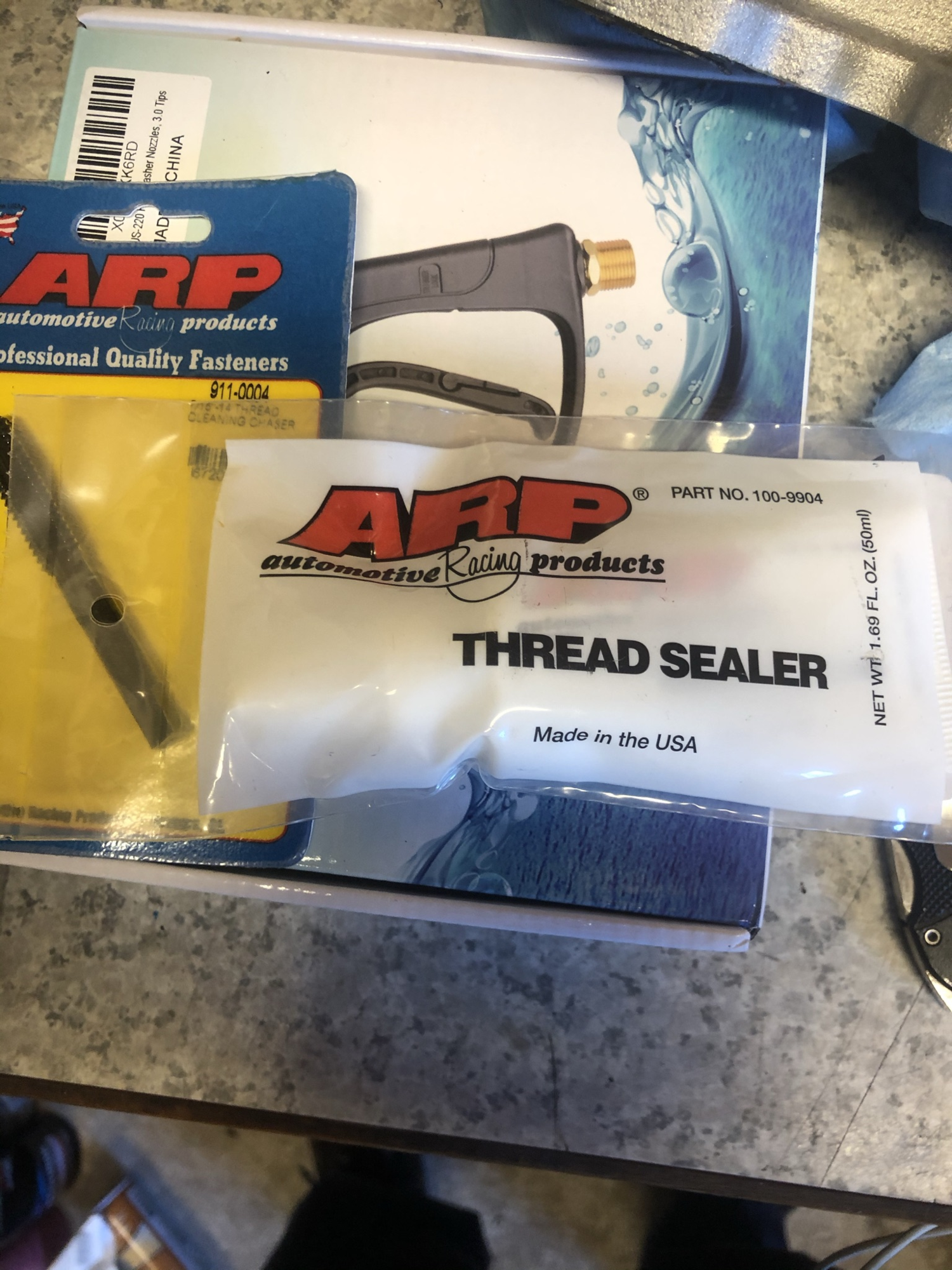

Intake Gasket Sealer? Can't say it. Can't spell it. But Edelbrocks Gastinich? Both sides of gasket. A little RTV around the water ports both sides.
But first, I like to coat just bottom side of the gasket, lay Intake in for weight. Let it set over-nite. Next morning, remove Intake, coated top side of gaskets then Permatex Right Stuff on the china walls. (no gasket).
Thread sealant on the bolts.

Intake or not has no effect on the priming tool working. You need the sleeve that simulates the distributor body where it passes through the block valley, and your picture shows that sleeve on the primer tool. The washer that sits in the intake hole just holds the tool centered, nothing else.

The intake doesn't have oil passages and has nothing to do with the oil pump lubrication in a small block. It will oil the same with or without it. There is NO oil pressure under the intake on a small block or big block Chevy that the distributor flange has to hold back.
You need the bushing with the oil groove to make proper oil pressure and get oil to both heads. This bushing goes into the hole in the bottom of the valley right above the cam.
The intake washer on the right only serves to center the shaft as I already posted. You can take that washer off and throw it away and the tool will still perform the pre-oiling job just fine.
I don't know what discussion was had, but obviously it wasn't very productive because you're still spreading bad information about how these old Chevy motors are oil pressurized.

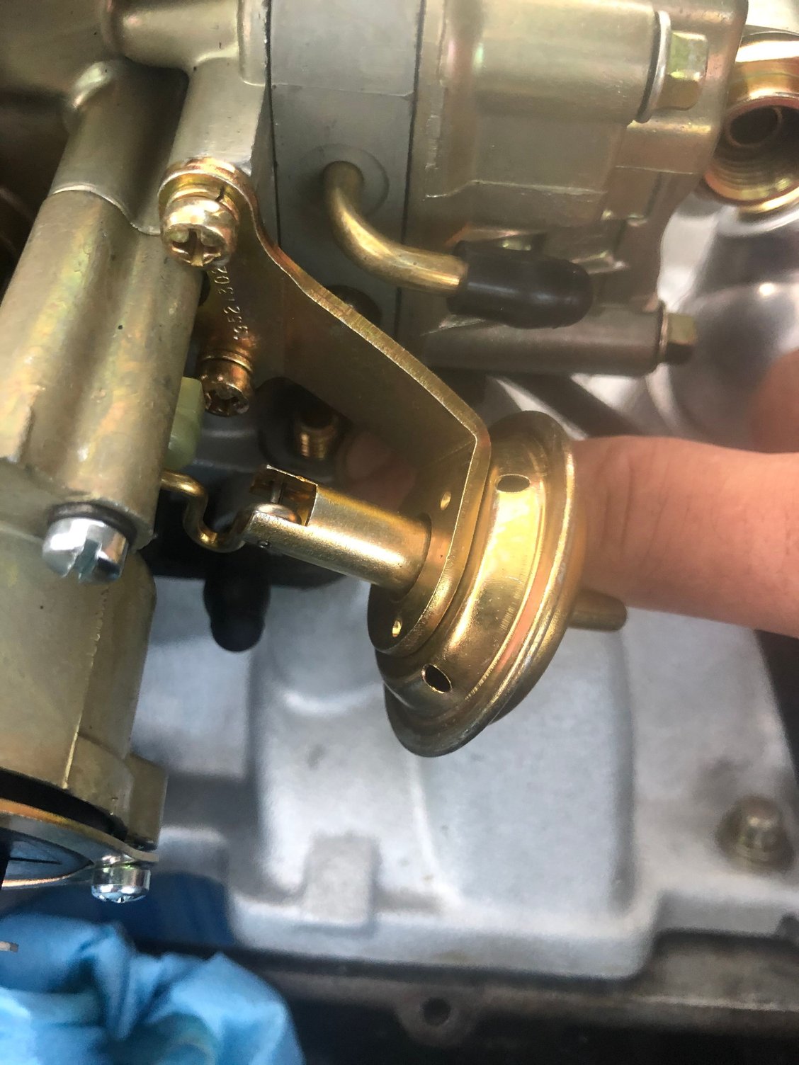

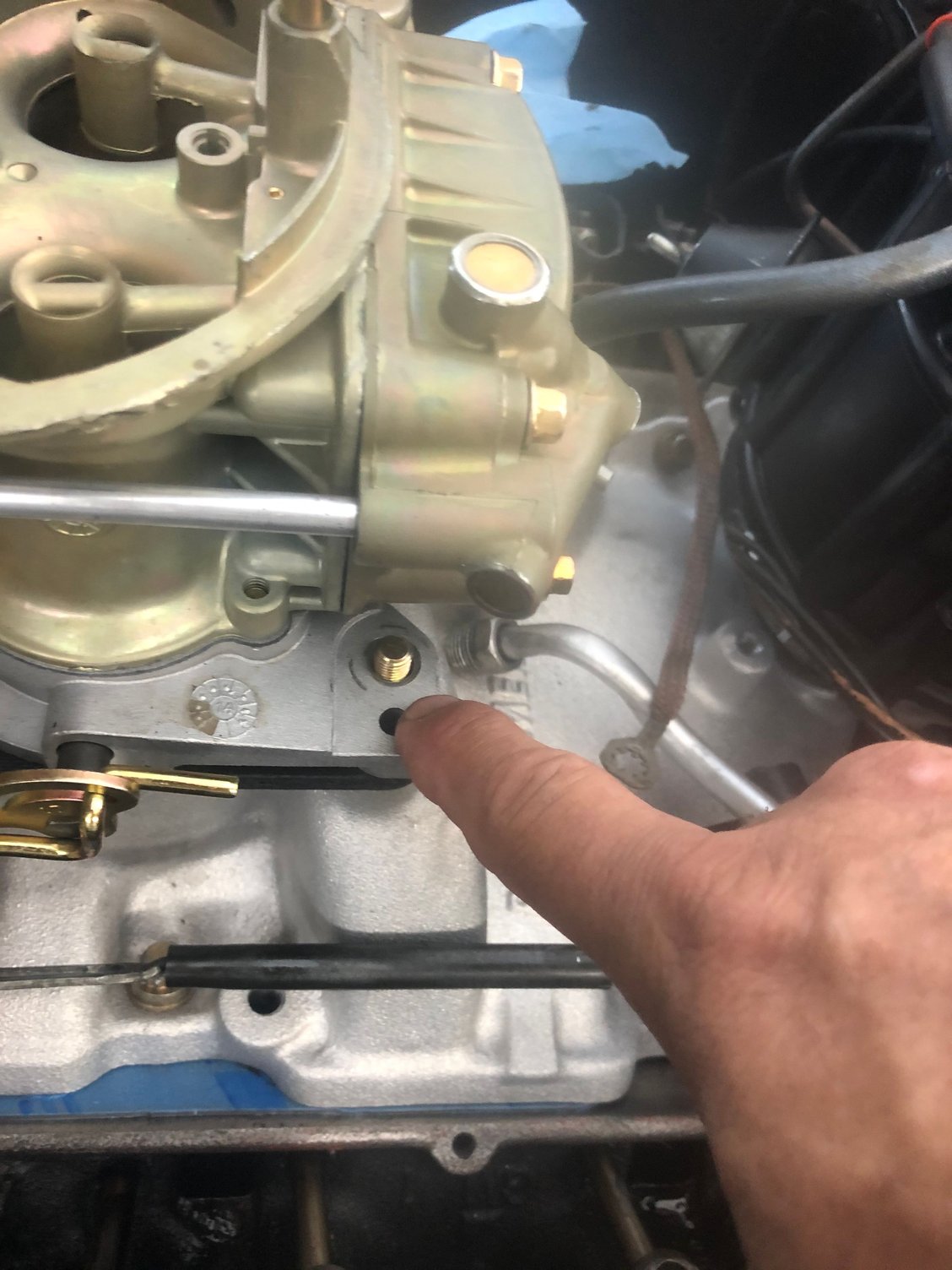

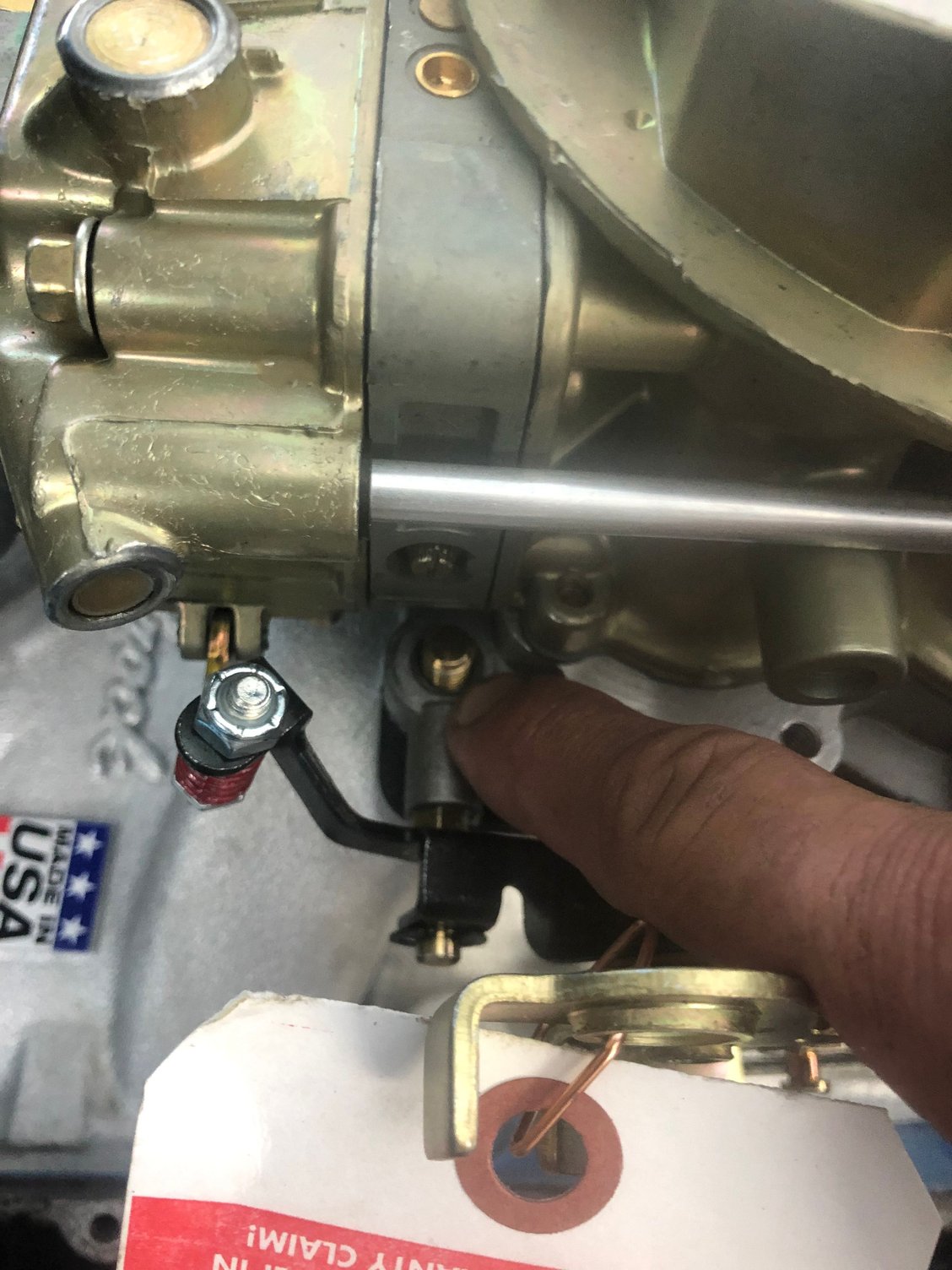

Default carb on
So I got the intake back on got the dizzy in. Now here are two issues. New holley carb 4175 near impossible to get to nuts that screw on to studs. Now here are two issues: what adapter am I using to connect the brake booster? nothing there. And how the heck am I supposed to put the bracket on when there's no clearance on the nuts as it is. The bracket holley sells doesn't specify the 4175 model.
