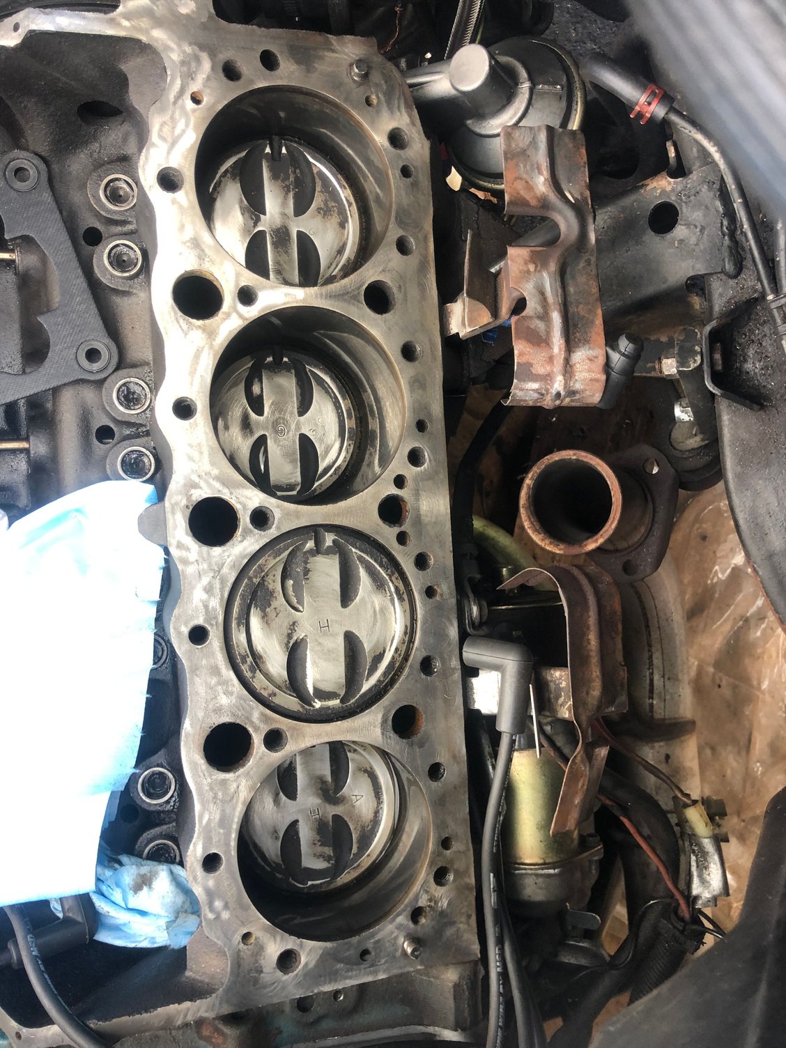

Your pictures are too close to know for sure what cylinder they are for, but it appears the lifters for cylinder #1 were both down which means cylinder #1 was TDC compression stoke,
On the compression and firing stroke, the valves have to be closed as the piston comes up to compress the mixture and they have to remain closed as the piston goes back down so the combustion can push the piston down. The valves should both be closed as the piston starts to move up and remain closed until the piston is most of the way back down again. If the lifters or valves on #1 are opening towards the top of the piston travel then #6 is going to fire, not #1.

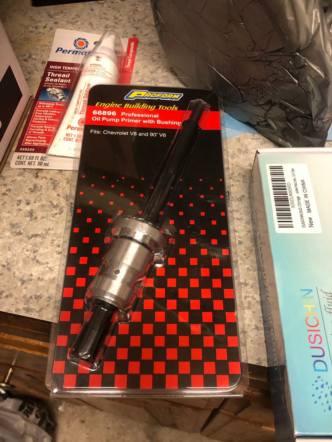

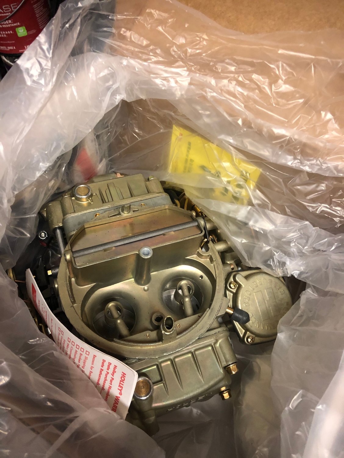

I got the holley in my buddy sold me at half what he paid. He lives out of state and was upgrading his c3 when he decided to sell it and had lots of new parts on the shelf. I also got in my tool to turn the oil pump so as to lubricate all parts again before re assembly. I will bathe the engine with new regular nothing special oil on the gallery then turn the pump with the drill till I get it coming out of the rockers. Pretty good idea I found online.

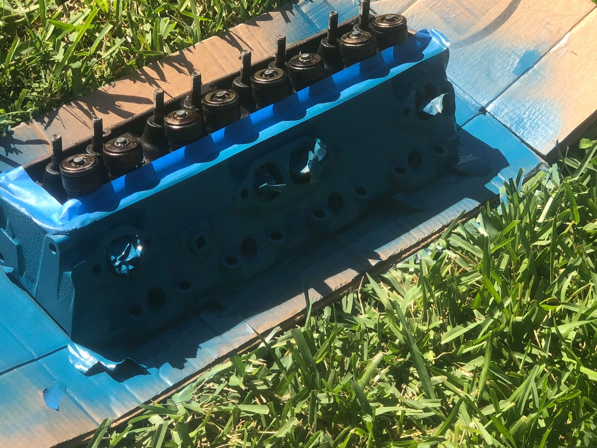

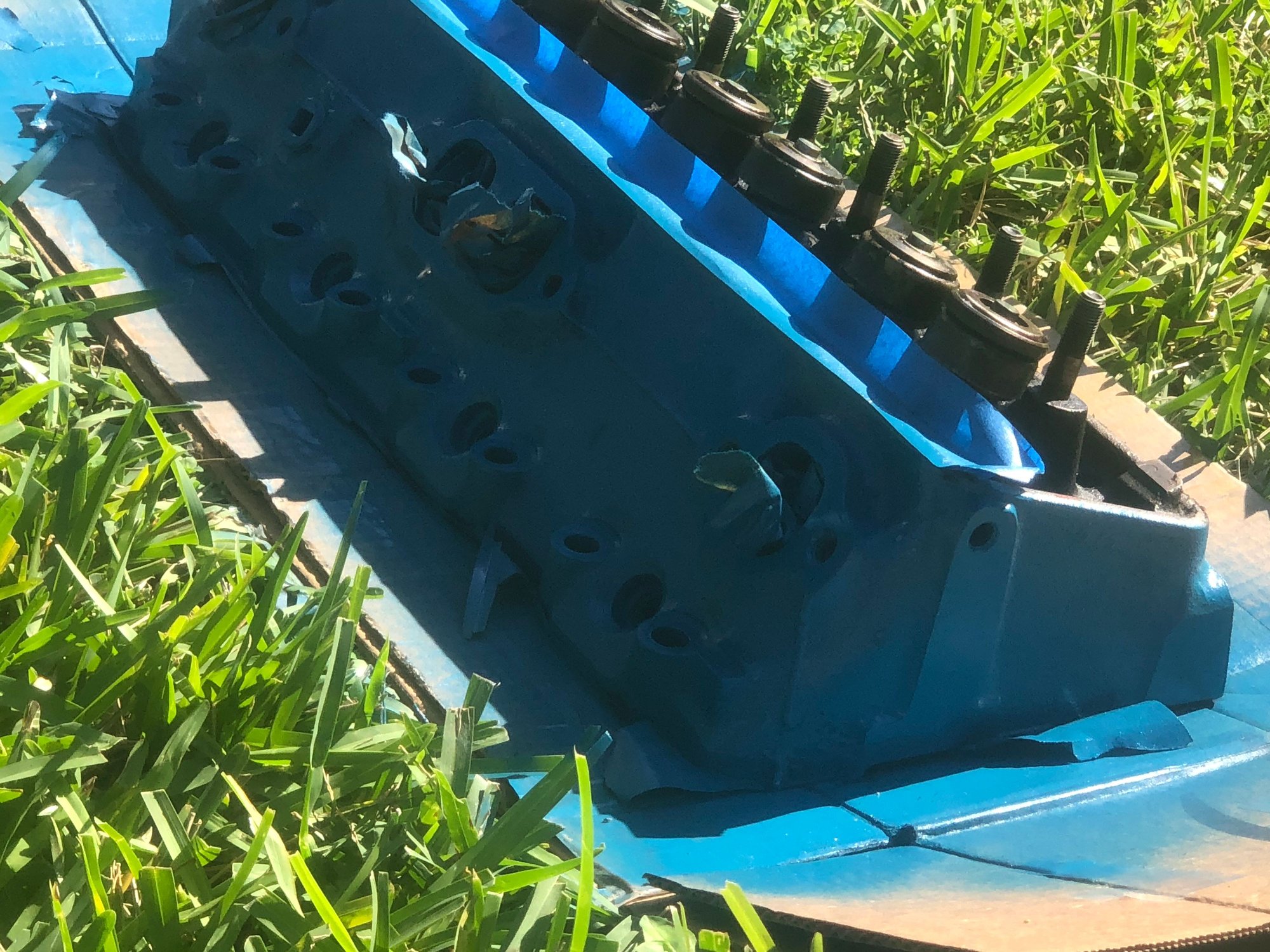

got the gasket and balancer tape in painted the head since it was out anyway, now waiting by the window for the thread chaser and high temp thread sealer by the window like a puppy. Why does everything have to come in agonizingly slow. I still can’t believe I did all this just to find what I pray is a timing issue

THANK GOD I bought an oil pump spinner to get the oil pumping thru the new lifters like I saw in youtube. That's really more for new engines you're putting together but I did it anyway. Well, not a drop of oil thru the rods. Why? gummed up! When it finally did break thru it was a really really slow dribble. One was shooting it out fast and furious.
The oil was mixed with water that was sitting I guess in the pan. Now remember I removed the intake manifold and I think water went in the engine. I certainly don't think it was the head gasket that went causing that. Well off to parts store to buy 10quarts and 2 filters of oil. Cycled it by bathing top of engine with oil spinning the pump and draining. Twice. Third time I had some extra oil, it drained fine. OFF with the lifter that were clogged (new ones). I put the old ones back (don't say it) after making sure I blew compressed air thru the peep hole and blew the gook out of the rods. Spun the oil pump again (bought more oil up to 60 bucks now) and it started coming out just fine. Cleaned the mess.
