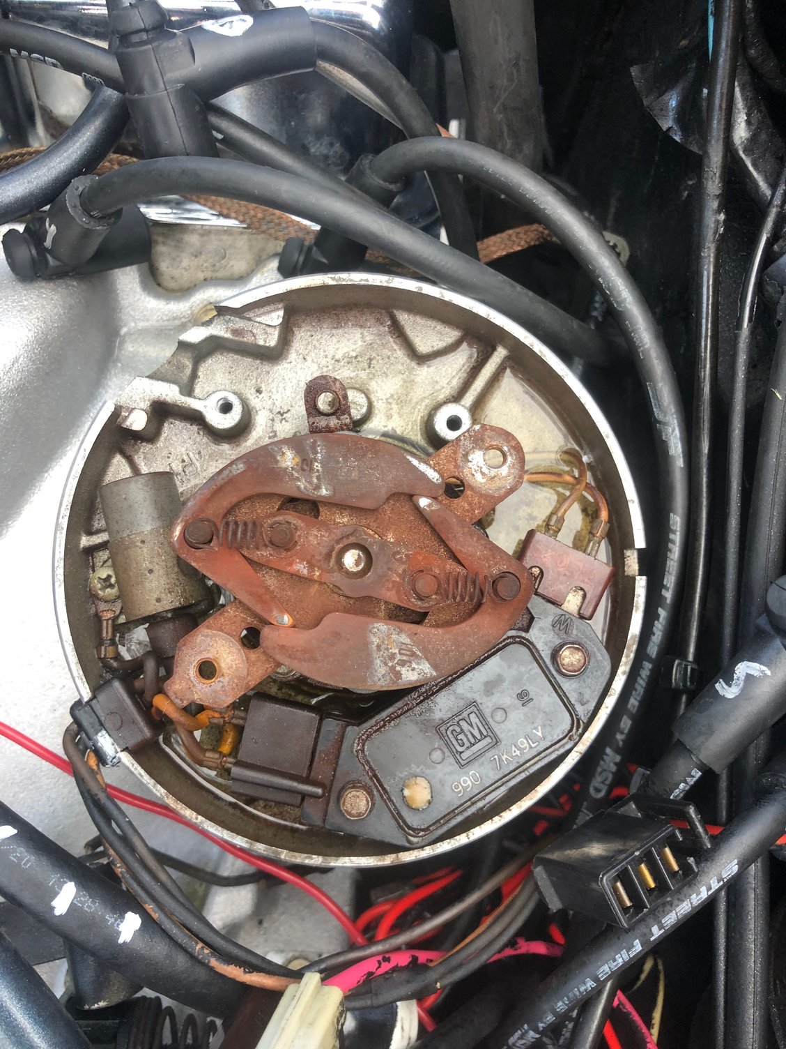

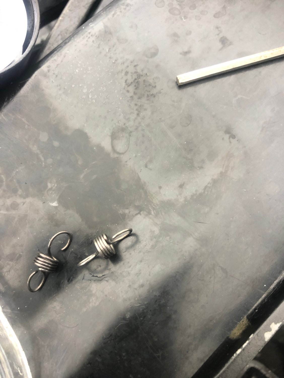

well this sucks. broke the piece off trying to replace. bushings crumbled and clips were like paper just broke away. great.
now I have to use the other dizzy. Changed the two springs on that one and added the adjustable vac can. set the can tighter. went back to carb intake which has zero static pressure until you rev then I hit about 27 max.
here are the settings. not a happy camper.

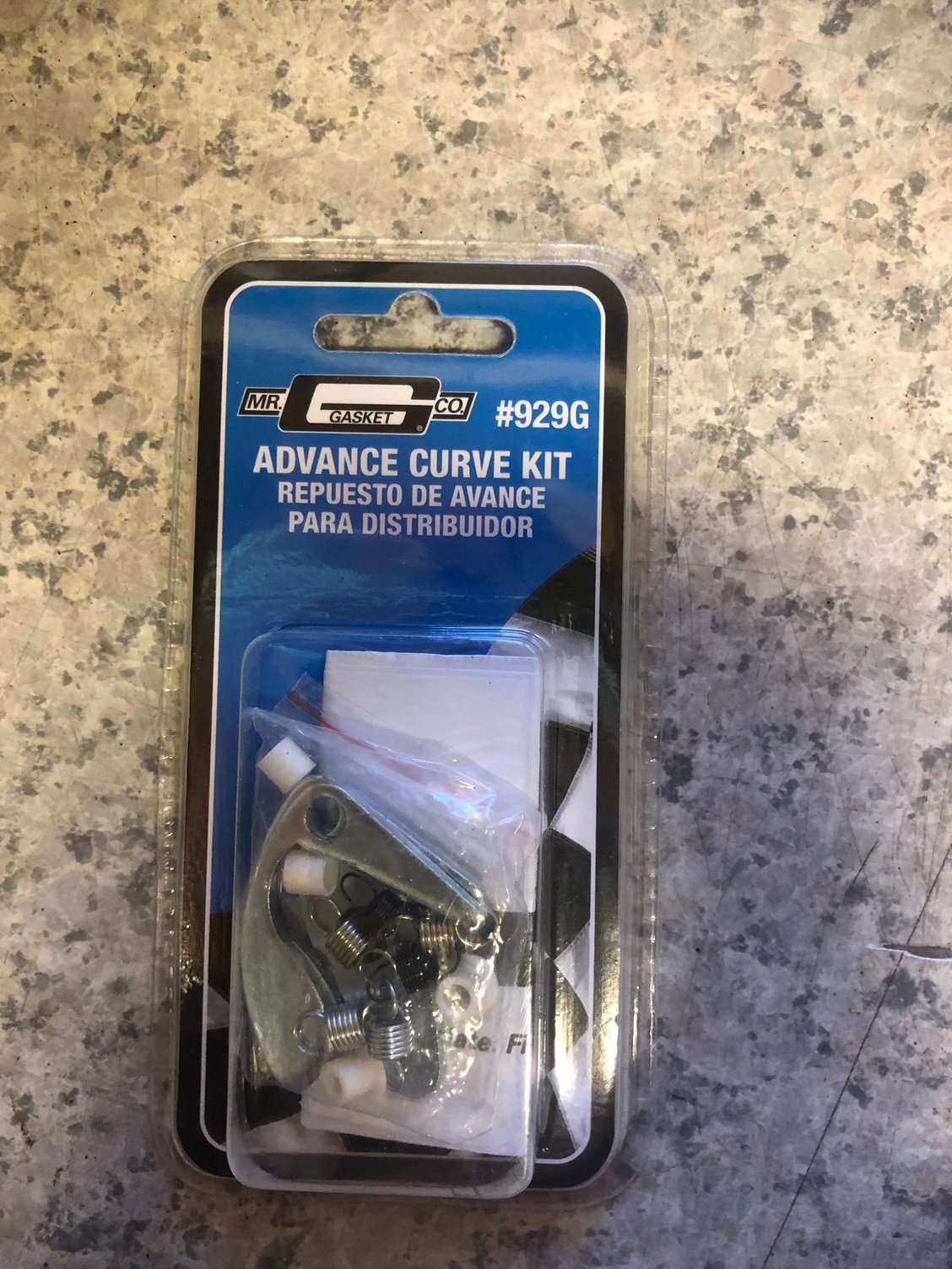

Go back to post #240, and do that again. You should be at 36 degrees advanced, all-in mechanical, with your vacuum disconnected and plugged, at 3000 RPM. If you get full mechanical at 2000 RPM (which is what a stock L82 distributor may do), you need slightly stiffer springs from the Mr. Gasket kit, or whatever you got. You shouldn't need to change the weights.
The Crane 99619-1 that @sstocker31 linked is exactly what you need to fix either your stock can, or your NAPA can, or you can run the adjustable can.
Once you have the mechanical set, an idle mixture adjustment may get you a few more inches of vacuum at idle, so any of the cans should work, if they are limited to 10-12 degrees of advance.
Pick one dist, run it. Pick one can, run it. And set the timing already. I can't believe this thread is 300 posts long! You should be out enjoying your car, and beer and burgers, not entertaining us on the Forum.
EDIT: I see the distributor chose you. You still want manifold vacuum to your can.
