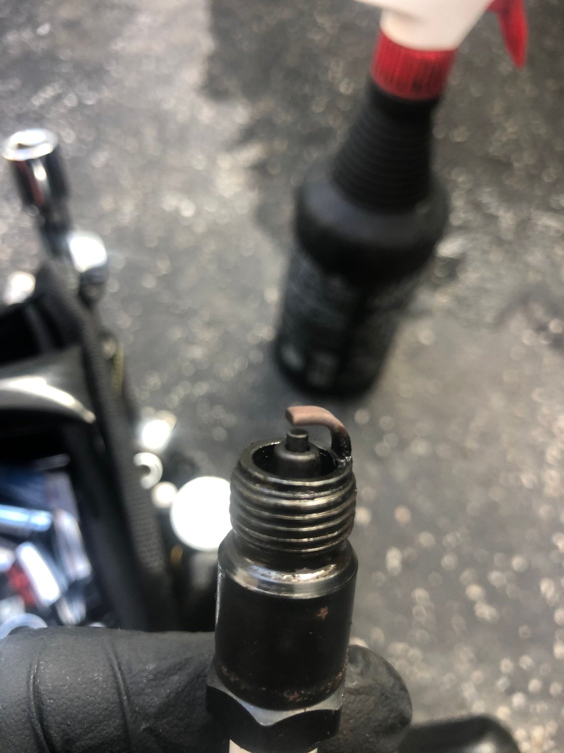

Never smoke. Plugs were pretty gritty that I changed about 10 months ago (just changed them again about 1 month ago). I gappe at .040 out of spec from the sticker on my car which I noticed late. I could have sworn it was .040 but it's .045.
I fear my issue may be related more to two things:
I just changed the head gasket on the passenger side chasing no compression (don't ask) so it may seem I'm a victim of the 'leaky head gaskets' issue on your chart. I also. It may not be dancing all that much but it may be that. I also relashed when I had everything opened (quite a few tries) and it may also be causing an issue?
Once I finish timing hopefully by tonight, I'm going to redo plugs anyway (gap) then I'll revisit this.

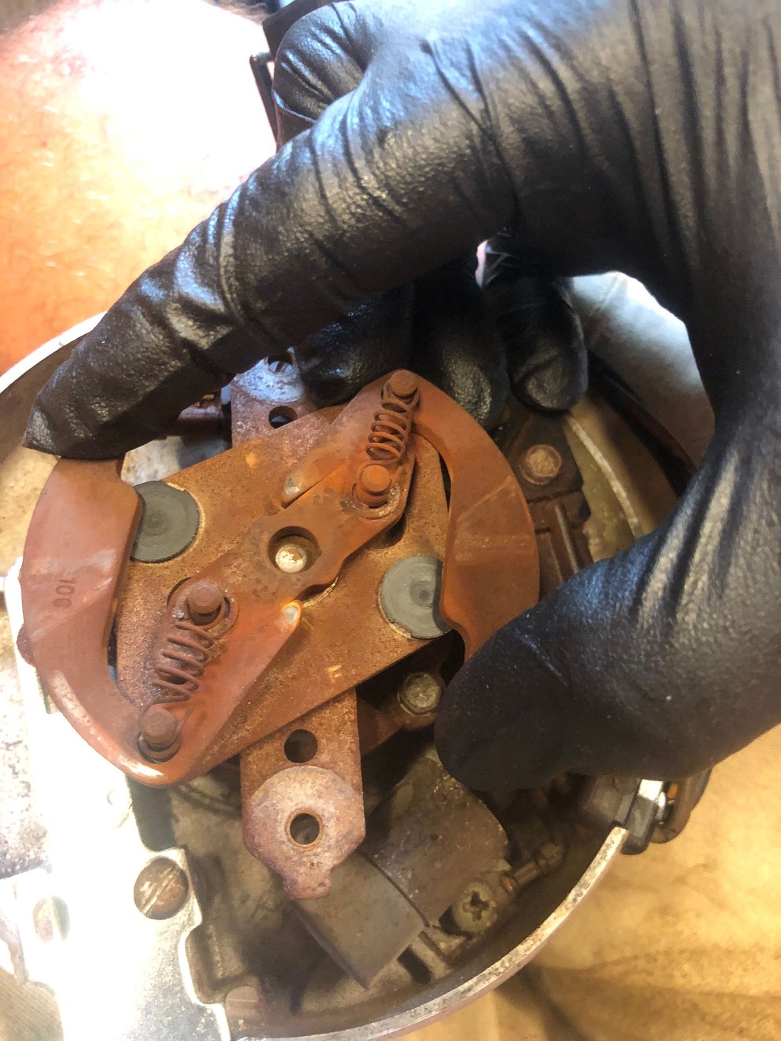

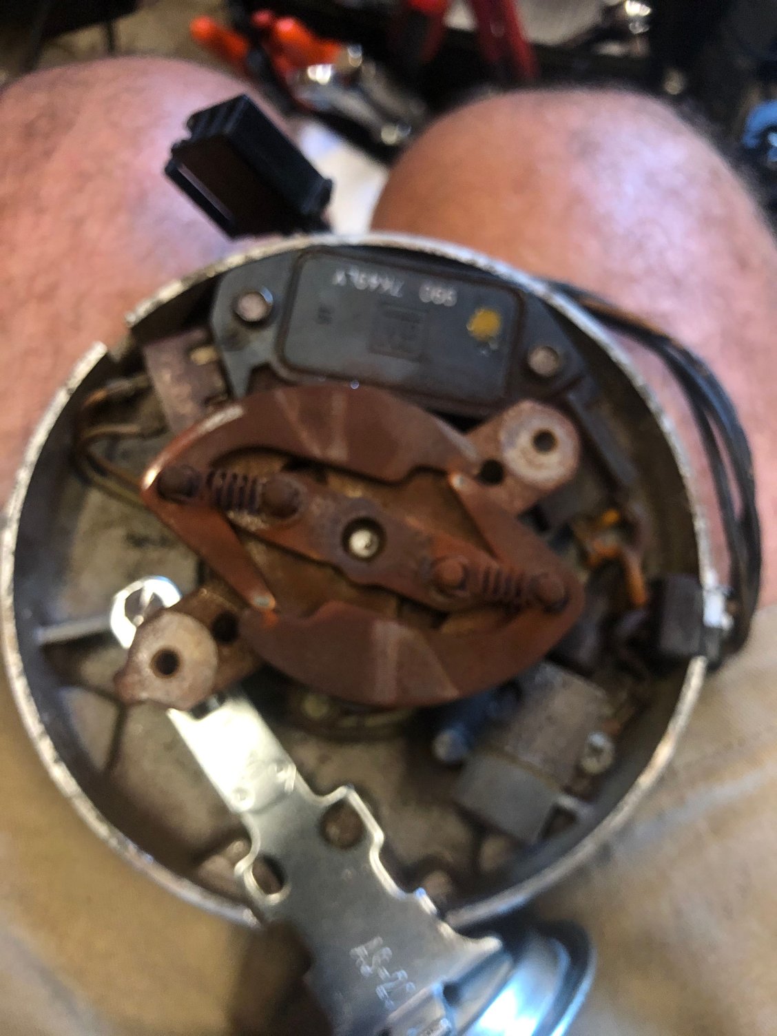

Spring are kind of crusty but if they're working you're still OK. Well, the whole top of the shaft is kind of crusty. The parts move freely, right? I see the nylon in there and the weight bushings seem to be in OK shape so mechanically it's not bad, as long as it moves freely.
You can buy cheap spring kits if you want to replace them or tune the advance curve.

If it works, it works. My 79's OEM HEI distributor was in much worse shape. The advance was notchy from corrosion, even with replacement springs, and the curve as RPMs increased was different than as RPMs decreased. I swapped it out for a dist from a ZZ4 crate engine (and still had to shim the endplay out).
You would have noticed all of this when you checked your mechanical advance before. Right now, your problem is that your idle vacuum is less than what the adjustable can needs to be "all-in". If you add a stop to the NAPA can, you might be all set, whichever dist you use.

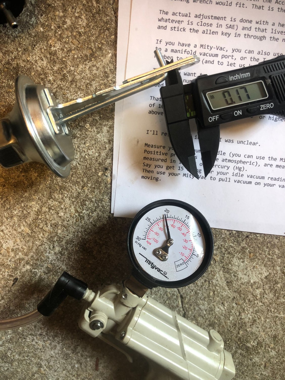

ok all put back together new plugs in (much nicer) dropped dizzy at tdc. Here is what I got.No vacuum
Light at zero rpm 685. I rotated counterclockwise to get to 4 degrees btdc so it’s a bit less rough.
Light gun at 23 rpm 3600 still no vac
Back to idle Light gun at 4 to get to tdc. 730 rpm
WITH VAC:
light gun to 15 to get tdc rpms are 845-975 if a/c fan kicks on slows to 845.
Light gun to 35 to get to tdc at 3600rpm. Stops advancing btw starting around 2100ish
We are back where we started I think.
as a test My mighty vac measures 11-14 hg from manifold vac. To get vac can to start advancing I have to pump the mighty vac to 21-24hg

It looks like your vacuum advance maximum is about 11* which it should be for your new vac canister.
Now, with no vacuum connected, advance your initial timing from 4* to 14* at idle. Now check it at 3600 rpm. It should now be about 33* which is very close to where you want it.
Now, with vacuum connected, it should now be about 25* at idle and your manifold vacuum should now have increased and your idle speed. Turn down the idle speed to about 800 rpm. Increase rpm to 3600 and the timing should be about 44*.

I'm changing these out. Mine are stiff. Let's see what I get out of my curve now. 3 springs. soft (opens easier) med and hard. what say you.

You should just clean up and keep your original distributor flyweights....I noticed in the pics that the bushing in those were done anyhow. Use a combination of springs to get the full mechanical advance (the flyweights) to come in around 2800-3000 RPM. If max advance comes in before that, you may end up with some detonation.
Don't set the timing by the what the factory says, listen to all the posters on here that are saying set it to 36 degrees with the vacuum advance line disconnected from the distributor and the line to the carb plugged.

You're just going to play with spring changes, right? Not use the weights. Maybe use the bushings.
Plug the vacuum again when you're doing any mechanical advance testing or adjusting.
