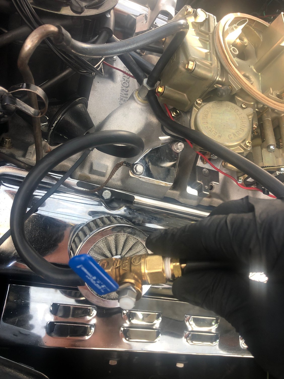

yes getting it tomorrow. did you see my rig?
That's cool for testing. You wouldn't want to run like that bouncing around, though. It might damage your chrome.

got the napa can and the new dizzy. if the springs are an issue i'm dropping this one in. if not adding the can instead. i'll be on this today God willing.

springs seem ok. I forgot to take a pic and came inside to take a bath. Tomorrow I'll shoot pics.
1) install vacuum can and try the vac advance again to see how far advanced i'm at.
2) if we're on the money then I'll stop fooling around. We time it at 10-12 out (10 I assume due to the can I bought) then tune the idle screws on the holley.
3) What has me worried is that under load when I punch it I DO NOT hear/feel the secondaries open at all. This is before I readjusted for timing when I drove to a friends house. I know I have to tune. The worst part is according to the manual the secondary adj. screw is underneath!! So I'd have to remove carb to work on that and put it back. What a horrible design flaw IMO.
Anyway tomorrow it is.

replaced dizzy with new napa can to see if any difference existed. with vac connected after all steps 51 degrees at 3500 rpm's. i'm assuming 15 degrees (51-36). let me check in a minute properly. this is after mech advance done.
