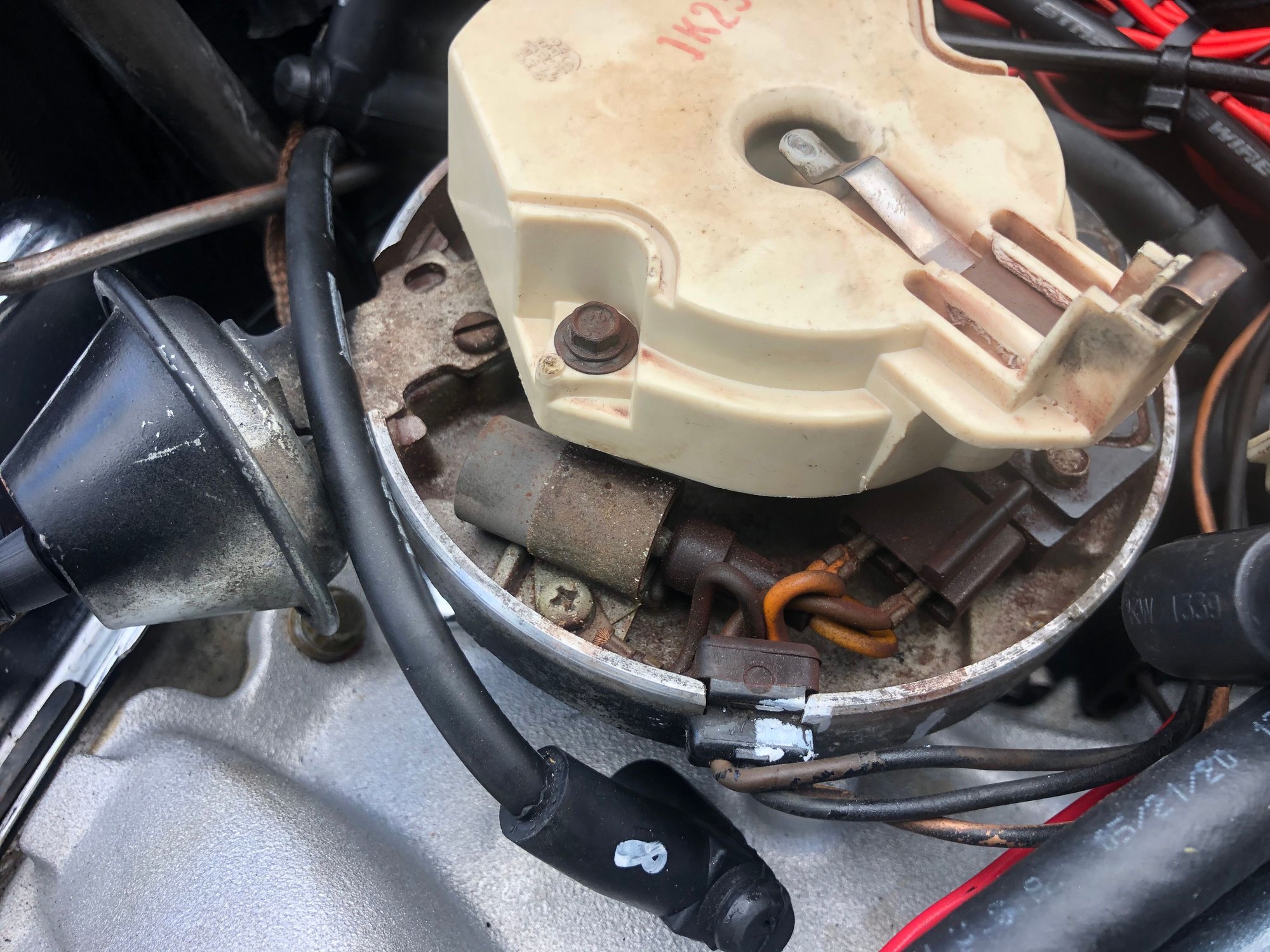

I did swap it. I'm wondering now if it's used or something and they put a different one in the box. The box itself is correct and shows 10-12degrees from the GM spec sheet.
I swapped the dizzy since I was in there and it was new and shiny.

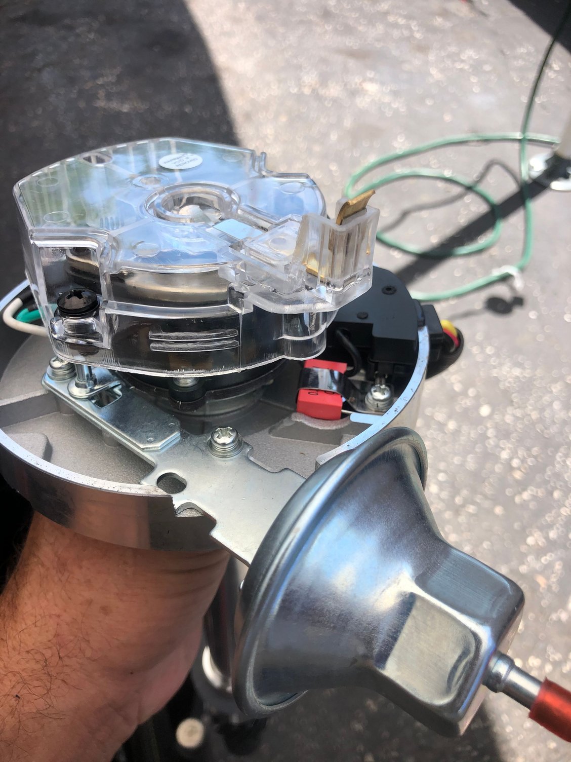

Springs affect mechanical not vac correct? if both then there is the issue. I may have to go back to old dist then change can.

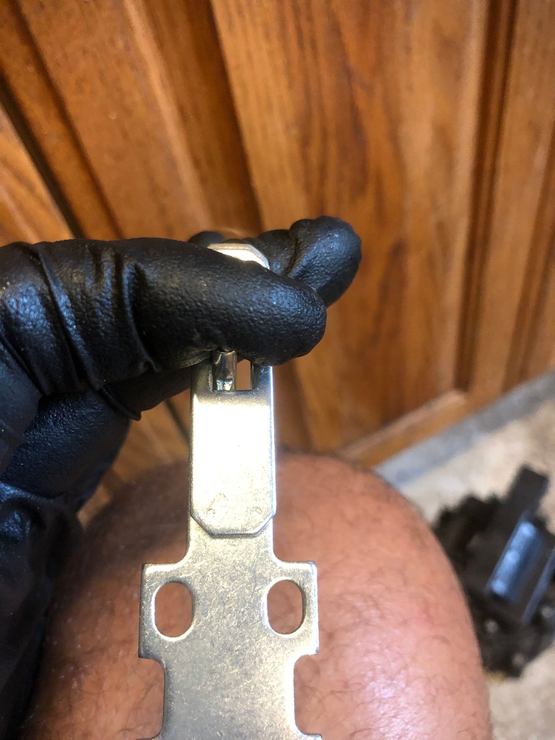

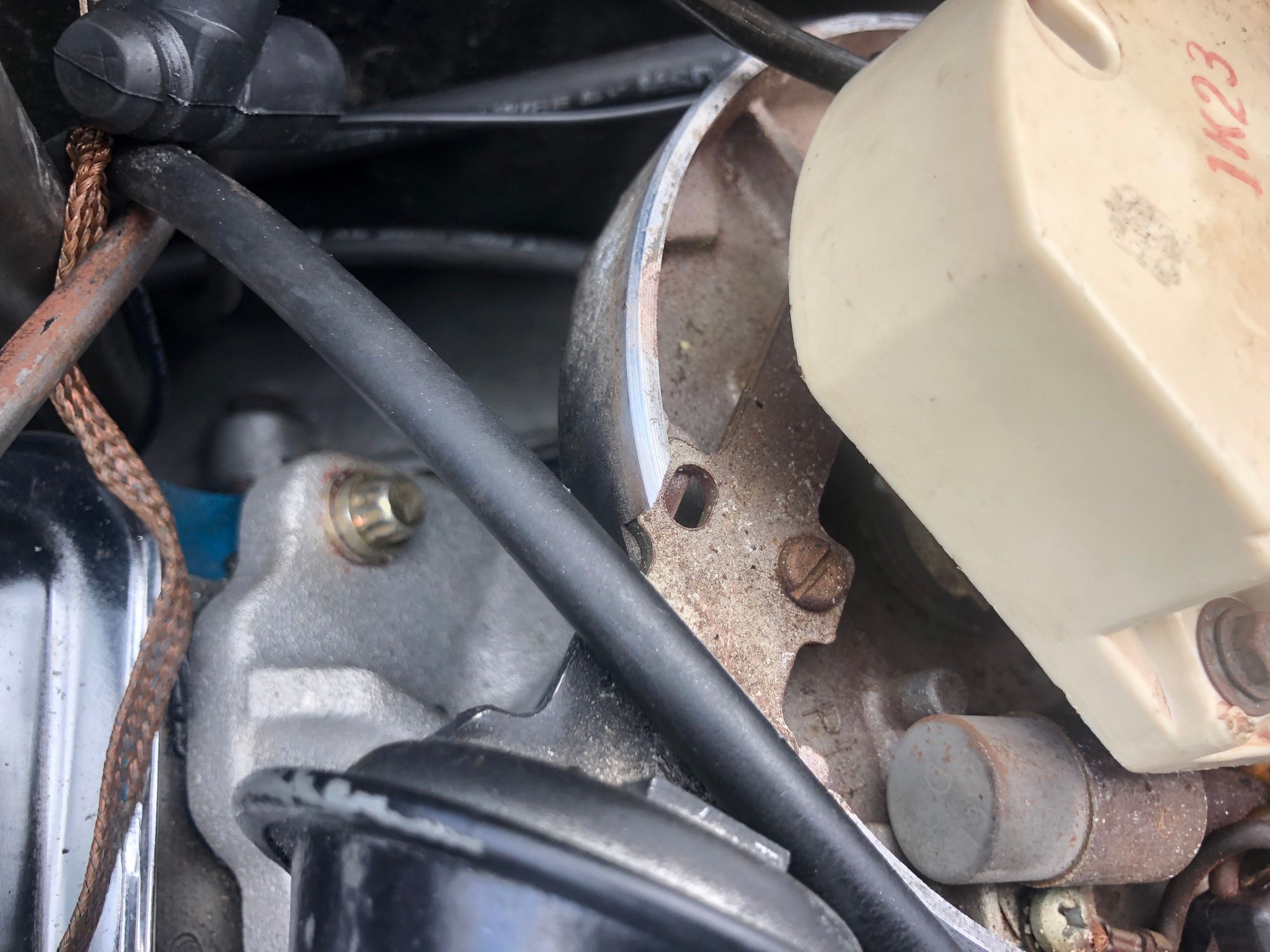

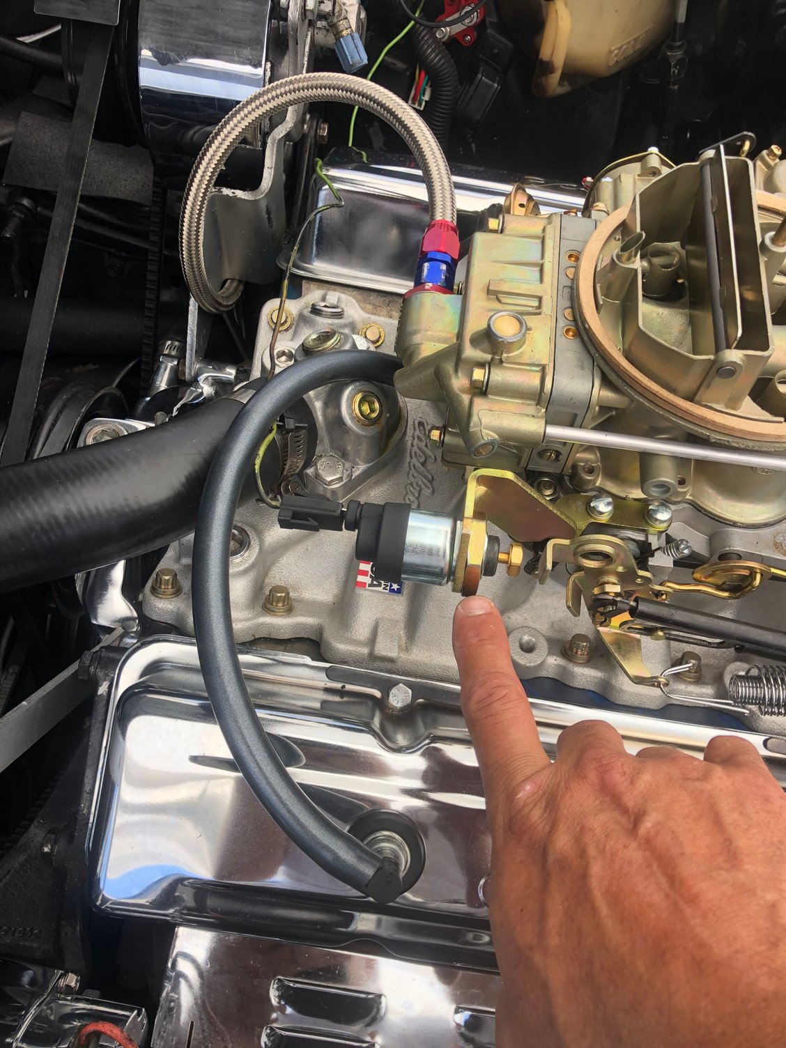

Also added the solenoid and it doesn't reach the arm. see pic. I have to adjust that somehow to make it. Holley carb holley arm holley solenoid. I'm going to start making my own stuff and selling it.

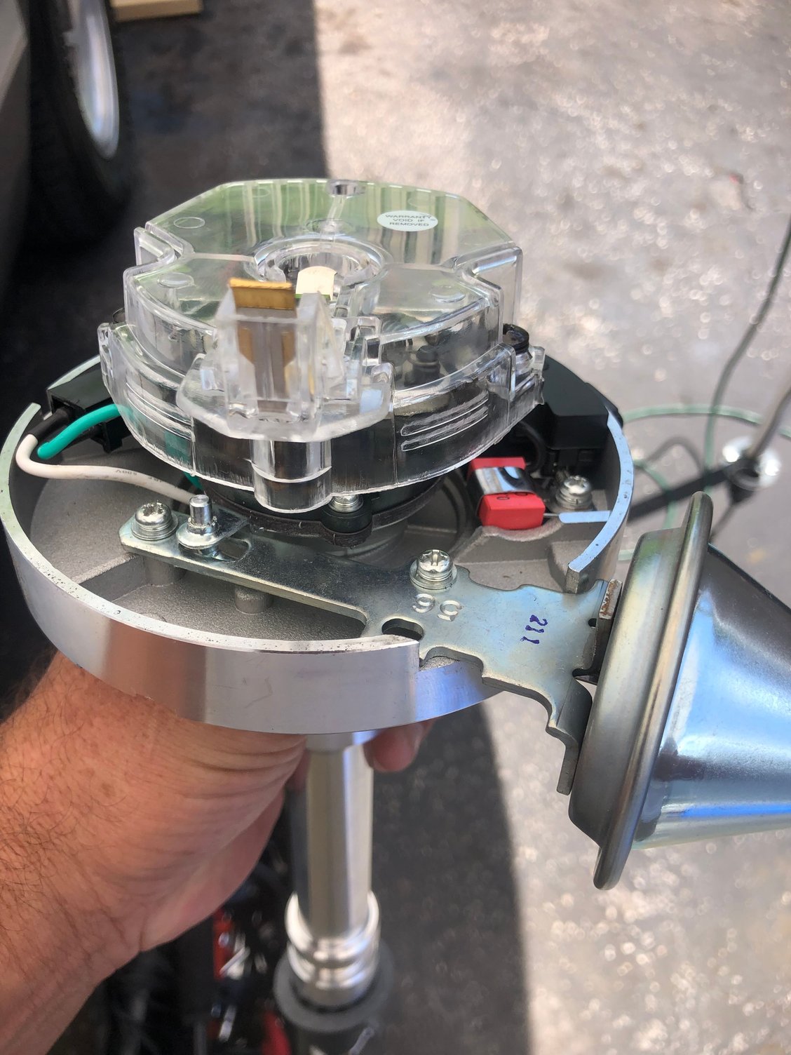

last pic shows new can on new dizzy.

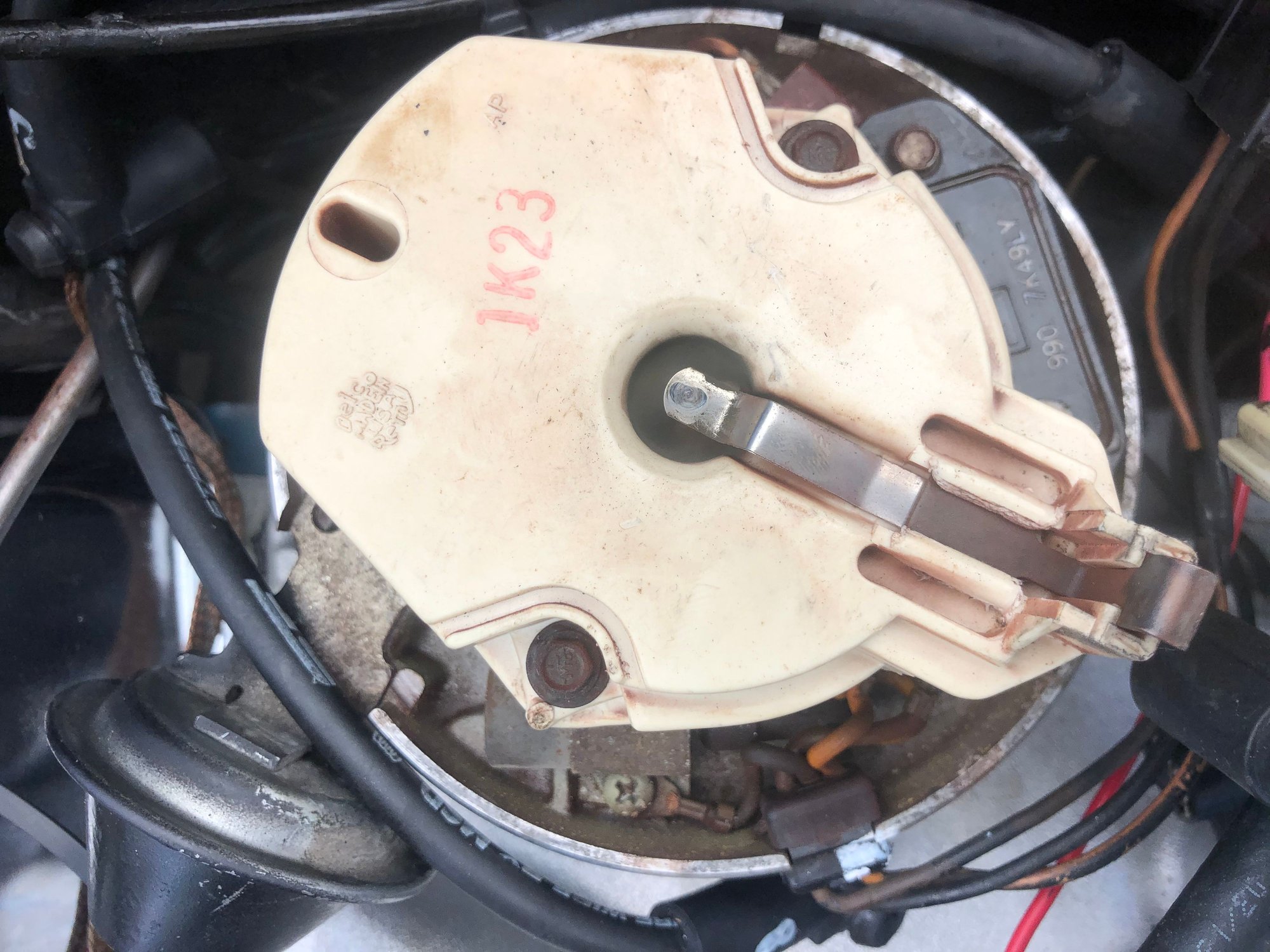

In the next to last photo, your (presumably new, Chinesium distributor) with the clear rotor, there is a hex on the vacuum advance. It is almost certainly adjustable. If you zoom in on the photo in my post #246, you can see the instructions for my Accel adjustable vac can (which also has the hex). I bet you can stick a small hex-head into yours, and adjust the total vacuum advance. Did the new distributor come with any instructions?
Does "211" match what's on the box? Also in post #246, you can see my Mity-Vac. Using one will be a much easier way of measuring the vacuum advance. You might need to limit the vacuum advance by one of the other listed methods (hard stops on the lever arm).

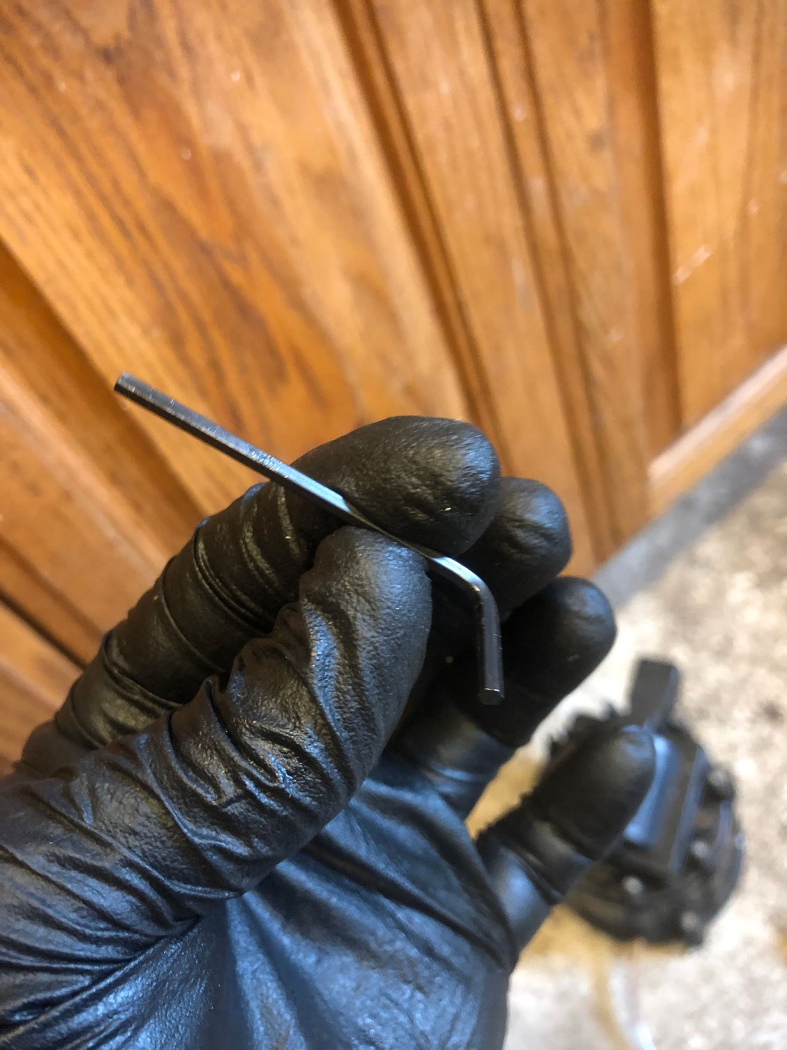

Where's the hex? I see your spec sheet under the mighty vac. What psi am I looking for on my mighty? I'll check if 211 is on the box.

The end of the vac can of both the Accel adjustable have a hex shape, like a 3/4" or something wrench would fit. That is the visual indication that they are adjustable.
The actual adjustment is done with a hex head screw (tiny, like 2, 2.5, or 3mm, or whatever is close in SAE) and that lives inside the can. You remove the vacuum hose, and stick the allen key in through the nipple.

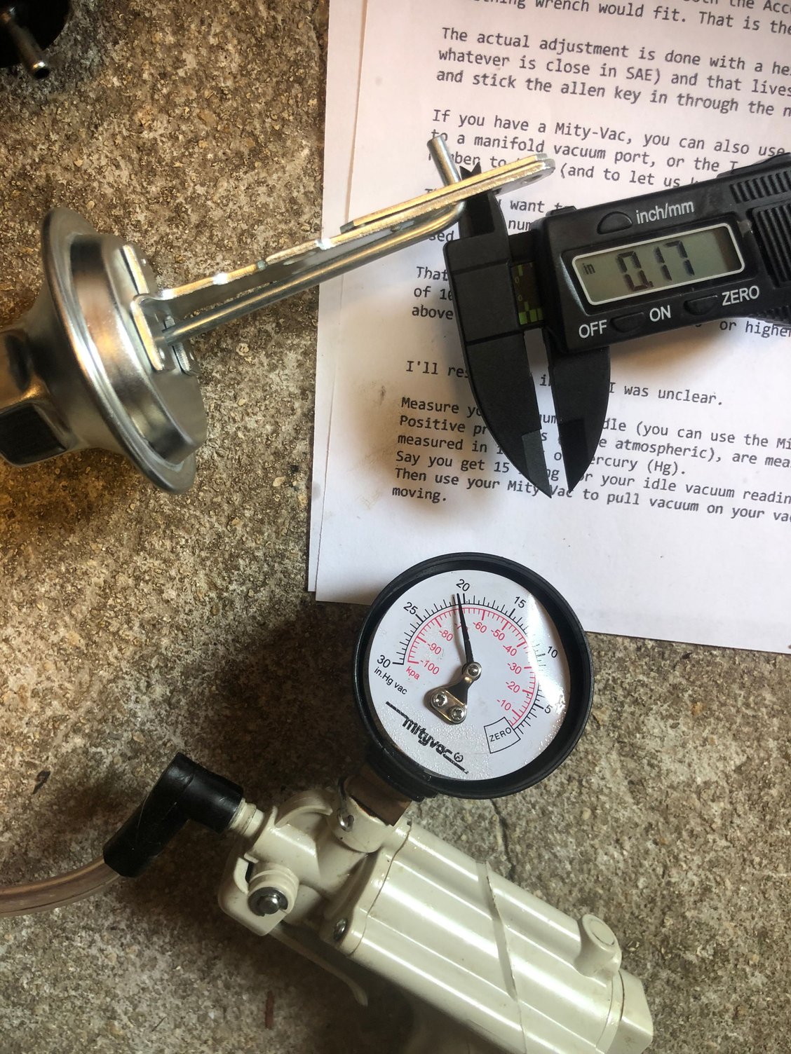

If you have a Mity-Vac, you can also use it to test your vacuum at idle (connected to a manifold vacuum port, or the T on your intake manifold). This is another useful number to know (and to let us know).
Then, you want to make sure that your vacuum can comes into full advance at 2" less than that number. (2 inches of mercury, in hg, is about 1 psi, but psi is usually used for positive pressure, and in hg for vacuum strength).
Old May 9, 2021 | 09:02 AM

I'll restate it in case I was unclear.
Measure your vacuum at idle (you can use the Mity-Vac for that).
Positive pressures (above atmospheric), are measured in psi. Vacuum strength is measured in inches of mercury (Hg).
Say you get 15 in-hg for your idle vacuum reading.
Then use your Mity-Vac to pull vacuum on your vacuum can. Watch where the arm stops moving.
The arm should stop moving (all in, vacuum advance) at 2" less than full idle vacuum.
So for 15 in-hg of idle vacuum, you need to pick a vac can that stops moving at 13 in-hg of vacuum, or before.
As @resdoggie pointed out, if you do this experiment with the Mity-Vac hooked up with your engine idling, you should see that the all-in vacuum gives you 10-12 degrees of total vacuum advance.

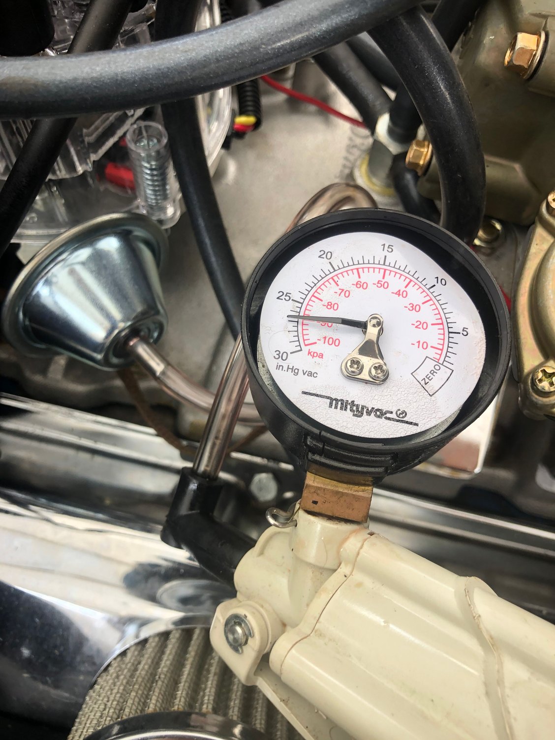

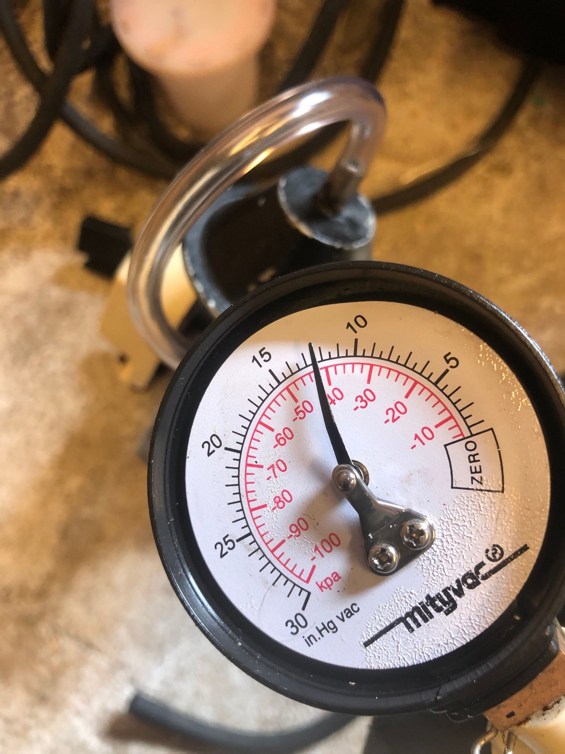

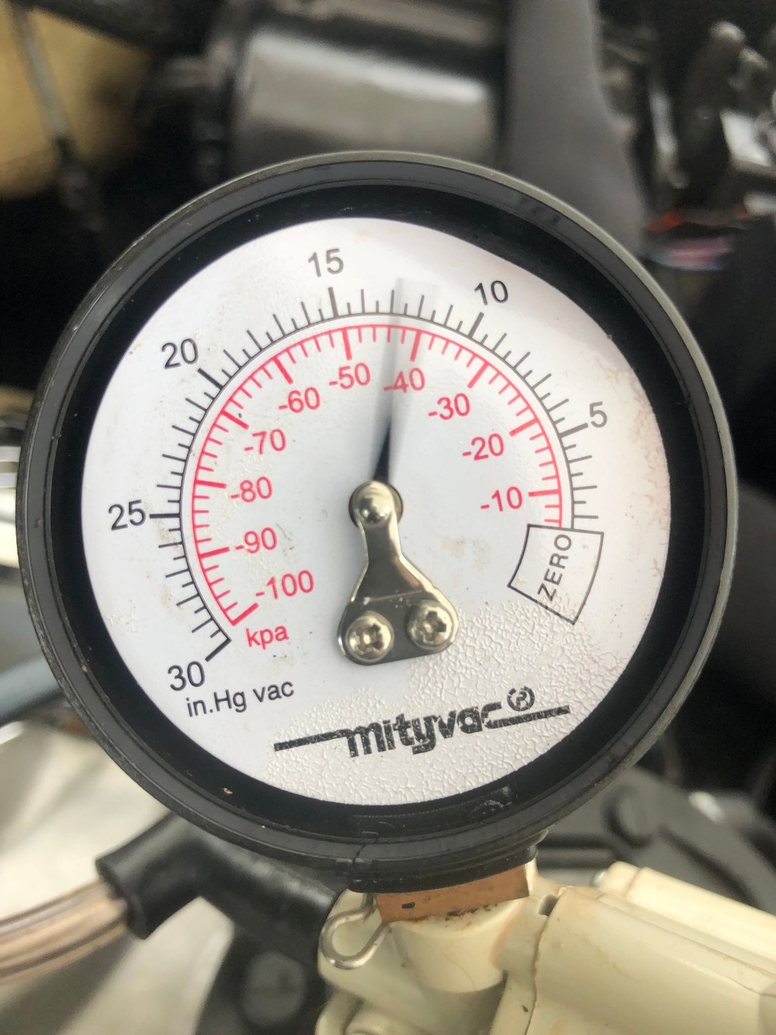

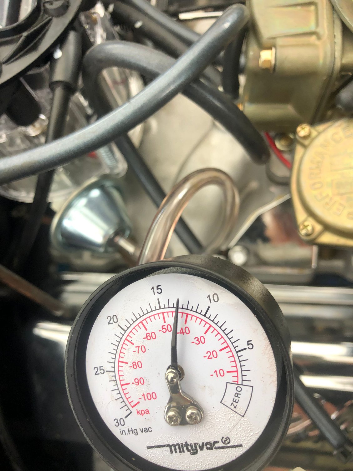

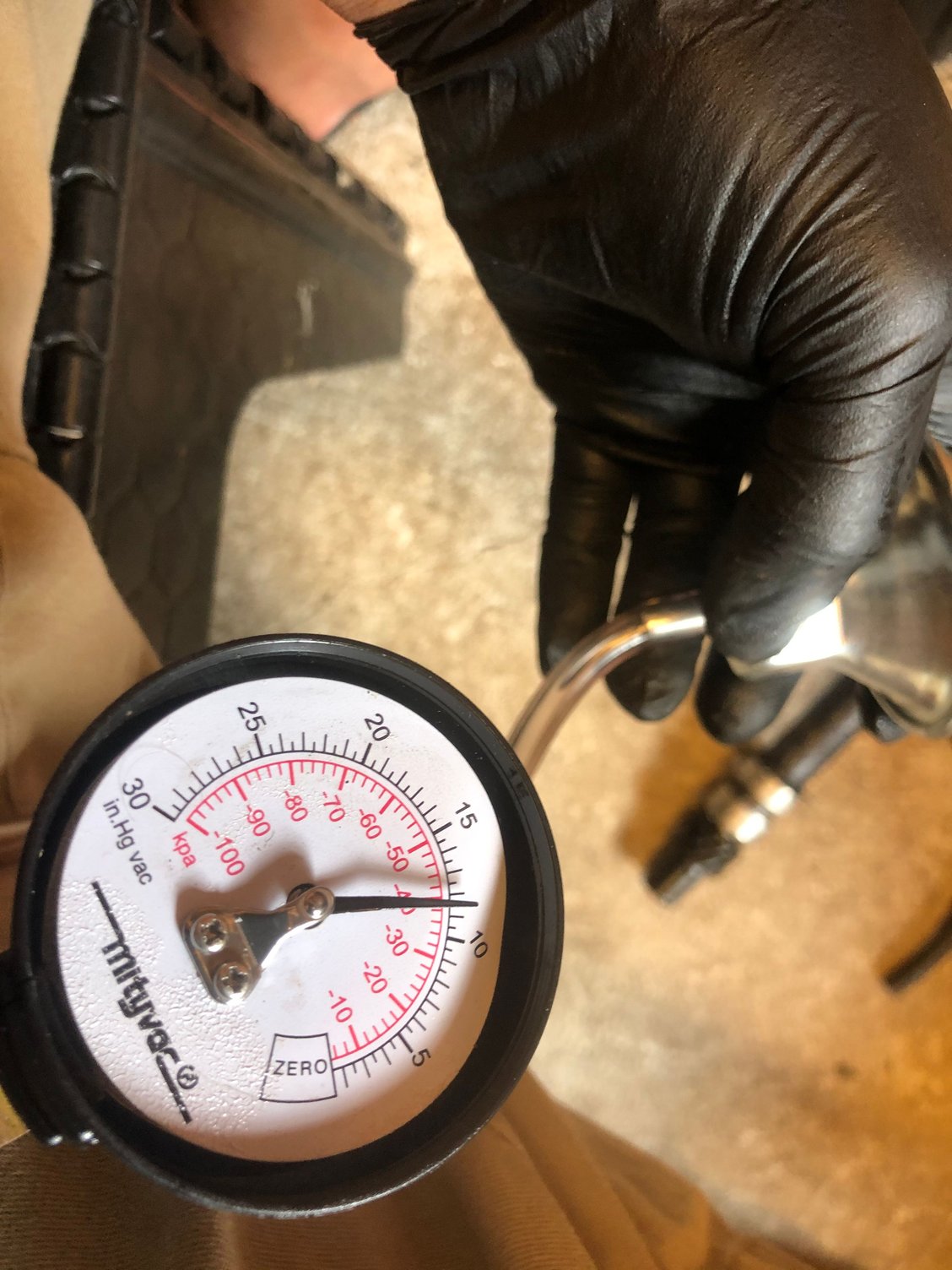

all cans Napa Chinese and oe stop at the same point in vac gun. I say stop because I stop pumping when lever arm stops advancing forward. See pic a bit less than 15 (13-14) hg. If I pump all the way Kon stop I stop at 27hg.
my hg on my manifold t is 13-14 and bounces around like mad. Vac leak or is it normal. Bounces between 11-13
Vac manifold
All the way to see where it stop car off AND on.
Napa can on new dizzy I stop pumping when lever stops pulling forward
Chinese can seems adjustable but no hex inside that I can see
Oe can
it is adjustable. Just tightened it. The lever doesn’t pull down all the way now. So it stops the advance. The pressure on the gun is about the same though. Doesn’t seem to matter as the bar stops earlier. I just answered my own question. Headed to parts store to pickup my accel I had ordered earlier in the week so China can have theirs back.
