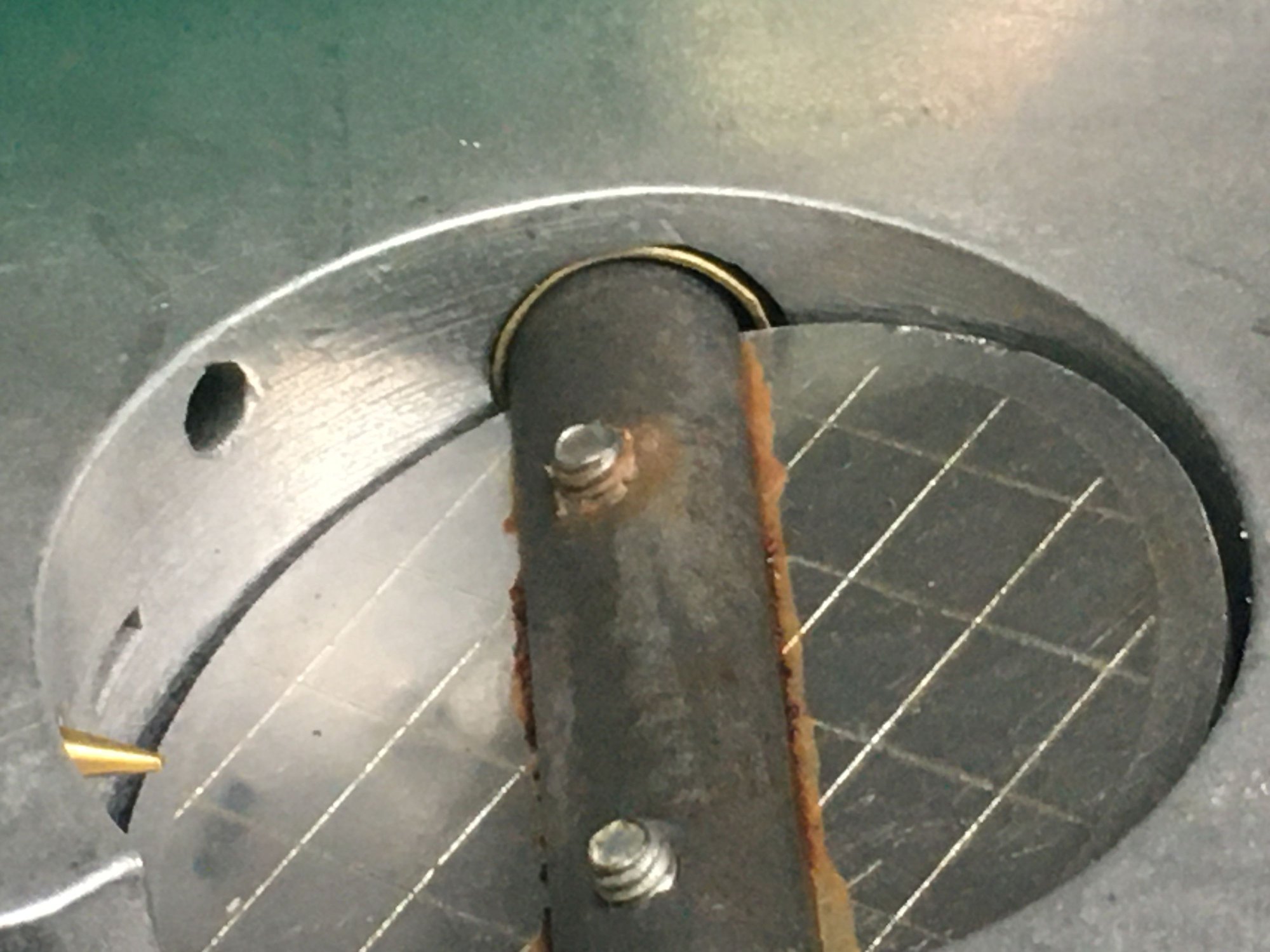

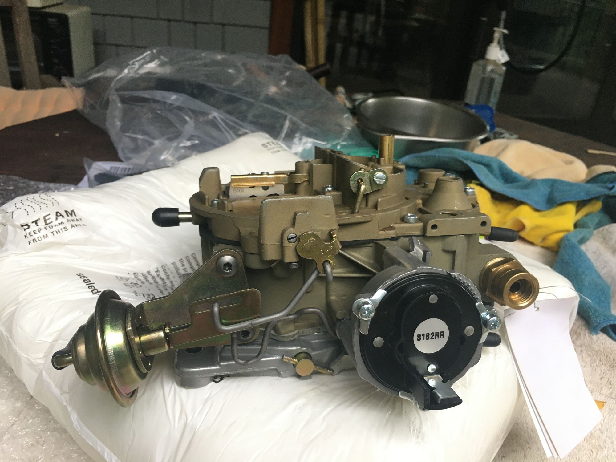

This carb was taken apart enough to do the usual adjustments. A great exercise in diagnosing problems, and this Qjet is already on its way back to Summit. Bad carb, good customer service; in stock parts always get here in two days and include a return shipping label.

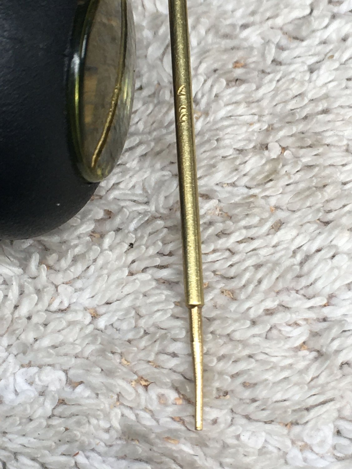

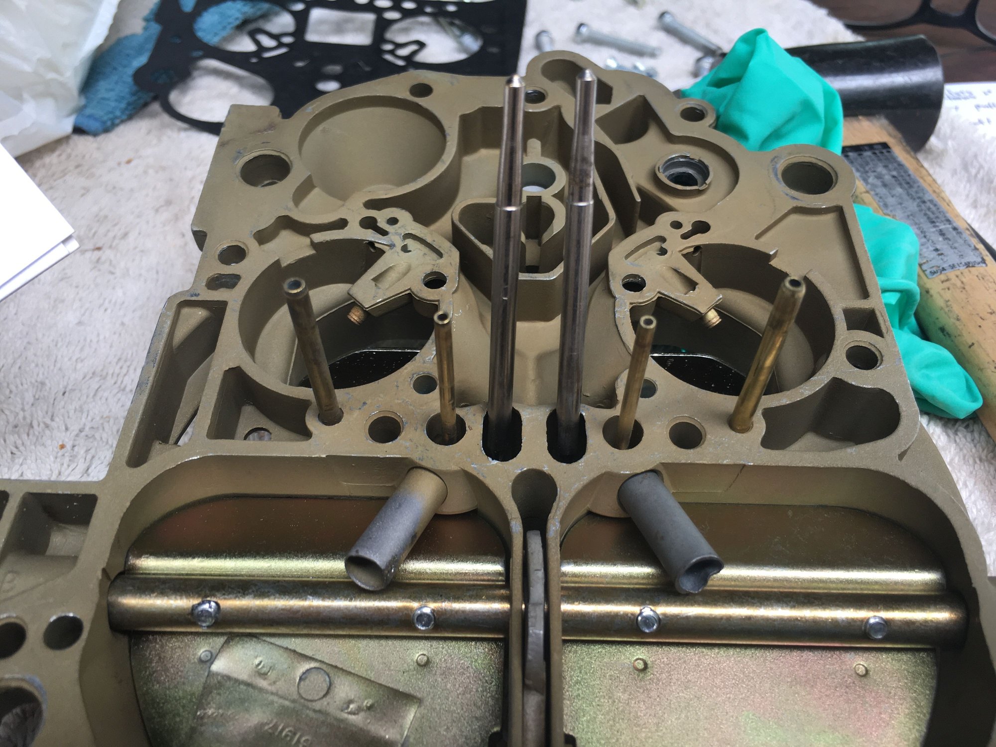

Overall this carb was not completely cleaned out, and not assembled using any bench settings. Secondary choke pull-off only and it has to move over 1/2 way before it does anything. Primaries open 5* shy of all the way and by that time secondaries are 5* past vertical. Accel pump is very sticky. Float level set to 0.8, with float pin clip thru one of the holes in the float arm. Jets are the same size .076, but one of them has a short passage due to hollow on the bottom. Primary rods (42) with a little curve in the tip. Secondary rods DD (0.103” tip, taper right to the tip).
The rust oozing out from around the throttle shaft and their amount of play, even with bushings, were the most worrisome.

1975-1979 AT and electric choke

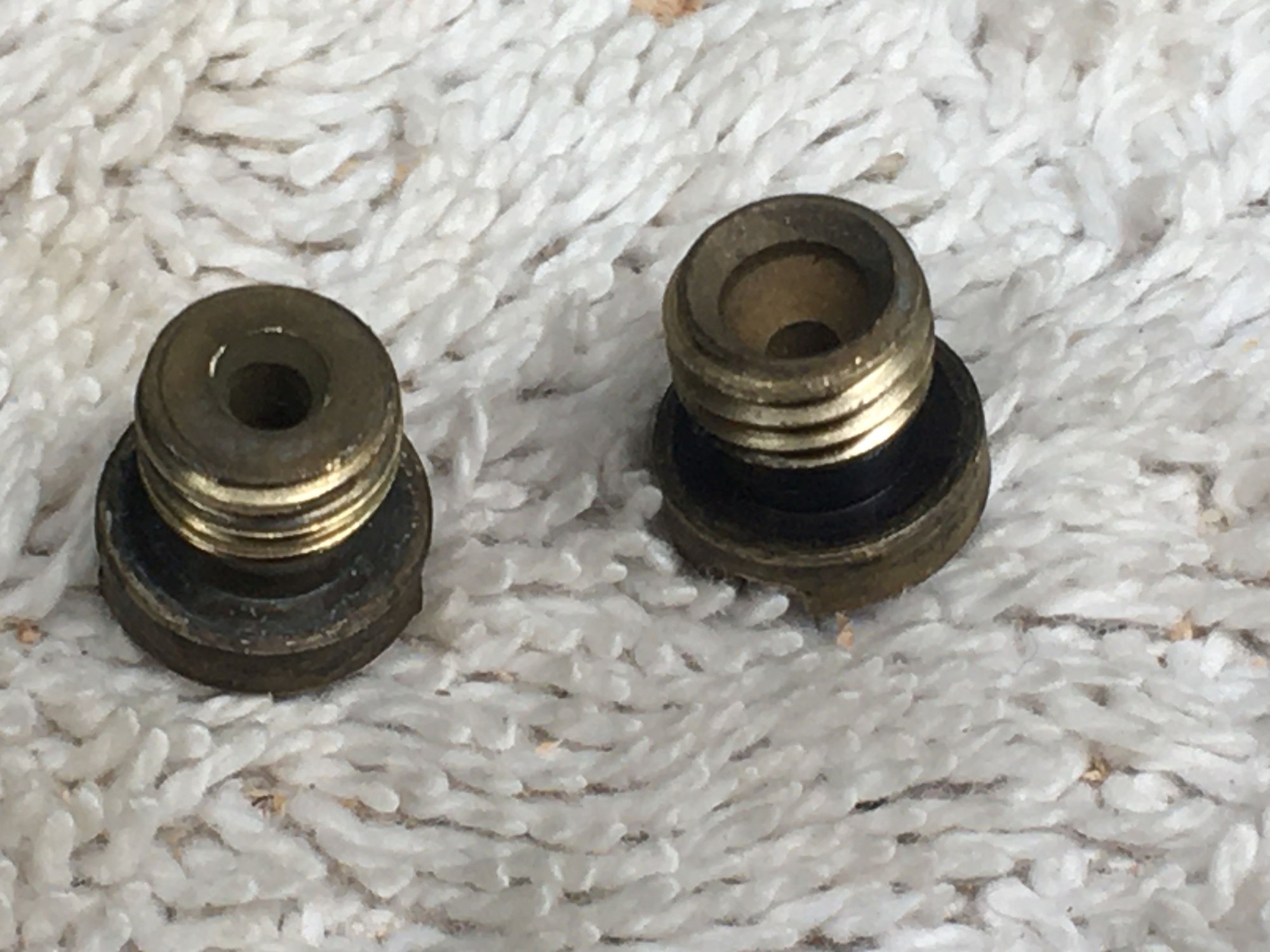

Not what the little holes are for! Someone didn’t read up on COMMON assembly errors.
A little curve in the tip
Any comments on this difference?

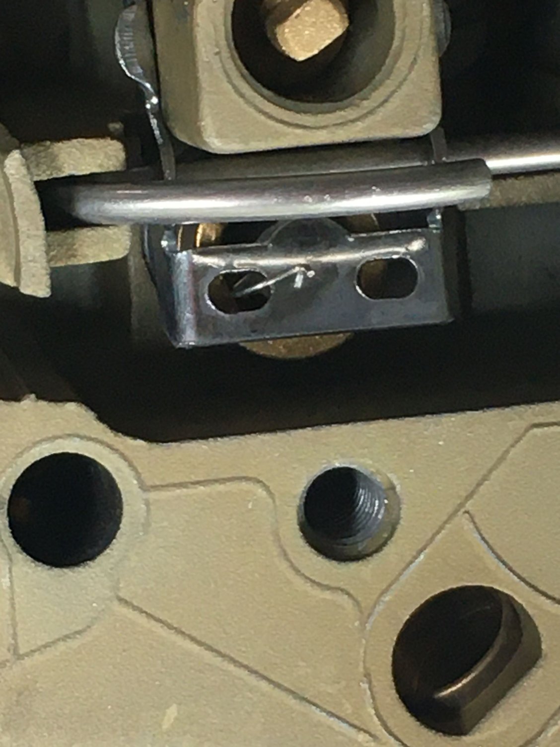

Didn’t check for reamed-out secondary jets to go with these really fat rods. Squished in tip on fuel outlet. What is the flap spot-welded to the air valve?

Thanks for the excellent photos and inspection. Carb looks about like what I would anticipate, and it's pretty bad. Additionally, that carb is a truck-specific carb - not a passenger car application. Another real hack job commercially built carb..!

How about the power piston? every rebuilt Q-jet i have come across has the pin at the bottom of the power piston snipped off.
Old Aug 25, 2021 | 11:44 PM
lars's Avatar
lars
Joined: Aug 1999
Posts: 14,379
Likes: 6,390
The carb shown is an M4M carb - it does not use the power piston with the pin.
