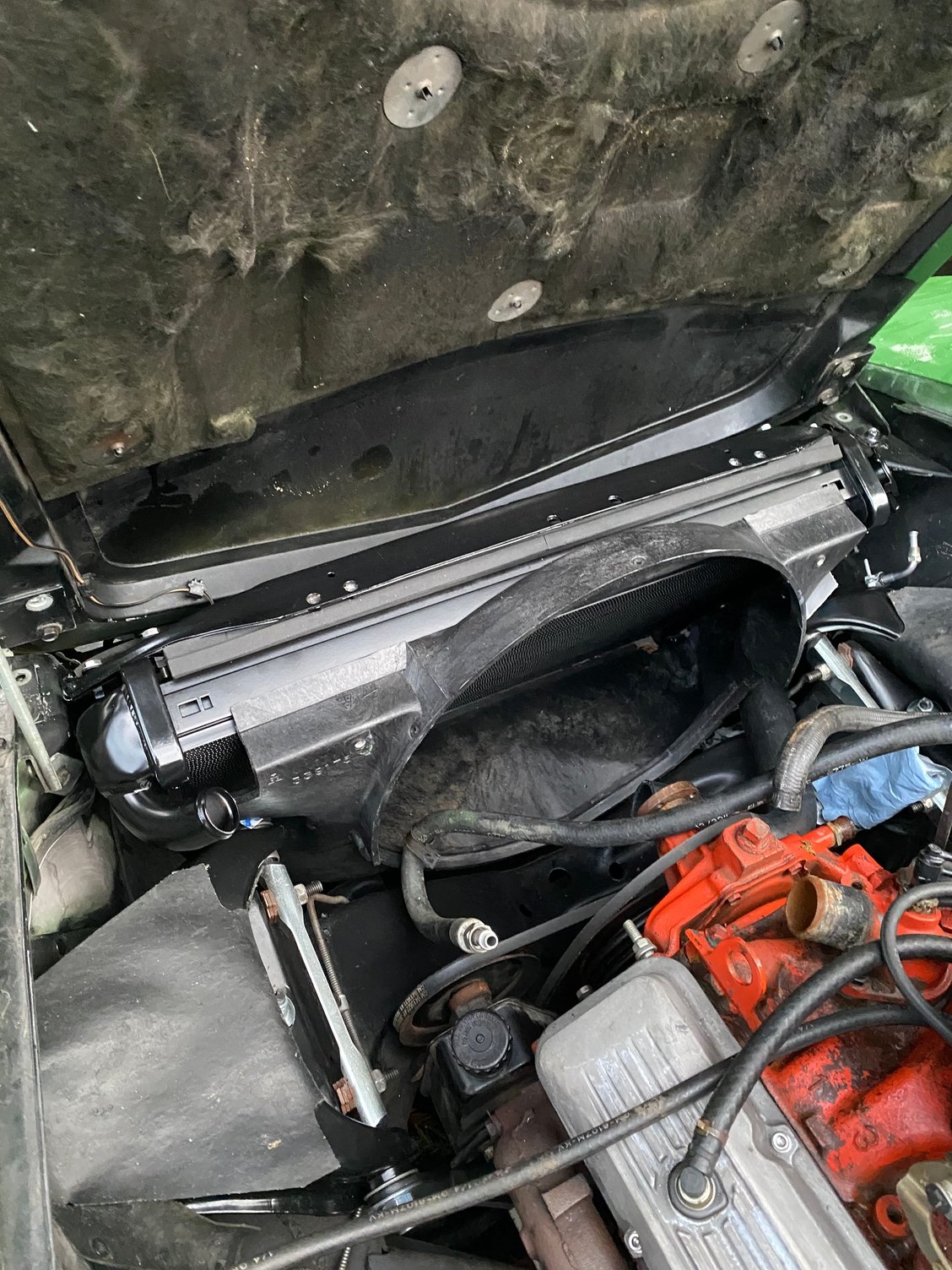

Cold Case was a true direct fit for my 74 L-48 with A/C. Stock clutch fan with 7 blades. Appears to be very good quality and had me running between 190-200 with A/C on in the Phoenix summer. If you'll sleep better at night with Dewitts, go that route .
You do not need to remove the hood.

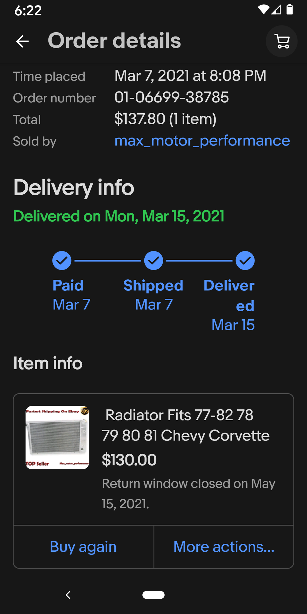

I purchased this off ebay. The quality and fit and finish was excellent. I couldn't have asked for anything better. The dimensions were near identical to the original rad. There for fit perfectly in the car. Between that rad and a 160 degrees stat it does an excellent job keeping the engine cool.
​​​​​If you feel u need to spend twice as much for a rad..... more power to ya
Best of luck

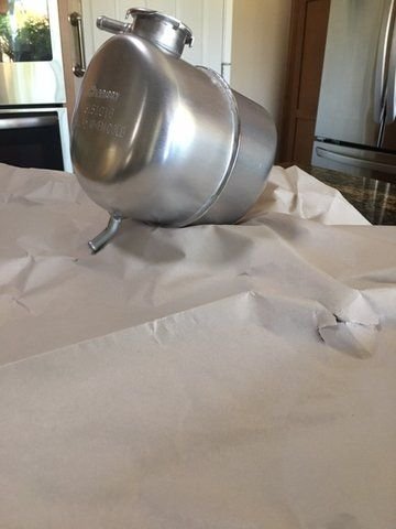

I purchased my radiator and dual fan set up from DeWitt's and couldn't be happier.
I was looking to replace the plastic overflow reservoir for something nicer and worked with DeWitts.
We designed an aluminum overflow reservoir that looks just like their 68-72 pressurized expansion tanks.
These overflow reservoirs are now available from DeWitts for 61-82 Corvettes and are non-pressurized so they work just like our ugly plastic ones.
The mounting plate and straps are the same as the 68-72 tanks are are available through most vendors.
Here is the link to the thread I posted regarding the reservoir: https://www.corvetteforum.com/forums...hlight=Dewitts
Special Thank You To Dewitt's, New Custom Part
