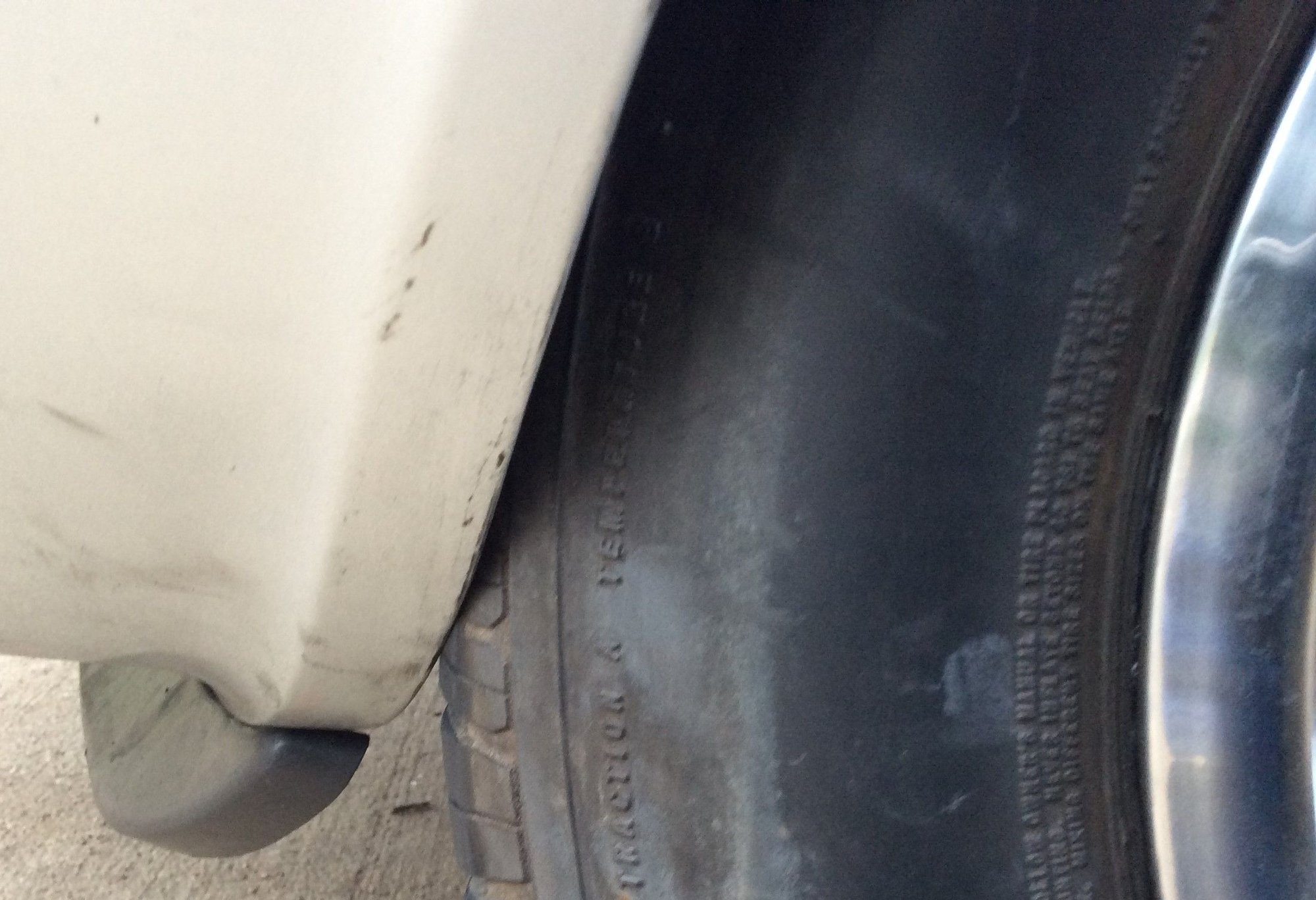

Hi all, I am running P255 60 R15 tires on my 76. I just recently finished changing ball joints, bushings, shocks and tie rods in my front end. I had it aligned yesterday. Problem is that the driver side tire is now rubbing against the front fender lip when I turn the steering all the way right. The passenger side tire is not rubbing in anyway. I've attached pictures of both. The same tires have been on the car for years and there was no problem in the past. I took it back to the alignment shop and they don't have an answer. I'm attaching pictures of both. The 1st picture is the passenger side. The second is the driver side. I'm wanting to ask if there is any adjustment that I can make to fix this problem? Thanks.

Post up your alignment specs they gave you?
pics of how it sits in wheelwell?

Speculating here but 255’s on the front is pretty big for a pre-‘78 Vette. (I think it was ‘78 when the factory opened up the clearances to run 255’s — someone can correct me.)
You probably got away with it before by someone dialing in more caster, which brings the tire rearward. Now that you are back to factory alignment specs, you have interference. As for why one side is worse than the other, either the car has been repaired at some point or that’s just how fit & finish was.

78 and later, the factory trimmed the car to make the 255/60R15 tires fit. They did not trim where the interference occurs in the OP's picture.
As stated, please post the alignment specs. In general, you want as much caster as possible, and getting that can be a big deal in these cars. But moving the upper ball joint aft (adding caster) will move the wheel back and give you the clearance you need.

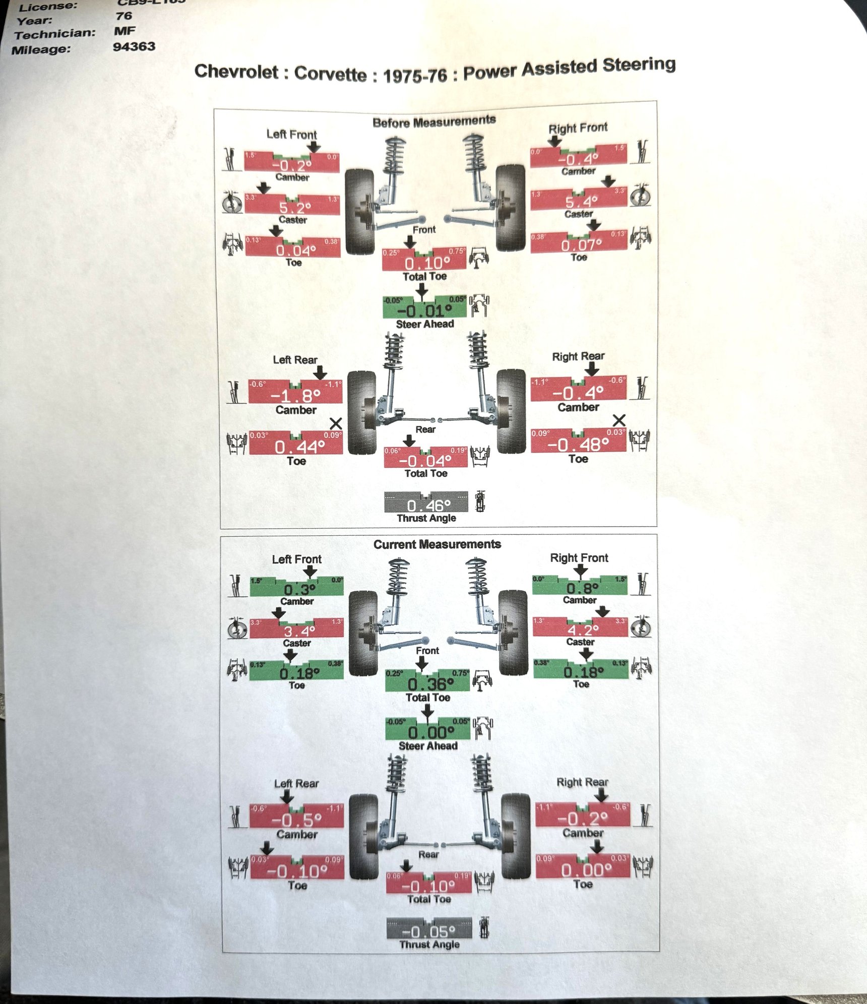

Hi guys, I am just getting back to trying to deal with the rubbing on the driver side of my car after an alignments. To recap, I am running P255 60 R15 tires on my 76 in the front and back. I been running this size for quite a while. I changed ball joints, bushings, shocks and tie rods in my front end.
Problem is that the driver side tire is now rubbing against the front fender lip when I turn the steering all the way right after alignments. It did not rub before. The passenger side tire is not rubbing in anyway. I understand from the forum that I need to add caster to fix this problem. I am attaching a copy of the latest alignment report. Can anyone let me know how much caster, which spacers and how I need to fix the rubbing problem? I'm not an alignment "guy" at all but I really do not want to waste time bringing it to another alignment shop if I can make the adjustment(s) myself. Thanks.

I've replaced all these parts more than once. I also run 255/60-15's, and have for over 35 years.
What I can tell you from that alignment sheet posted above. Your before measurements look way better than the after measurements!
and you paid for that???
Without looking at the shims in your upper A arms it's a bit hard to tell you what to change.
And I don't know how you got 5 degrees of castor with your stock A arms. (Before reading).
Some pics of your upper A arms are necessary here.

Can we get some more pictures? Maybe with a wheel off, and also of the upper control arm shims?
If the lowered your caster (and moved the upper ball joint forward, slightly), your rub should be even worse. As @4-vettes said, you had a surprising amount of caster before, which is good, if true. Your wheel should be centered, or even aft in the wheel well.

Why do you have less caster than before? You want as much caster as you can get, I'm willing to bet that is the issue, but there may be more. GL and take it back. .

The caster both before and after is red because it's too much caster not too little.
Did they have a problem trying to set caster to + 2.75 which is the maximum number.
Do you have bent control arms?
