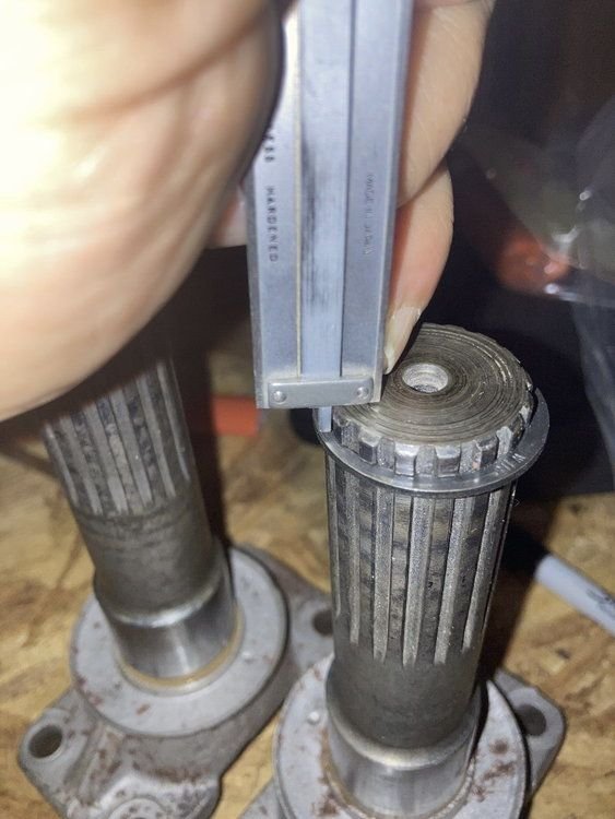

Recently got my new to me 70LT1 up and running after 1 1/2 year refurbishment. Noticed excessive growling noise from rear end, typical bad bearing indication. Decided to overhaul differential and found excessive wear of side yoke ends. Metal deposited throughout, embedded in bearing races.
I can purchase new side yokes or repaired side yokes about same price, so what would be the advantage of one over the other? I read that one poster here said new ones are junk, and rebuilt ones can be junk, is this the consensus?

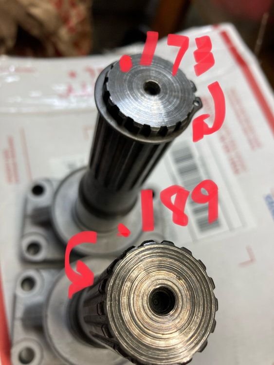

^ One is .180, the other is .174, both are soft as tested with a file.
Just read your whole thread, good info there. Interesting that you were able to get your .173 to fit nice with posi tuning. I thought that I read somewhere that you bought new side yokes but returned them?
returned a used ebay set..second one was the ticket..then hardened. Yours may just need hardening. Maybe fit them and see? Beyond the hardening i heard dimensions not so consistent new either.
be great to know what you need and size the buttons custom? No cluewhat grinding hardened butons would do..

If I find a shop to make these buttons, do I shoot for .185" from clip to end? Or longer and machine to fit?
