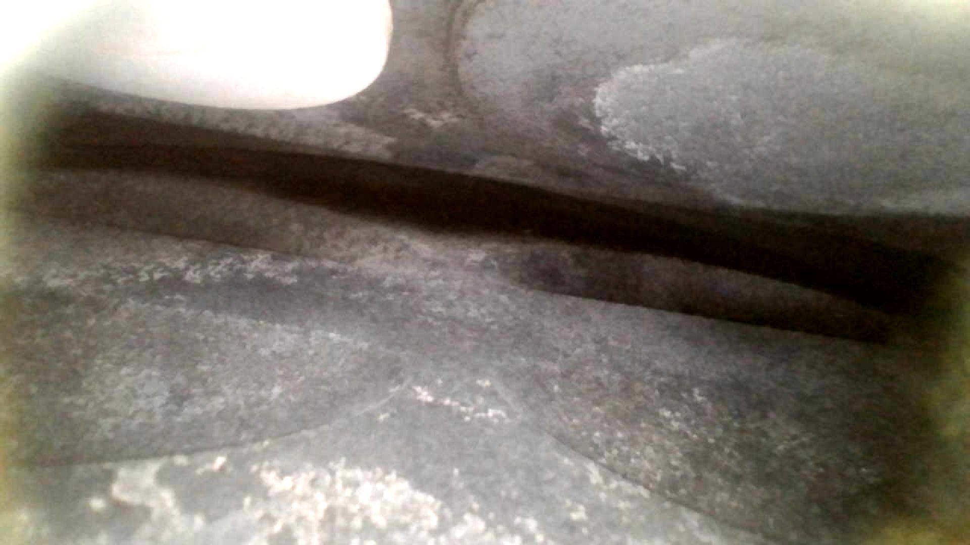

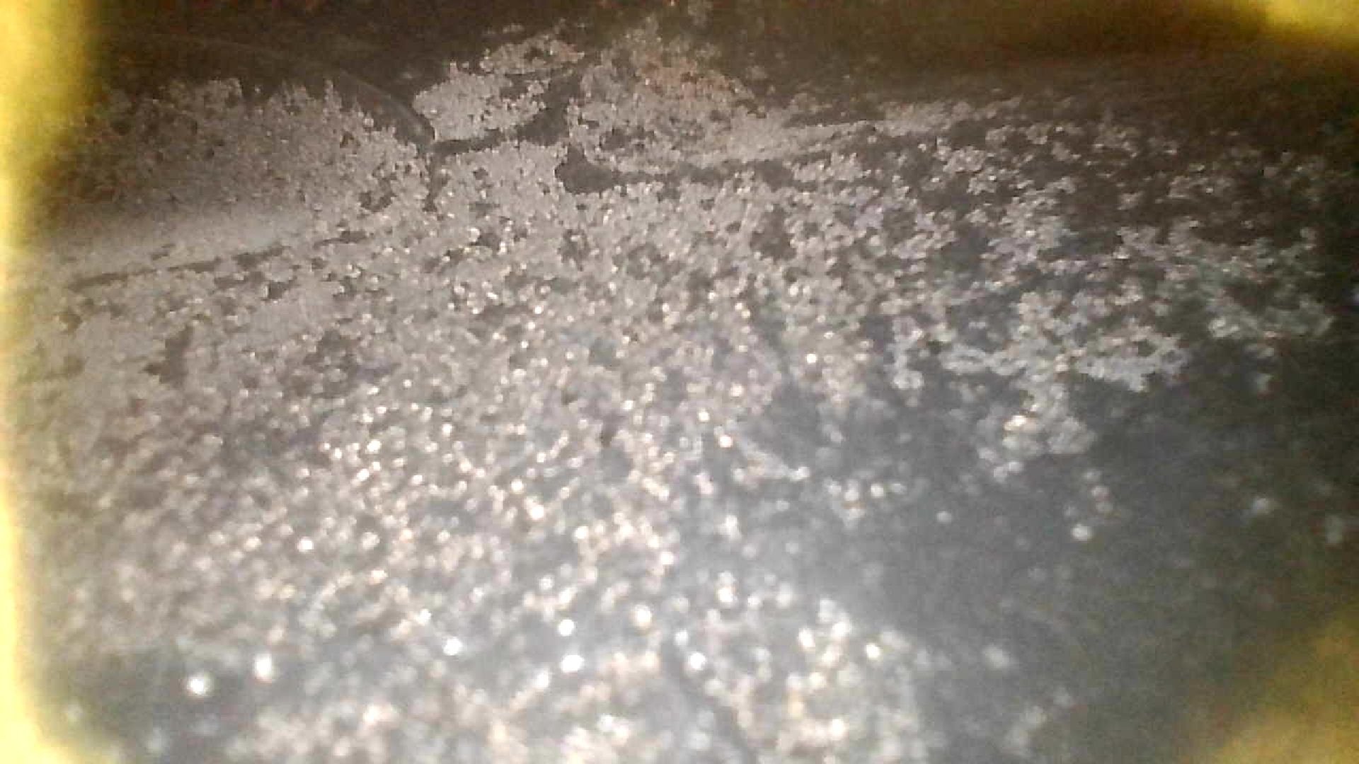

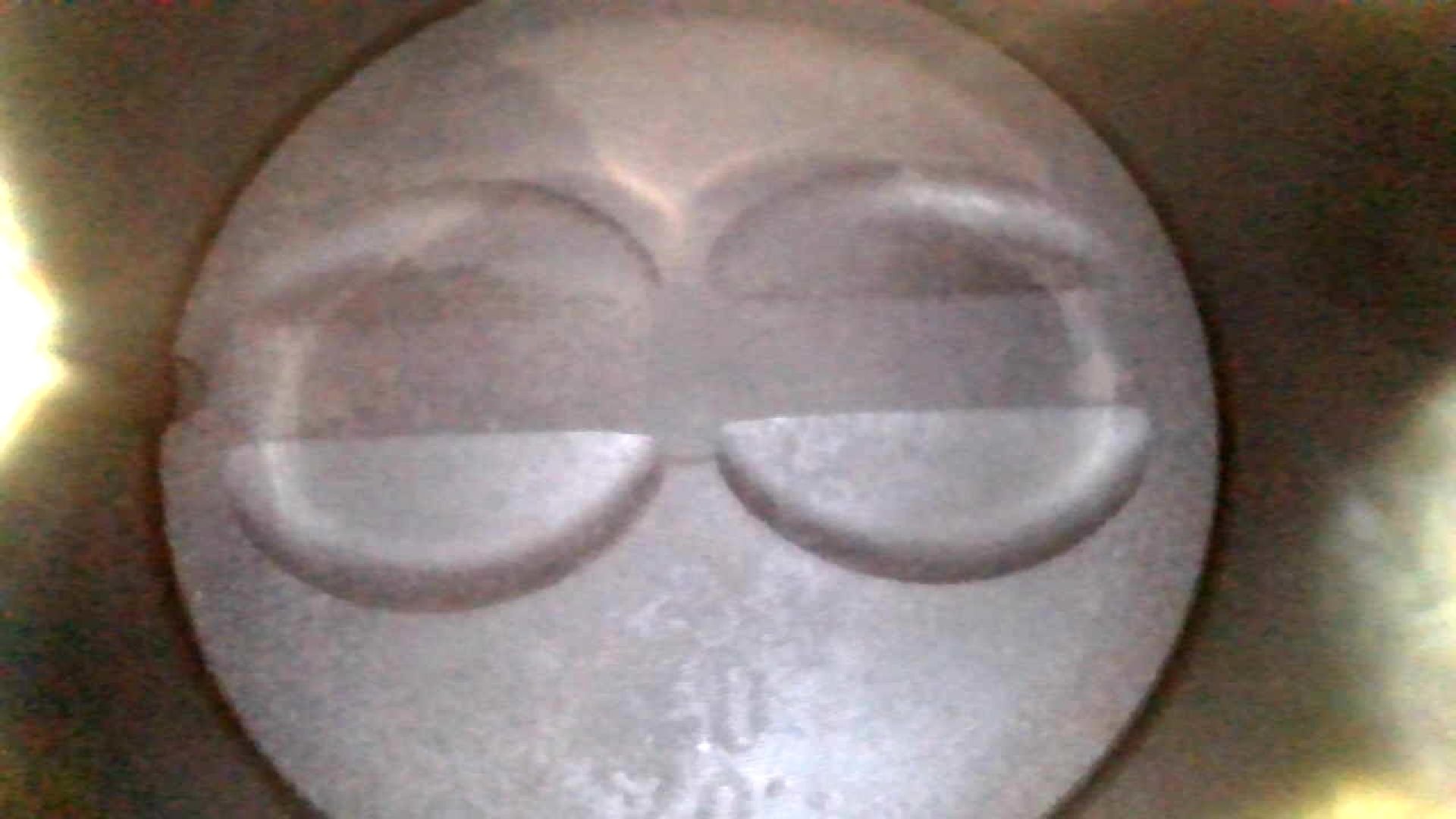

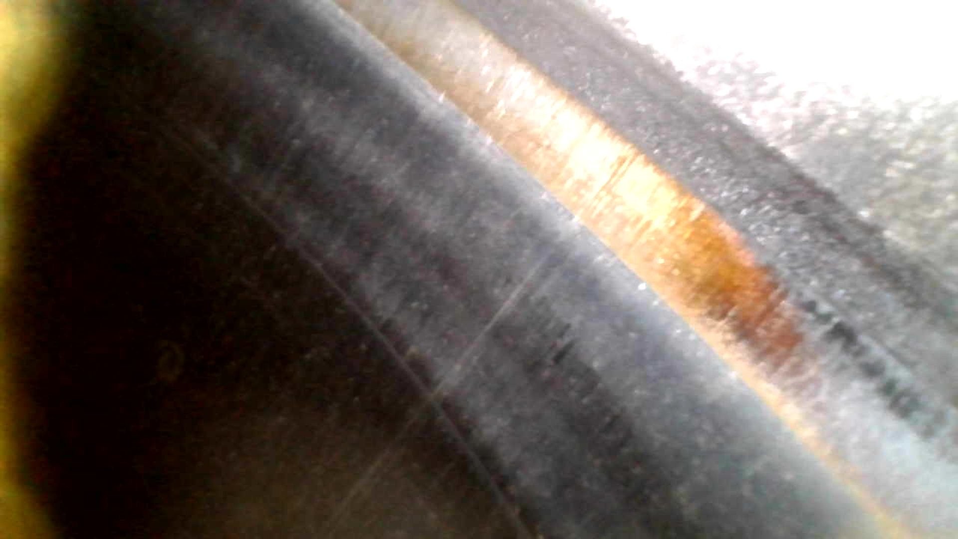

Here are some pics of various combustion chambers I took with the bore scope through sparkplug hole.

Those look to be 4 relief flat tops unless im missing something.. its kinda hard to tell. in any case a 4 bolt truck block is better than an l48.. I have a 76 truck block in mine that I built with flat tops and 64cc heads for 10.2:1 and around 375-400hp.

So now we see that the Block has standard Flat Top Pistons its just about as standard of a SBC as it can be and all the standard Hot-Rodding ways of doing things apply.

Well you got lucky!
Based on that pic, you do NOT have these very common late 70s style L48 pistons, with the huge D-shaped dish They only make 7.8 CR with the large chamber 75cc heads you do have. These are hard to get the compression up on even with better heads. You dodged a bullet by not having these.
Based on the 4 valve eyebrows, it appears you have have some flat-tops, something like these.
These 4 eyebrow pistons are also extremely common, and already make 9.0 CR even with the large chamber heads. With a Comp Cam 268H hydraulic cam (not the extreme one) you will have a great running engine, for cheap.

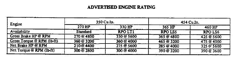

Your current engine likely has the ubiquitous 929 SBC cam, and would be like a 71 vette L48. So depending on carb, intake and exhaust you may have 270 HP now (gross) or 210HP net. That cam was designed for this engine and could add 40-50 HP. Say 310HP. (250 net)
GM data for 1971
If you wanted to go a step further, and add new aluminum cylinder heads, you could easily bump the CR up to 10.5CR, add a little bigger cam, and have a VERY strong running engine. Another 40 HP. Say 350 HP (300 net). It could easily run as hard as an LT-1 then.

Here is a better picture showing the whole top of the piston.
I dont know what pistons, combustion chambers and valves are supposed to look like, but do these appear to be in relatively decent condition? Nobody made any comments from the first batch I uploaded, so I'm guessing they are pretty ordinary.

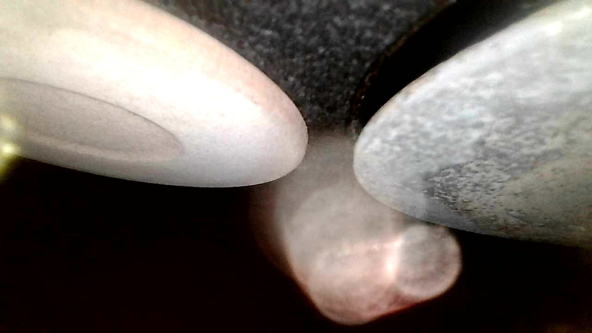

Also, can someone explain to me why the one valve appears white and the other gray?
