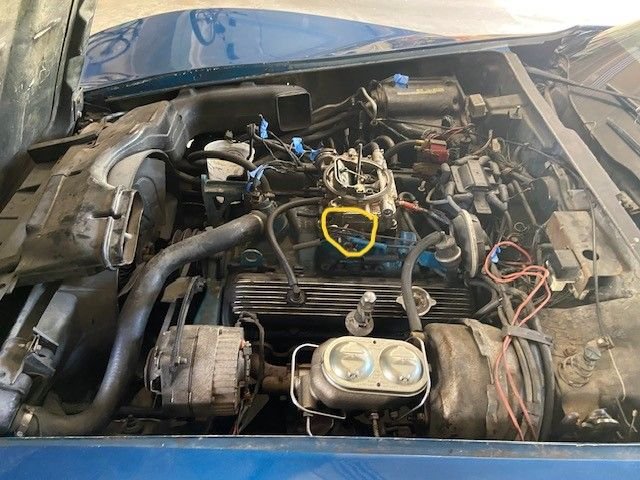

Hello,
I just bought this car and I am in the process of "reconnecting" some things. That said, is the part that is circled and attached to an actuator designed to ease the throttle when it closes? If so, is there any particular position I sh
ould put it in or just attach it an let it do it's thing?

With that incorrect Carter AFB carb (aka, EDL "Performer") you're not going to be able to hook everything up - that carb doesn't have the correct ports and linkages required to connect everything on your '81.
Correct, your car came with CCC..(Computer Command Control).....a primitive computer controlled the mixture on the original Q-Jet that was on your car. It also controlled the timing/distributor. These items have been removed from your car and an older style mechanical distributor and an Edelbrock carb have been installed......The distributor is fine but you eventually will have to get that Edelbrock carb off of that intake because the adapter that is used to do it is terrible......you might get it to run half well but you will never tune be able to tune that carb properly due to that spacer.

Jebby -
I'm not so sure the CCC distributor has been changed out... I don't see a vacuum advance on it... if there is no vacuum advance and the computer has been disabled, that's a problem... that would have the distributor locked out on all timing advance functions, which is a really bad idea...
Jebby -
Lars
Yeah, can't really see from the photo......maybe you are right......if so, there is one advance curve on this unit........none.......as the CCC distributor will not work with the carb disabled......two huge issues here.

Originally Posted by MPBS
Thanks...What carb do you recommend?
A Corvette spec Q-Jet from 76-80 would be great......but do not buy a Commercially Rebuilt unit or from the parts outlets.......they are trash. E-Mail Lars and ask for his papers on how to locate a good Q-Jet core and have him go through it for you.....and if you do not have a vacuum advance cannister on that distributor then you need a new one. One for a 75-80 Corvette or Chevy V8 powered car.....there are hundred of different places to buy them at....but this distributor is key to making it run right......along with the correct carb.

All correct and accurate statements. But that assumes you are wanting to bypass the CCC controls that came stock on your car. If you want to bring your car back to its correct, factory configuration, you need to locate all the correct 1981-unique components to make it all work. From the looks of your photo, you have a real hack-job going on there with lots of incorrect and missing stuff. Bubba has been hard at work. If your goal is just to make it run nicely, you need to locate a used, unmolested, rebuildable 1978-1980 Chevy passenger car Q-Jet along with an HEI distributor with vacuum advance (assuming your existing distributor does not have the vacuum advance on it). The '78-80 Q-Jet carbs will allow you to hook up your EVAP system should you desire to do so. The '76-77 Q-Jets do not have EVAP provision on the float bowl, but they can be made to run well if you do not want to hook up everything in your engine compartment. All of the '76-80 Q-Jets can be converted to electric choke, which came standard on your car - you should have the electrical wire in your engine compartment to hook it up, although I'll bet Bubba cut the factory connector off of it...

OP has a similar thread started, with a view of the other side of the engine:
https://www.corvetteforum.com/forums...cal-81-c3.html
An 81 should have a wire for the electric choke. No sign of a vacuum advance on the distributor, though.
OP, can you post some better photos? Is the check-engine-light (CEL) on on your dash? Is the ECM still mounted in front of the battery?

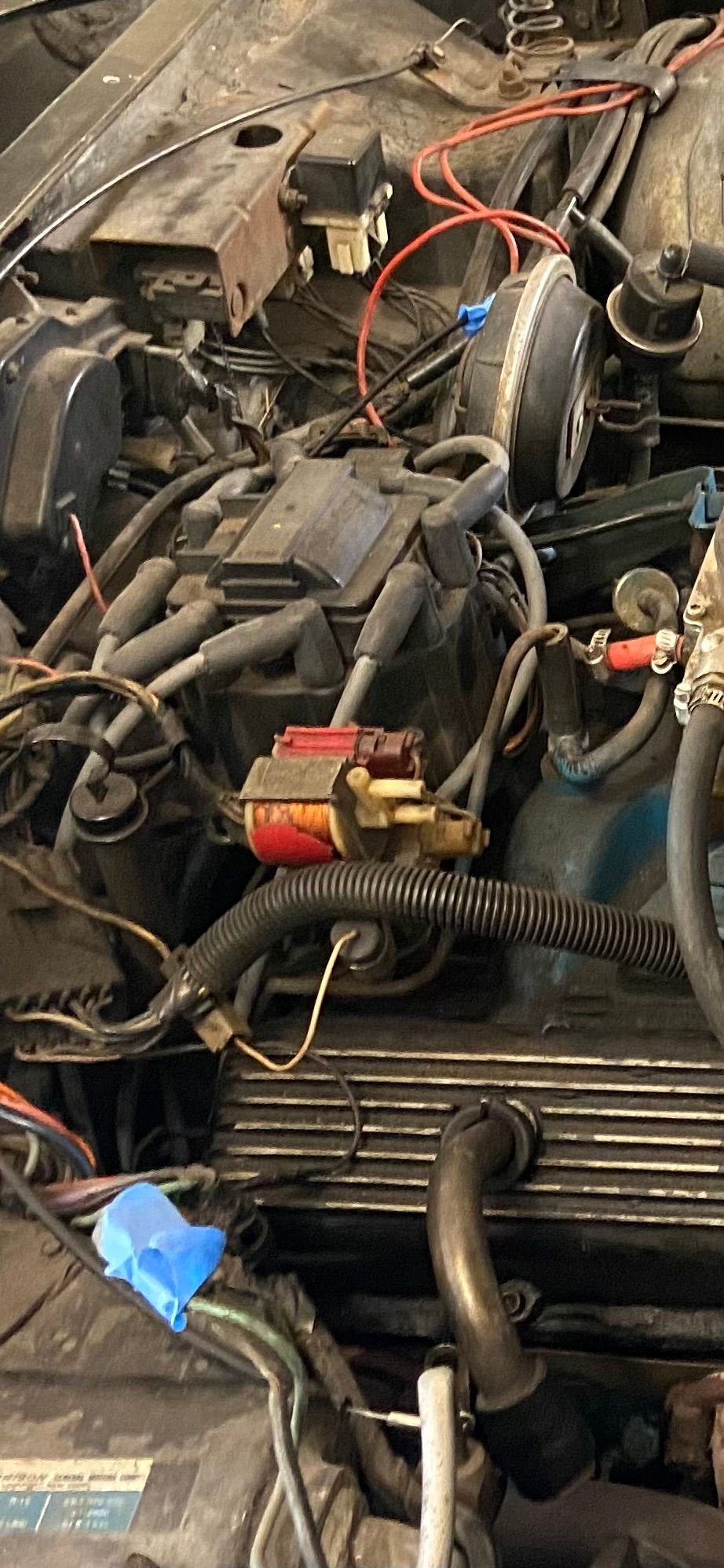

Thanks Bikespace. One question, do you know what this red coil was quit? Just curious. It does have vacuum ports so I am wondering if it was part of the emission system.
Old Oct 13, 2023 | 05:22 PM
calwldlife's Avatar
calwldlife
Posts: 53,648
Likes: 878
From: Southern Cal Ca
St. Jude Donor '22
egr control solenoid
