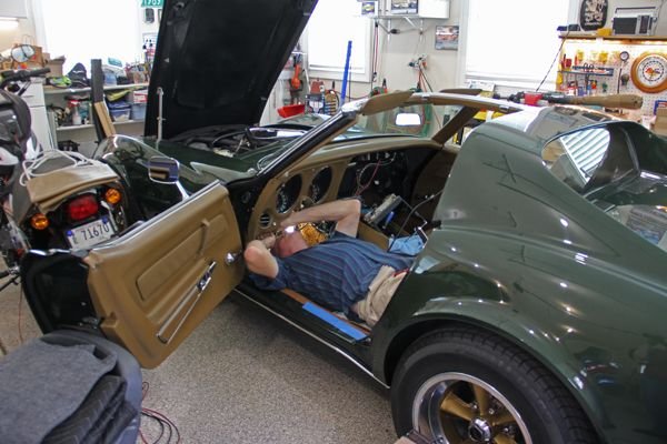

Here is basically how you change a brake light switch. Always a lot of fun!
Old Apr 20, 2025 | 05:54 PM
forman's Avatar
forman
Joined: Mar 2010
Posts: 2,270
Likes: 375
From: Randolph nj
That’s it … 😂and it works
